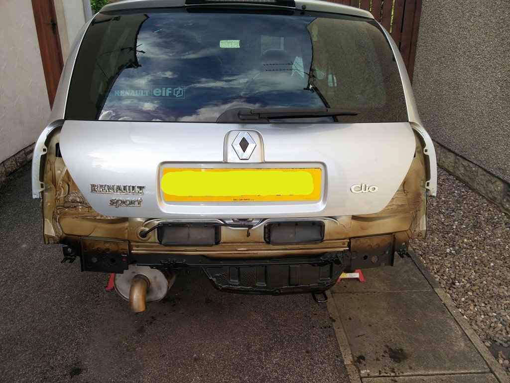

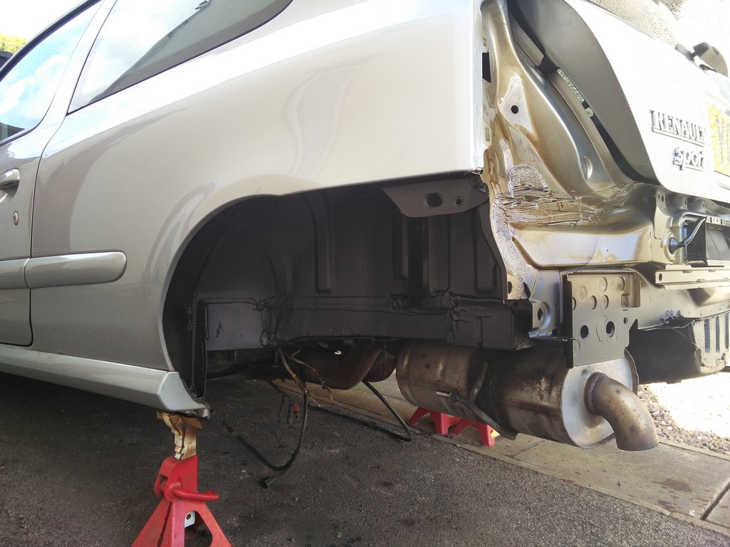

Ok this what Ive done..
Used . Dintrol 2-part for the underbody.. Dinitrol 3125 brown cavity wax 1st coat .. Then over the top with 4941 the Black stuff .. also 3125 in all the sills and rear quaters and the like.. you can see the tide line where I stopped with the 4941 ... the black stuff forms a crust over the brown.. Treat any bad rust with FE-123 Rust Converter first.
A much better and advanced product then good old wax oil..
ACF-50 on all the expossed components.i.e nuts and bolts.. cailpers, struts, brake pipes, everything really . (not the exhaust or any braking surfaces).. gives them a gloss look but does not dry .. stops rust on contact to..
I've powder coated the rear beam and epoxy panted all other stuff.
Hopefully make it last a bit longer ..
