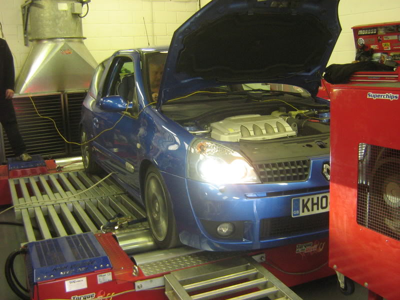

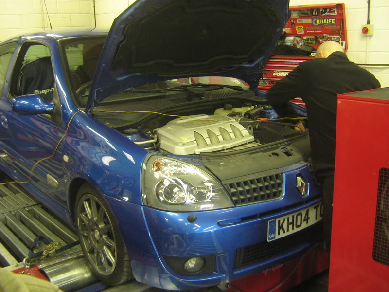

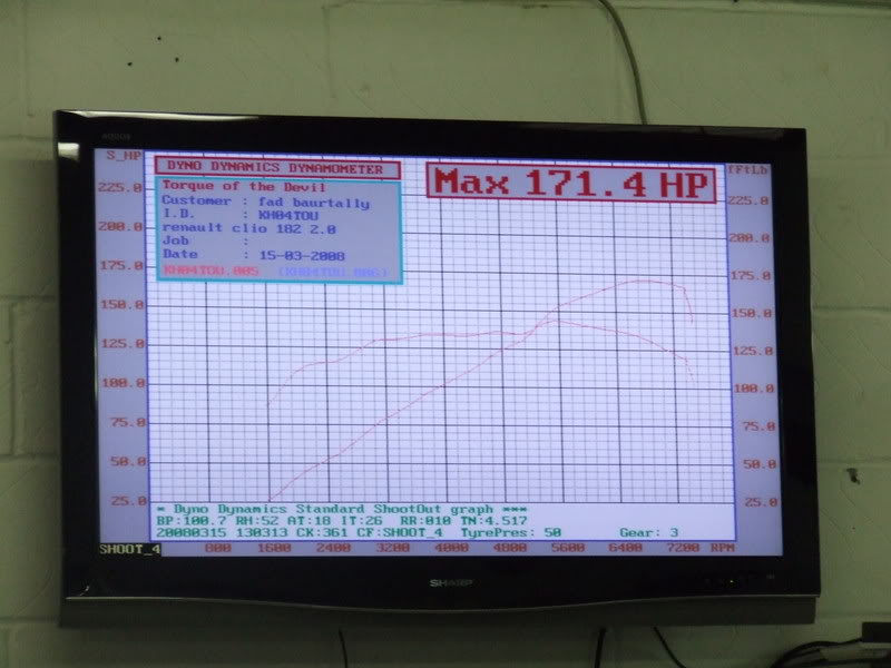

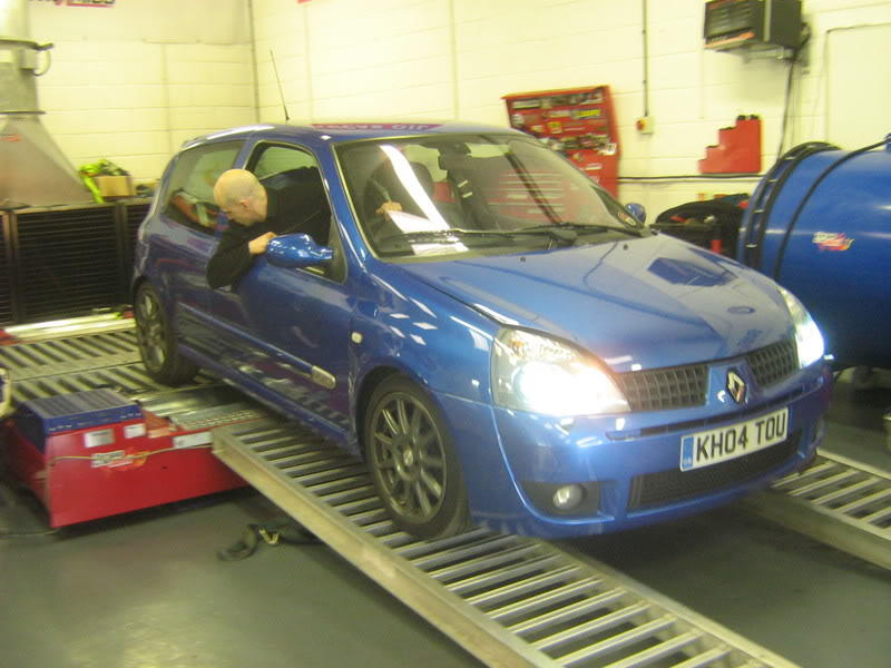

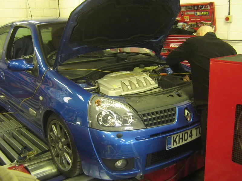

Had my car on the rollers at Torque of the Devil today, very proffessional outfit. Car was run on a Dyo Dynamics rolling road.
After three runs my car (clio 182) made 171.4bhp 147ft/lb torque.
I'm pretty gutted as I was expecting around 178-179 even filled up with Ultimate!
Has anyone else had such experiences of underpowered car? The operator (Chris Todd) mentioned it felt fine just seemed to lack the bhp figure. I will try and get a graph up at some point but overall its just a bit disapointing. It was mentioned it could be something as stupid as a dirty filter or just in need of a service.
Car feels fine on the road though.
i think thats average for the sports mate we had a rolling road day last week i made 158bhp a few made 160ish for the 172 and the 182 made between 174-177
You need to run on 3 different ones and take an average.
Still too many contributing factors and any result should be taken with a pinch of salt.

Sounds about right.
These are all figures from SRR's Dyno Dynamics RR:
Ph2 172: 140.2 (Standard)
Ph2 172: 161.8 (Standard)
Ph2 172: 177.9 (Work by BBPT)
Ph2 172 Cup: 169.1 (Decat, Exhaust, Viper)
Ph2 172 Cup: 177.9 then 177.8 a year later (Remap, Decat, Exhaust, Panel Filter)
Ph2 182: 175 (Remap, Panel Filter)
Ph2 182: 170.8 (Standard)
Ph2 182: 177.2 (Panel Filter)
Ph2 182: 171.5 (Standard)

I wouldn't be too disapointed with that, DynoDynamics rollers give accurate figures, not inflated to make you feel good about the car like some do. Notice how many people come away from a DD rollers with less than they thought?
I always regard RR figures in old and new money, you'll always struggle to make what people were a 3-5 years ago because understanding of how dynos work has improved so the operators can't get away with so much and strive to give accuracy rather than big figures
