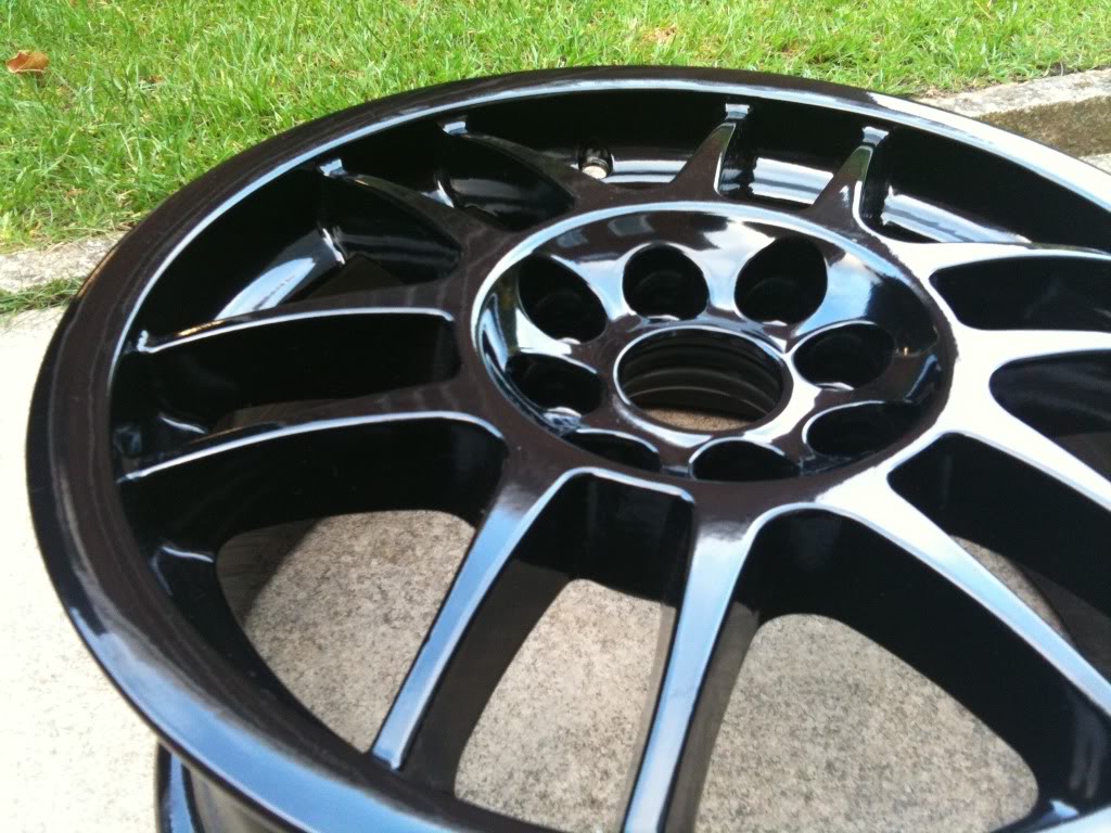

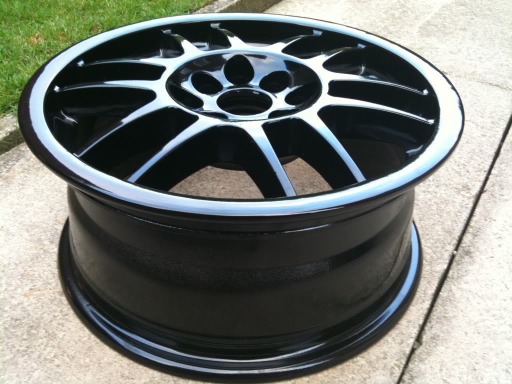

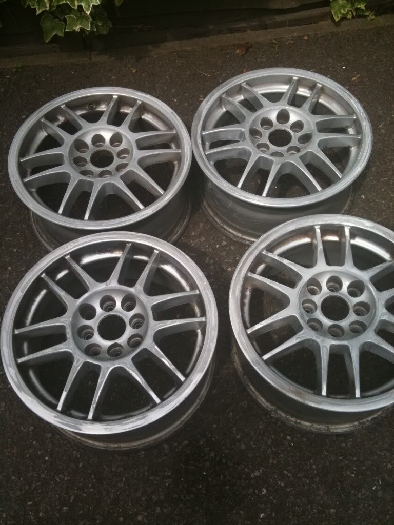

Bought these two sets of wheels this weekend, if I keep it (looking likely) I'm going to have a bit of a change.
Edd
  Ghibli/Boxster/197T
Not sure Tunst, what do you think? The f1's are in the boot, going to drop them off tomorrow so I'd better make my mind up on them. I was thinking black.

Yeah black, stealth ftw! and do the turinis an epic colour, like bright green or get a spiral pattern on them :p
Dont go white :dead:
Edd
  Ghibli/Boxster/197T
No I don't fancy white, maybe play it safe and go anthracite/silver

Picked these up yesturday, fully refurbed and ready for some rubber. Going away for a week so won't be going on just yet.

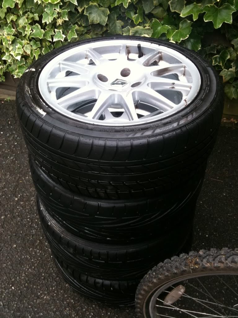

Well I've got these, my red ones and some turinis that will be going for a refurb in the next couple of weeks.
Think i've had 17 sets of wheels in the last two years though, think I've got a bit of a problem.
