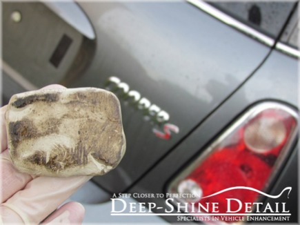

Just wanted to add if you're doing any details like this in the future invest in some tardis.
Claying is more for tree sap/fallout etc more than tar. Obviously when removing the tar it can sit on the surface of the clay and then be moved back and forth on the paint, never a good thing. Just a little tip for the future. :)

Always wondered how good claying was for the paint.. Specially when a car has never been done before and has about a kilo of tar splattered along bottom third...

I did have a brief go at claying it but didnt want to press too hard especially after looking at the crap the clay bar had picked up, but then half the stuff wouldnt come off without applying a decent bit of pressure.

This is from a pro detailer...
That's not the correct way to decontaminate a car. Just shows even guys doing it for a living aren't perfect.
