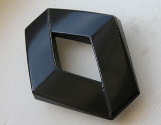

Heres a picture of one:
I will spray them if you like.

I been playing with my front diamond recently. First I did a carbon fibre tape job... didn't like it, and now just finished spraying one in Ford Graphite. Now I am not too keen on that either!
I want one that matches the grille (matt black?) :D

Greets, I don't think anyone sells pre-coloured badges. People have them sprayed. There are people on here who will do it. (See above)
I sprayed my diamonds too - easy enough done and satisfying when you get them finished perfect & fitted :)
