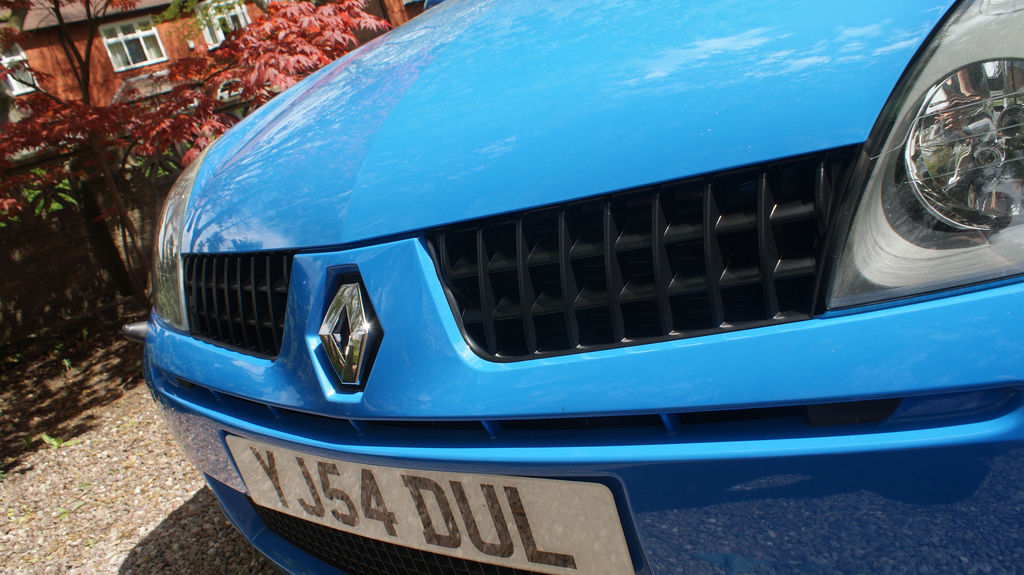

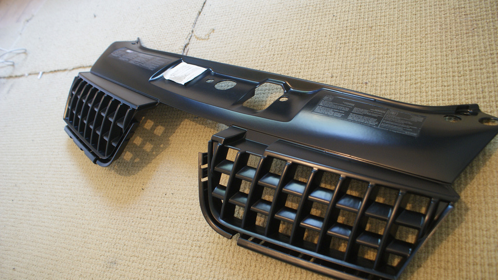

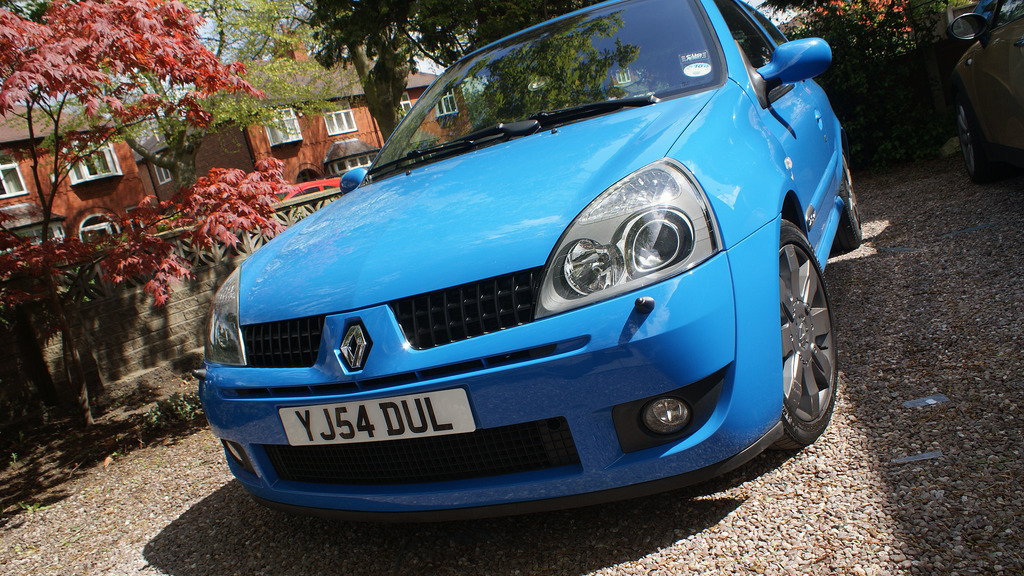

I sprayed mine satin black with some Plastikote spray paint.
Came up well:
DSC09966 by Eddie the Kid, on Flickr
DSC09981 by Eddie the Kid, on Flickr
DSC09978 by Eddie the Kid, on Flickr
Didn't bother.
G101 (all purpose cleaner) to make sure it was 100% clean.
Dried it.
Sprayed it, 2 coats, then 2 coats of FK1000p (just a sealant to allow the dirt to run off it better)

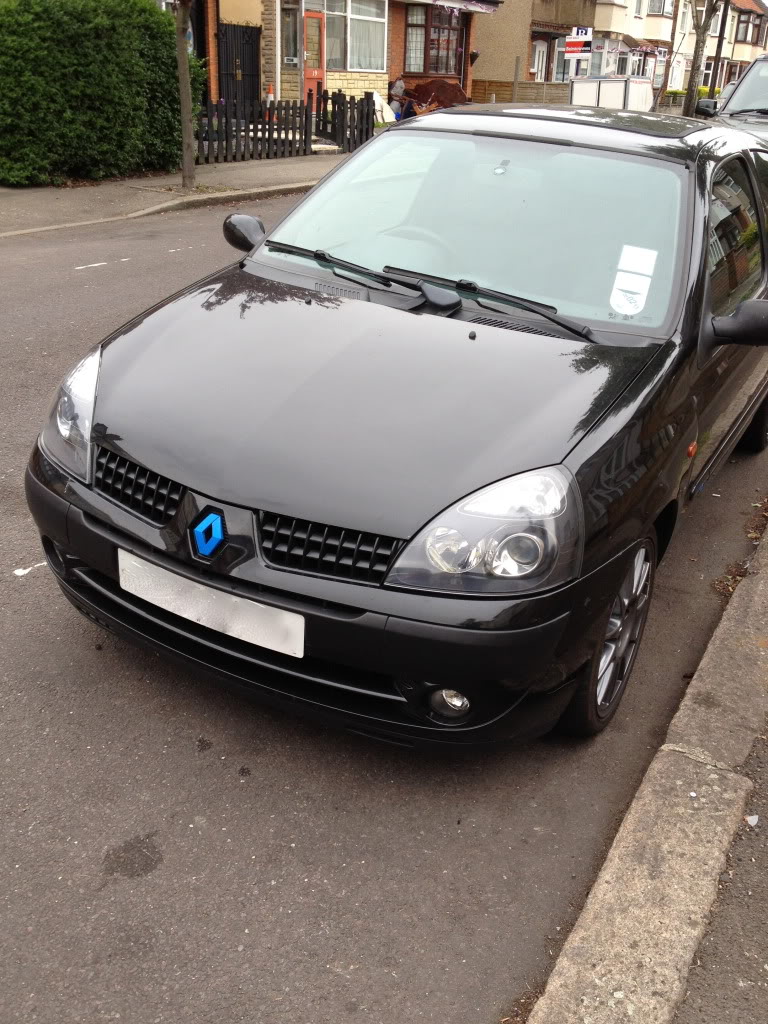

just done my grill with the plasti kote stuff! has come up very well.
Just about to go out and fit it, just hope i don't scratch it while putting it back as i took it off with the bumper still on!
Mine was a bit of trouble, I didn't take the bumper off either, it's just leaving it to cure overnight I found it had warped somewhat.
