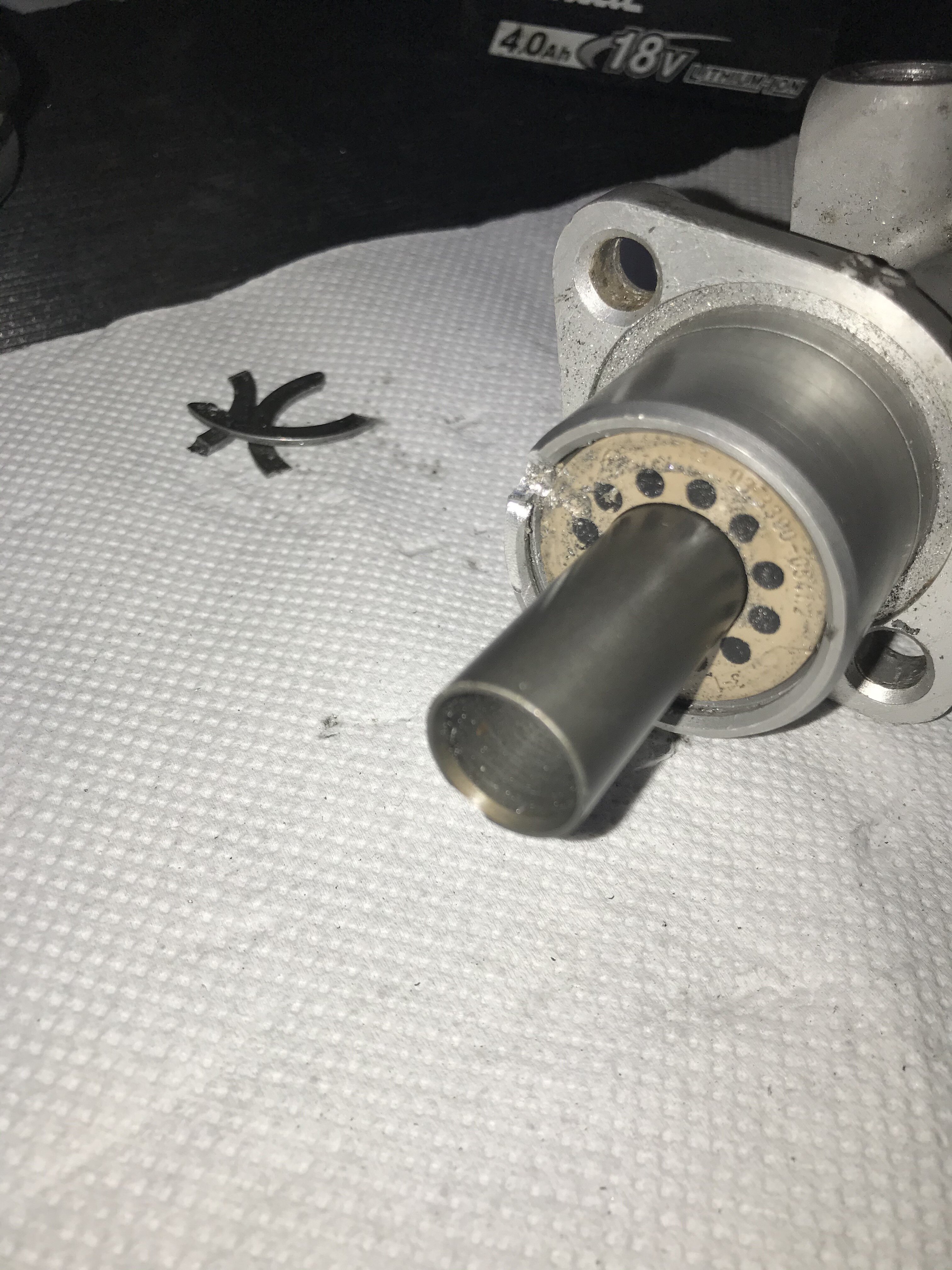

Dont know how Im gonna get the rear piston out. But this may or may not be what was happening with the pedal, pushing the piston in is notchy when it was compressed in with the circlip.

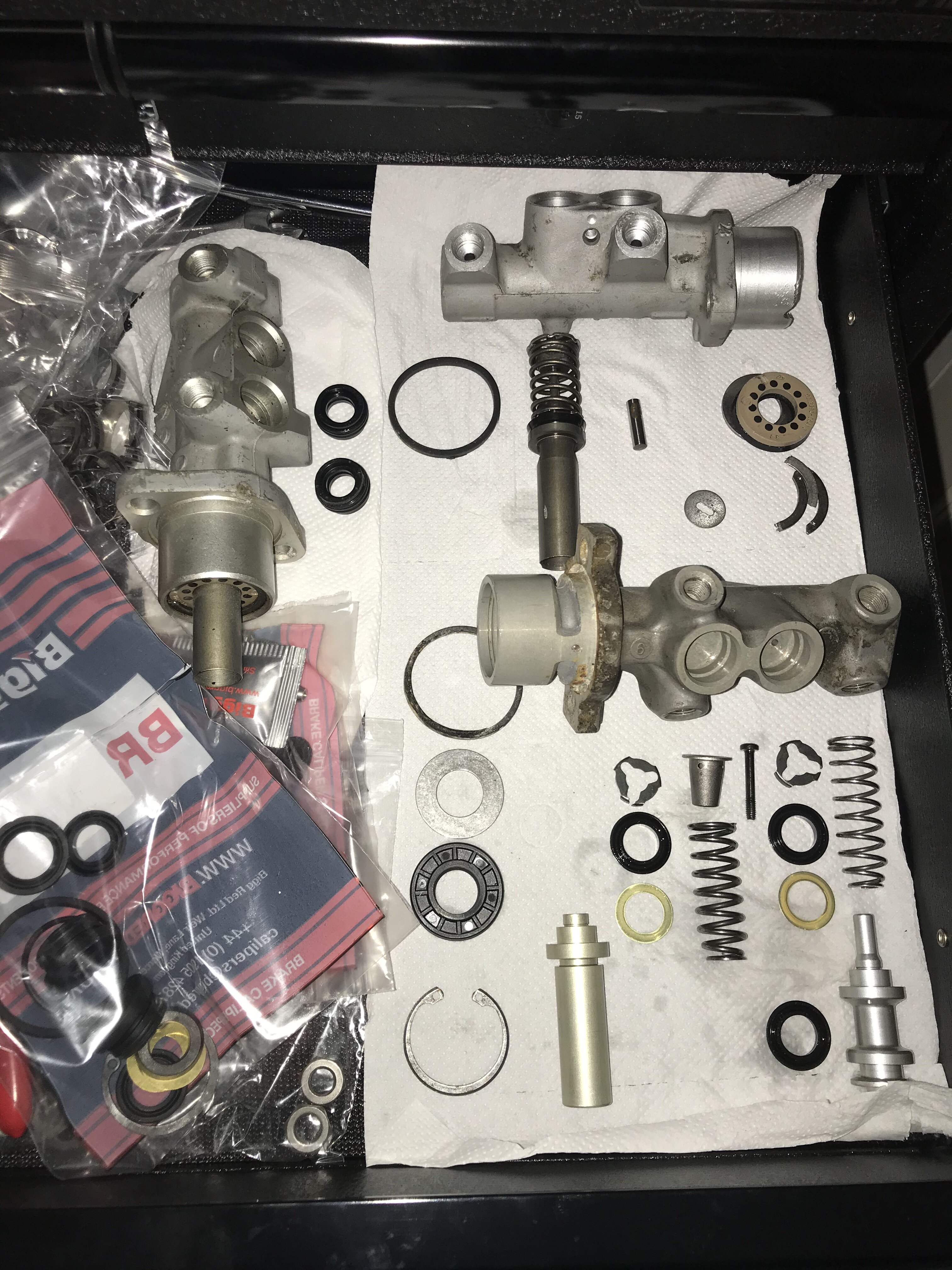

I have a 182 mc and 172 cup mc, the 172 cup is smoother than the others and already has a proper circlip so can easily take apart, big redd do a kit for the bosch mc so might look at rebuilding the cup mc. Im not sure exactly how they work, but I think they have a bias built into them, so the first piston moves before the second. But Im not sure and if they are abs dont they go cross pattern so that if one piston fails under braking the car still goes straight.

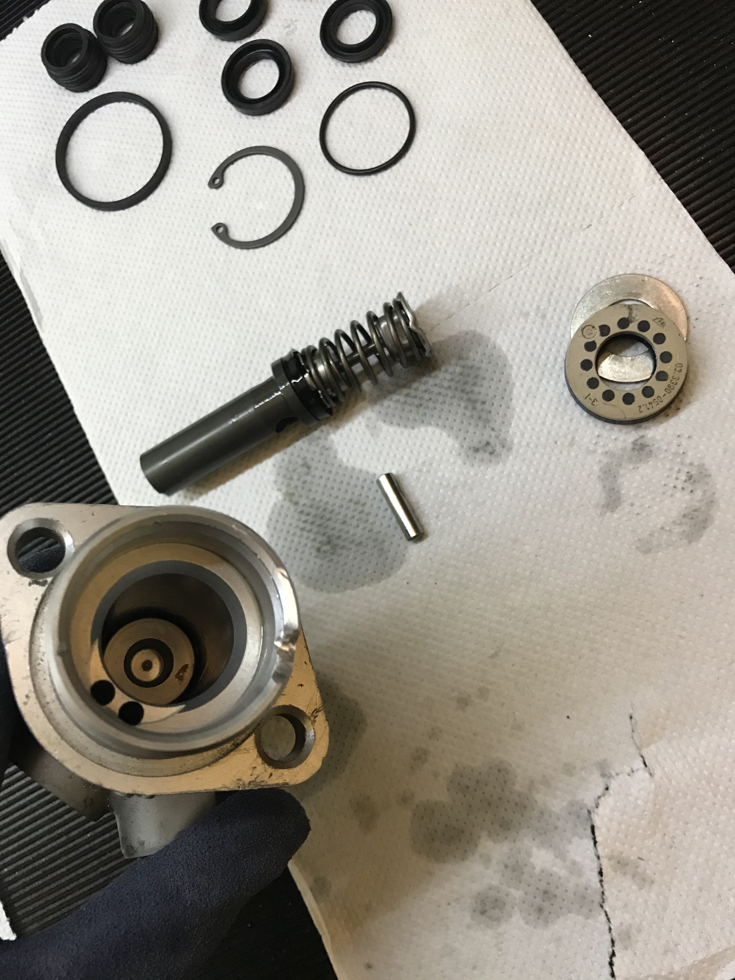

172 cup mc all apart, the rebuild kit from big redd seems all good. Although as you can see the casing has seen better days where it meets the servo.
Im going to rebuild this one up regardless but not sure what Im doing yet. I put a 197 mc back on the car, primed the master cylinder and started bleeding like before, got to the exact point of pedal travel I was before and ran out of fluid! Ordered more but this is all part of the game of learning, I might look at the larger bore non abs mc's from peugeot.
