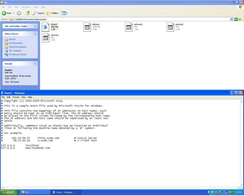

I have done that, but it doesnt stop me from accessing Cliosport ???
Sorry for sounding dumb :o
see screen shot below of what I have done, I didnt press save as, just save. But it still lets this computer access facebook:
help......:)
The file should just be called hosts not hosts1 also you've made it a bak file.
Go to Tools -> Folder options then view tab and clear the tick box for hide extensions for know file types. Rename your hosts1.bak to hosts
In that case make sure 'Show hidden files and folders is on! The original host file is there you just can't see it. delete hosts1 completely.
yes got all hidden files showing, i have done a search for the file name hosts, and I seem to have 2 different directories with similar files in them:
C:\WINDOWS\system32\drivers\etc
^^^ that one where hosts1 was
C:\$WINDOWS.~BT\Windows\System32\drivers\etc
^^^^ that one where the actual hosts file is.............
I am confused :(
just try this for me:
Start menu - run - type: C:\WINDOWS\system32\drivers\etc\hosts and then click ok - use notepad - tell me if hosts opens up
yes it does....seemingly having different text in it to the other ones.....

try your entries in that then just click save :)
Your PC seems abit mental!!
That file is there you just can't see it also you got 2 copies of windows on your PC?
