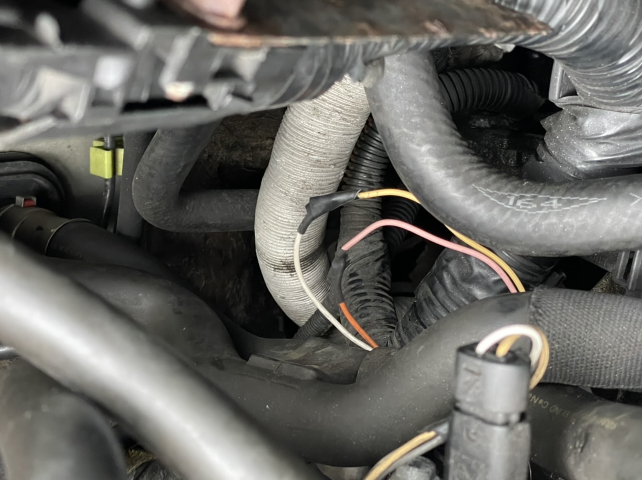

Sensor and loom has just turned up so will be fitting this on Sunday when I get a chance. Will try that trick before soldering it together. Hope it isn't a pain to get to solder to as I remember when I had my old Ph1 I took the old one off and cleaned it up and it was a faff to get at.
Put the new plug and loom on. Got it the wrong way round to start with (which was always going to happen). Fires up first time.
For reference if anyone searches this in the future this is the way the wires go:
Pink (new loom) to orange (car)
Yellow (new loom) to white (car)
was a genuine Renault sensor and loom I used.
