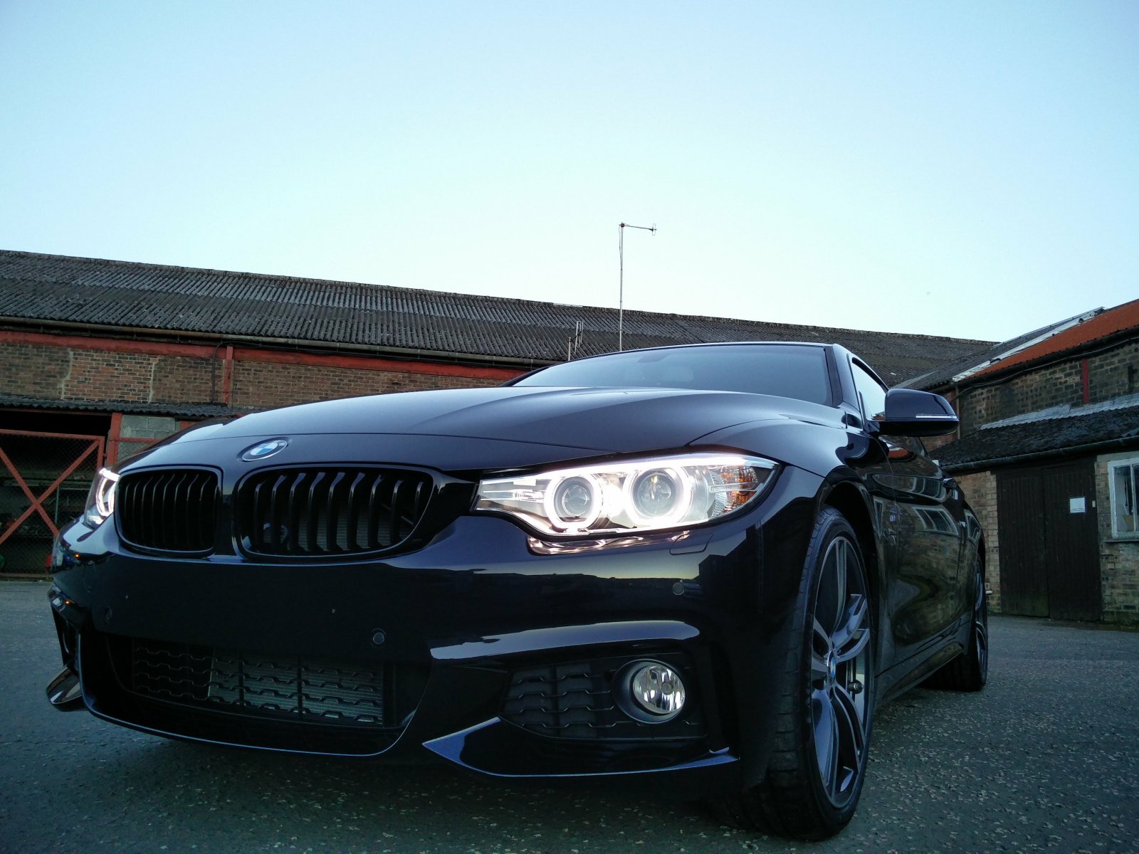

Thought I'd stick a thread up about this one. Helped my mate out with his new 440i at the weekend as he wanted to apply Exo to it but naturally wanted it swirl/mark free before going on.

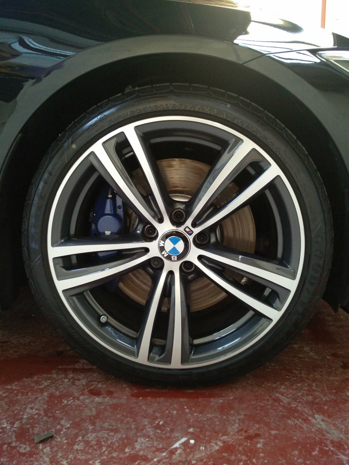

Car was already pretty clean when we started (he cleaned it the day before) so was just given a quick going over with a mitt and 2 buckets. Iron X sprayed on the wheels, agitated and rinsed. Surprising amount of fallout on them, although we had done 120 miles of 'spirited' driving around some country roads the day before!

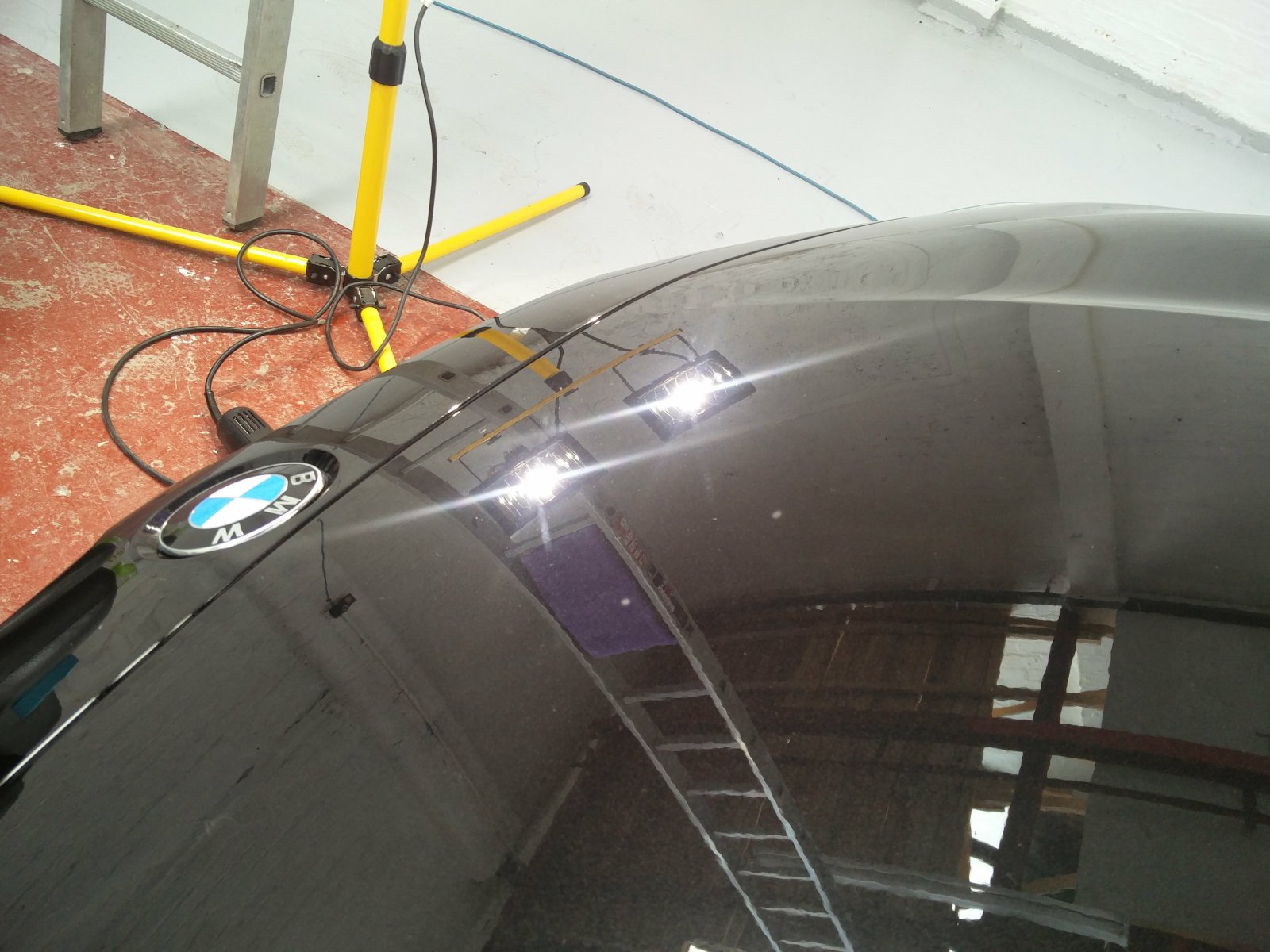

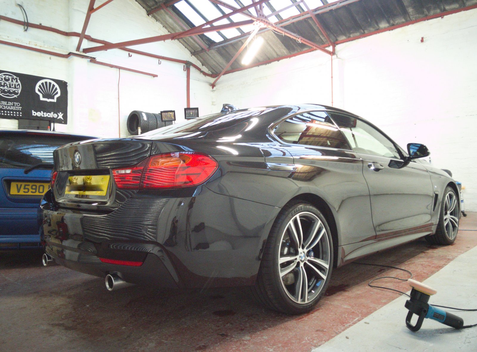

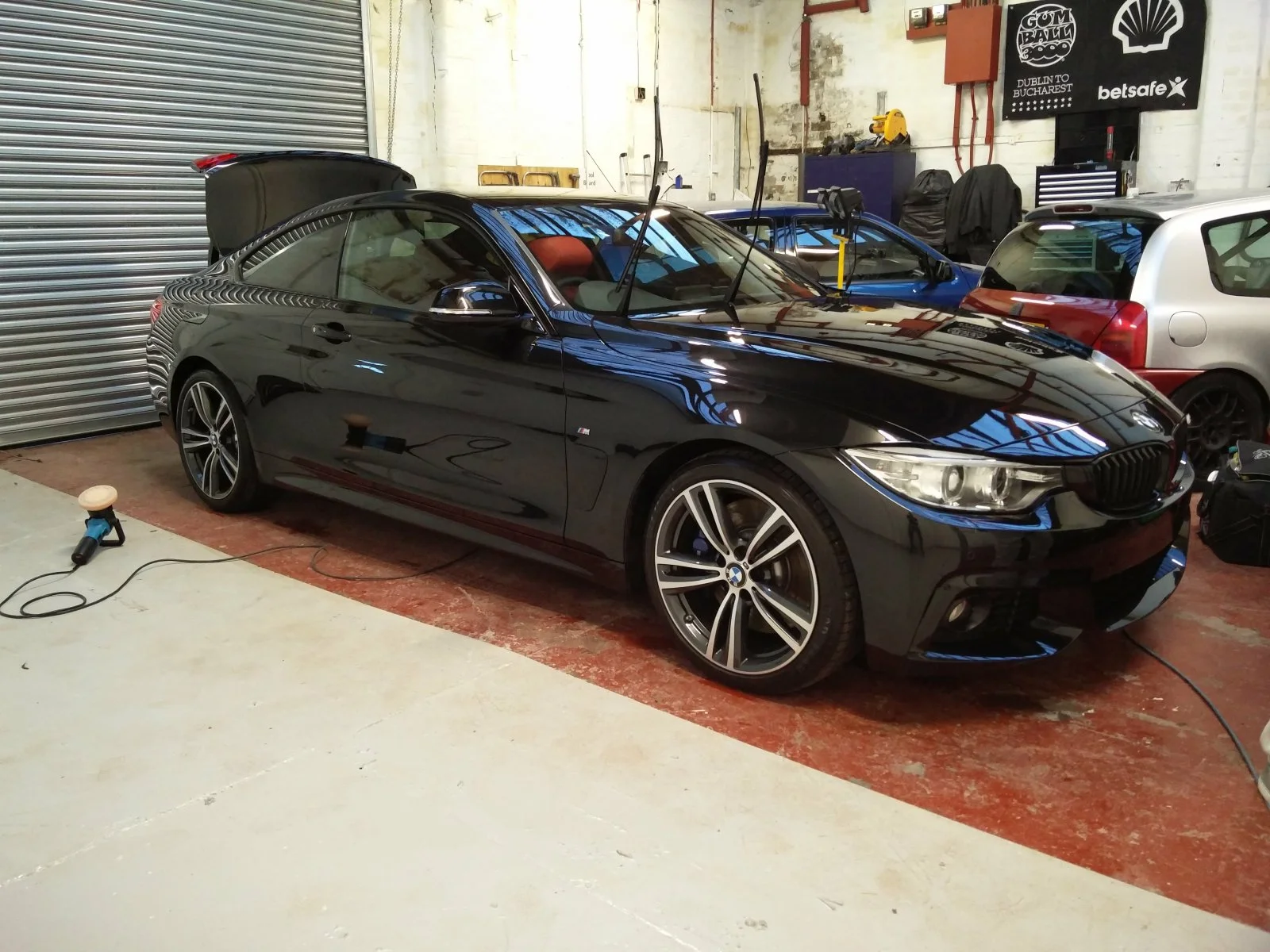

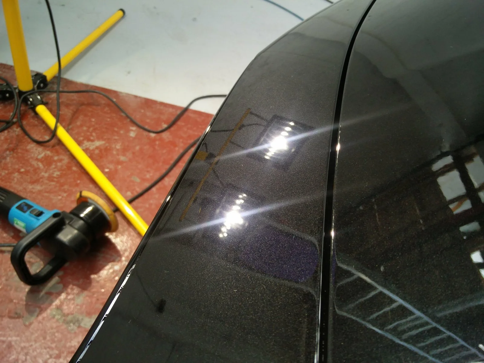

Apart from a large (light) scratch on the bootlid and a smaller scratch in front of the rear arch, there was very little marking on the car, as expected. The only real swirl marks came from the microfibre's we used to wipe the clay lube off with, as can be seen in the last photo.
Whole car was given a once over with an orange hex pad. Tried both white and green but neither seemed to really touch the small swirls above. Either BMW paint is fairly hard or I need to brush up on my technique...

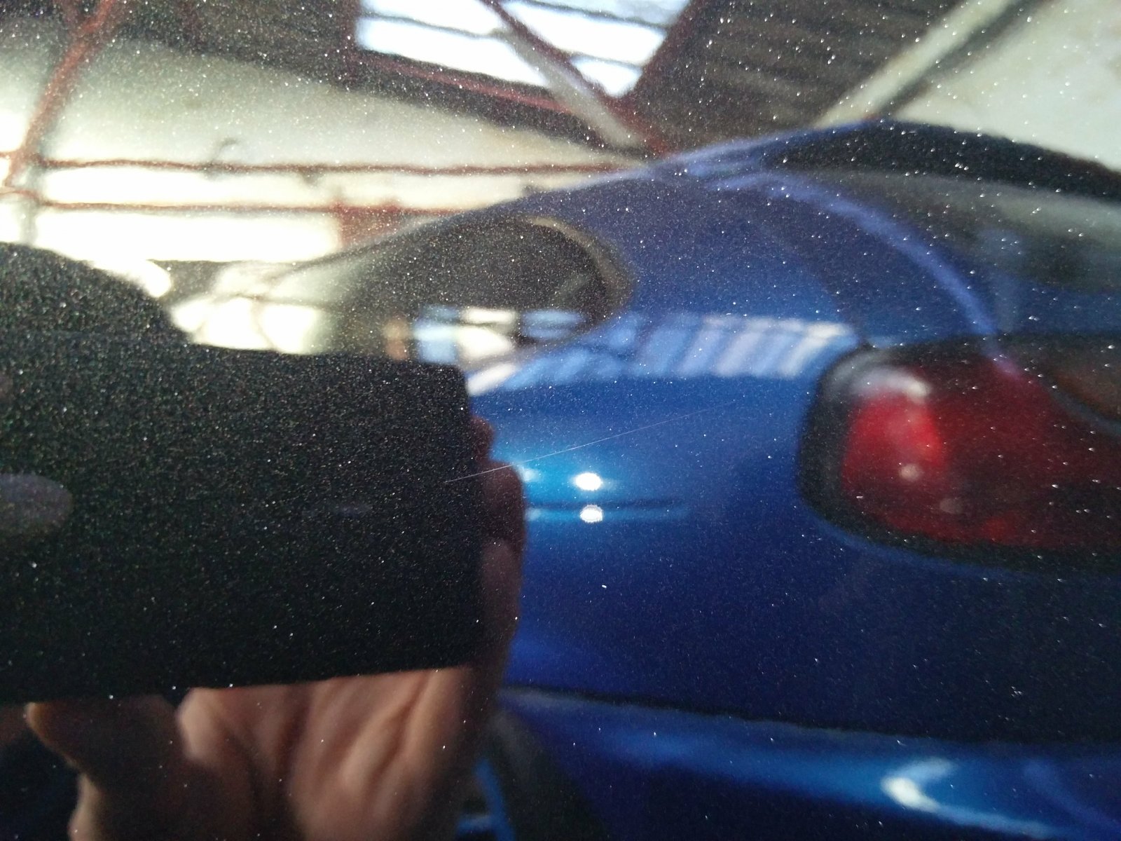

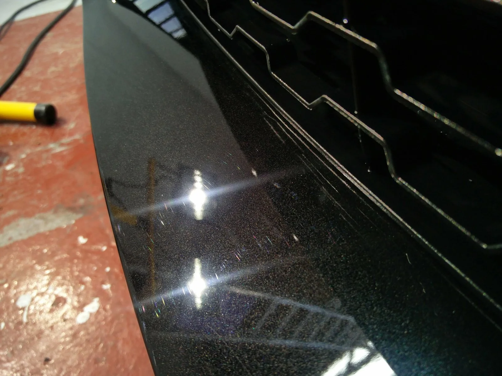

The scratch I mentioned above at the rear arch was the most stubborn part. Looked like so initially:

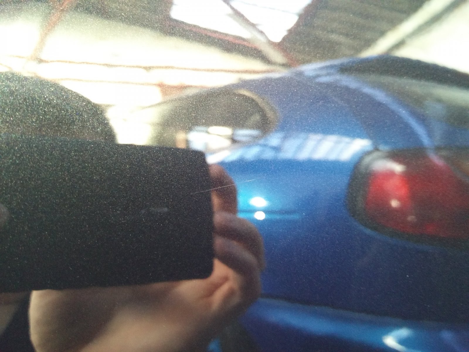

After one pass:

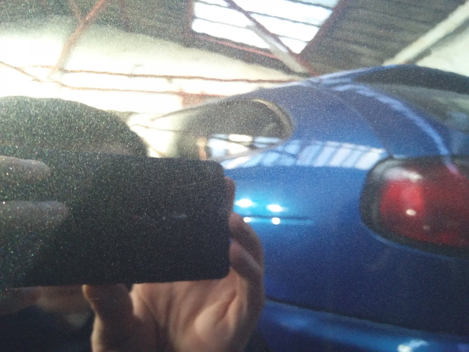

And a second pass:
Still there but it's barely noticeable now.

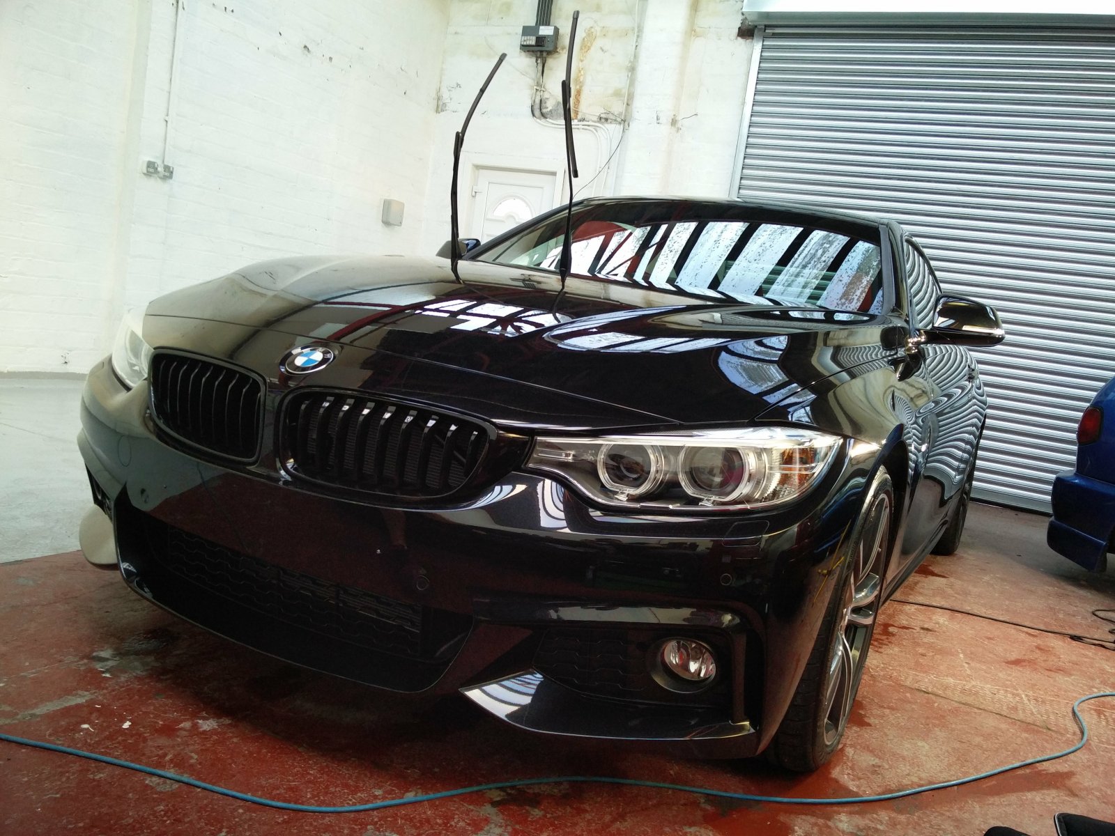

Car was given a full going over with Panel Wipe and then we went around the car twice with Exo. Very easy product to apply and remove!

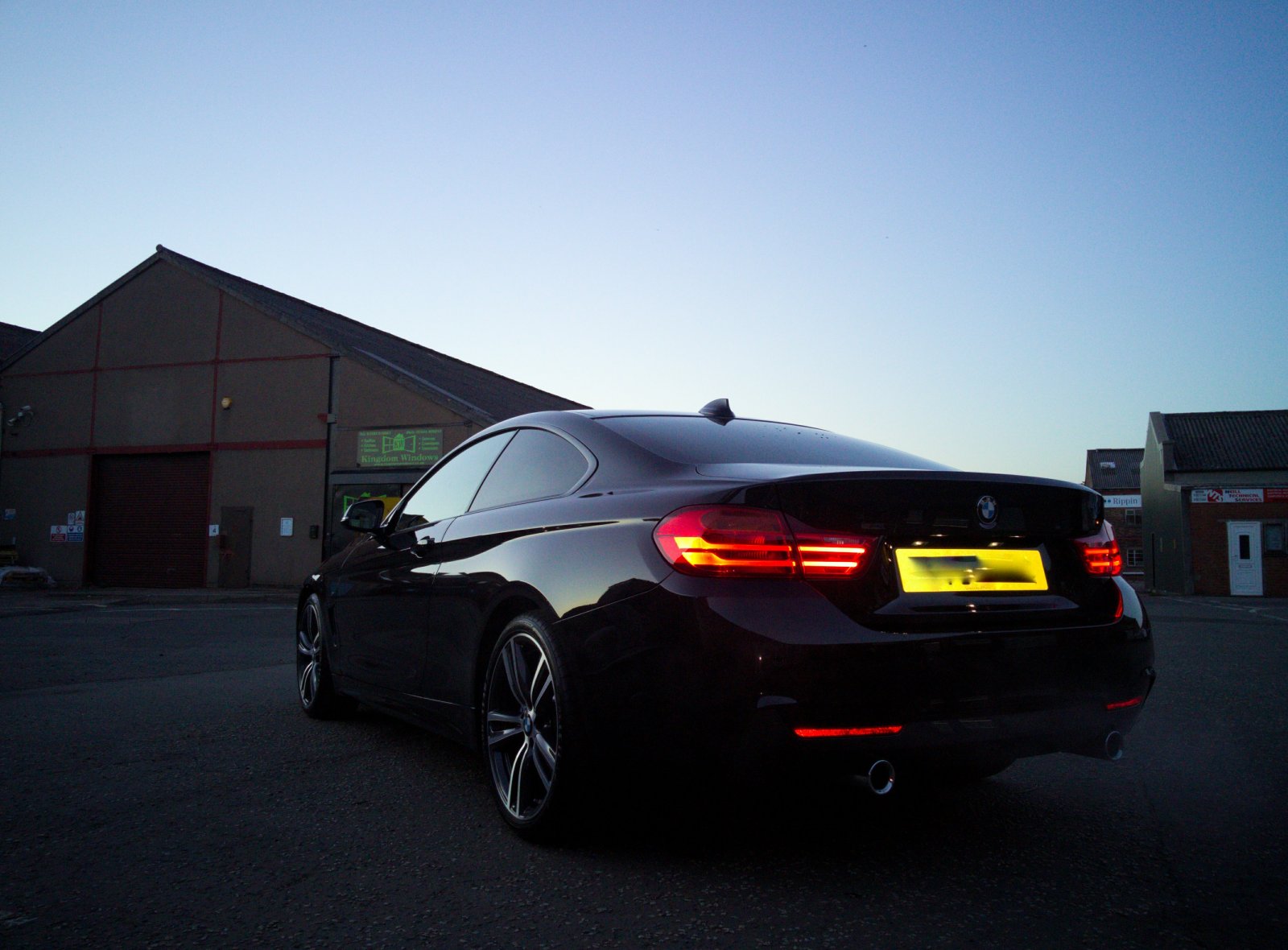

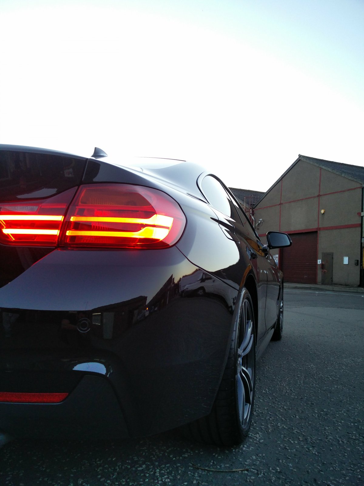

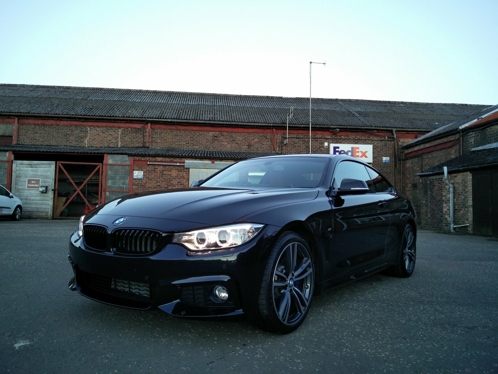

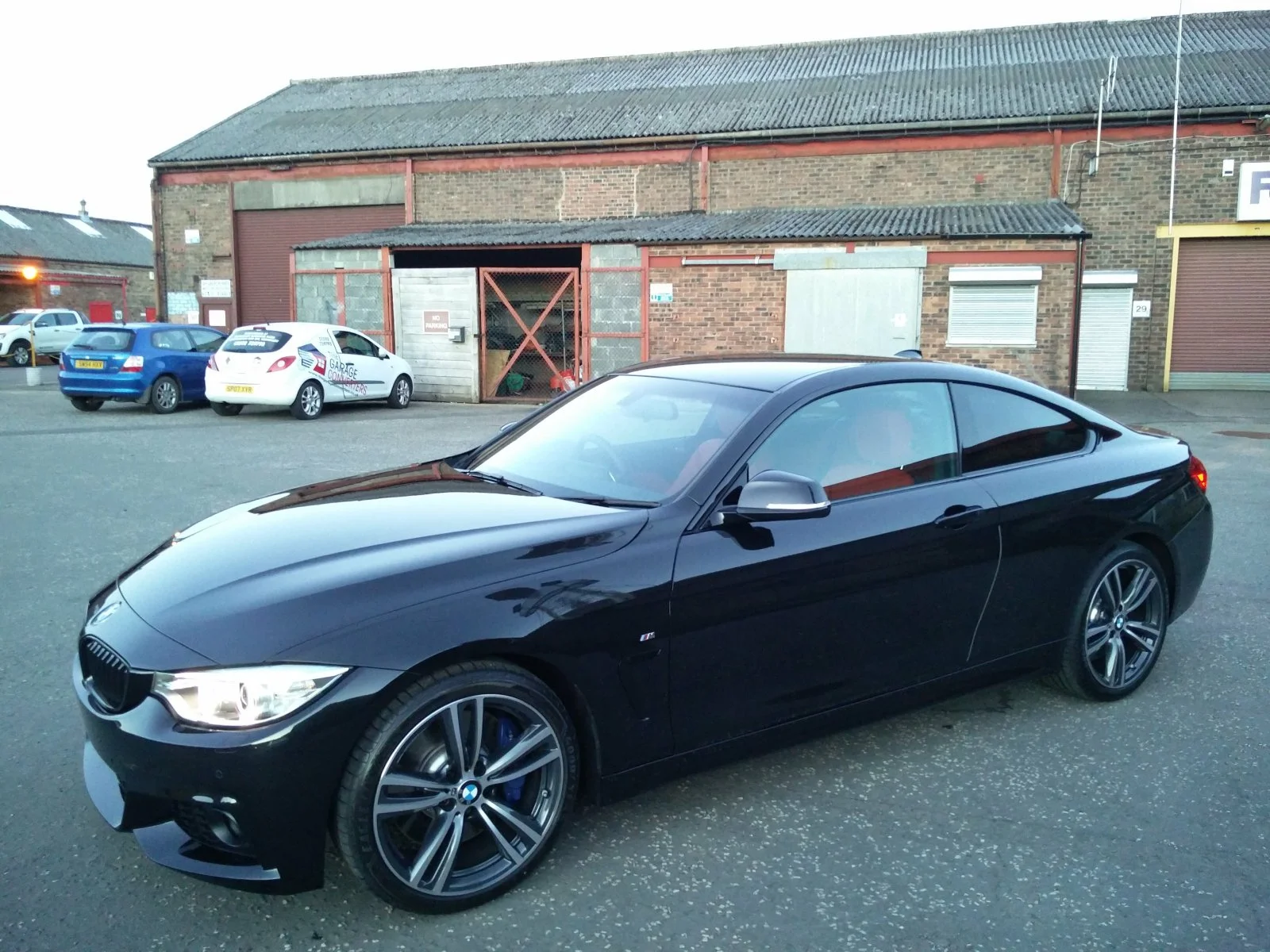

And finished!
We ran out of time and didn't manage to get the wheels off and all sealed up with Exo but hopefully will be able to get it back in and get them done in the next week or so.
