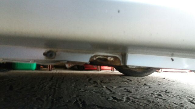

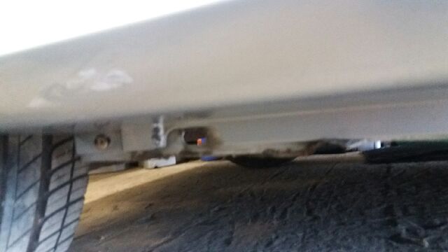

Anyone had a body shop repair the jack points and treat to prevent rust and paint.
I've checked loads of threads but can't find any prices for professional work being carried out, any ideas anyone?

I'm thinking about tackling this very job myself, I'm thinking Deox gel, electrox then some good black underseal.

Not had to do fuel filler as mine are all good but done plenty to sills. The pics at very top look good so i wouldn’t mess around to much.
Tbh to get a full understanding of what work might/not need doing I would remove the side skirts and door cards to see what’s what first.

It's definitely the type of thing you can do yourself and your particular issues looks early.

That's the better one of my Clio's I'm trying to get on top of this one early. You saw the fuel filler on my other motor I think it definitely needs professional help.
