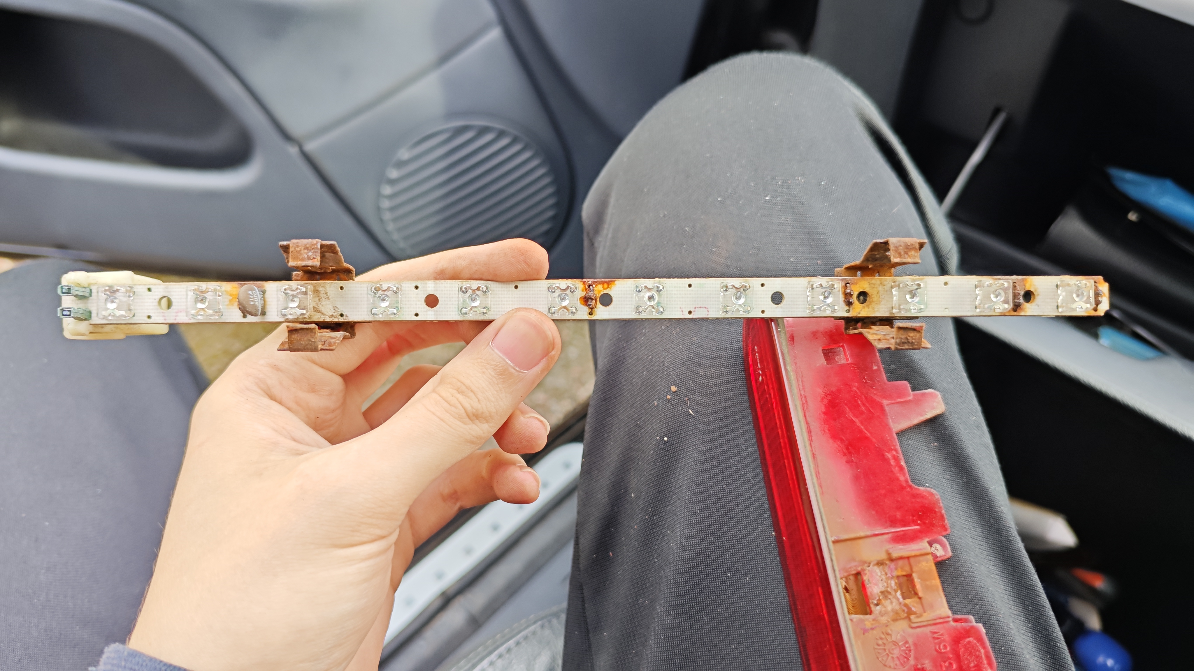

Update, pulled out the top light a little more which provided enough room to jam a longish flathead screwdriver in from the left and lever the connector tab up with ~15 mins of fiddling and luck. Light's out now and the resistors on the PCB are totally fucked, one broke off with zero effort, so awaiting a new one from JMRS now. £28 and free postage so probably about the same as cannibalising an eBay unit but likely more trustworthy.

Just LEDs and resistors as far as i can see yeah. Problems are that I don't think PCBs are readily available and i don't know what resistors to be using since the old ones are so corroded the casing isn't present.

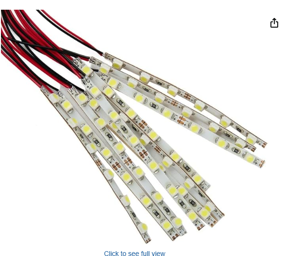

If anyone is having an issue with this a cheap fix I ended up doing on mine is using these cheap little led strips then just sticking them to the part where the little bulbs used to be even lined up pretty well with where the bulbs were then just wired it in. Just make sure full cover all the exposed wire which I did not at first blowing the fuse which also is the fuse for the dash and other brake lights which was a fun drive to and from work. Regardless worked a treat since I sorted that and for I think a fiver for 5 strips no doubt the easiest and cheapest fix to this common issue.

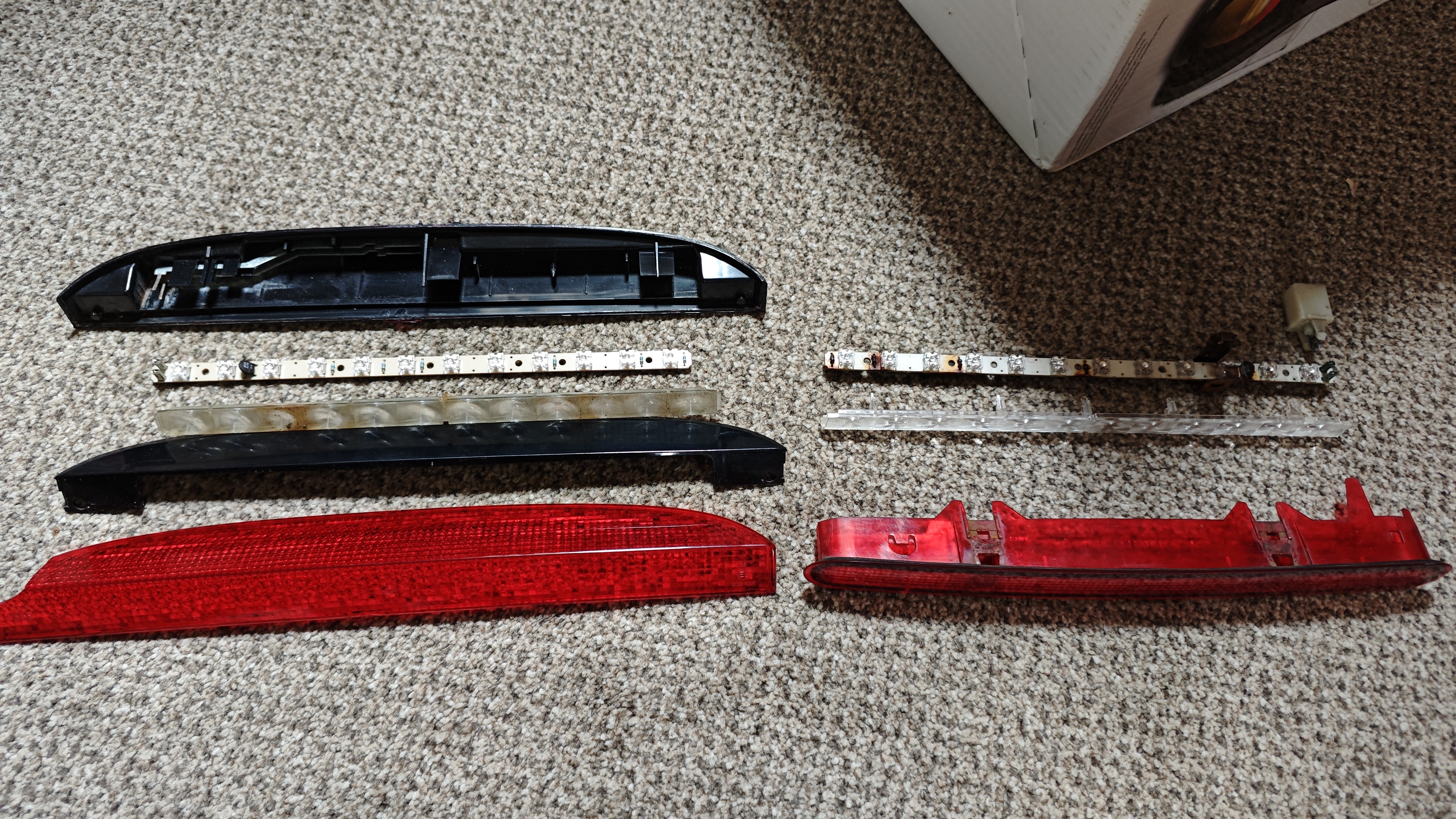

Finally sorted - bought a used non-Cup light in good condition on ebay for like £15 and swapped the strips. Once you've gotten into the sealed unit the swapping process is very easy, they have different connectors but these easily unclip or pull out of the PCB. Image for documentation purposes and the benefit of anyone finding this thread in future.
Finally sorted - bought a used non-Cup light in good condition on ebay for like £15 and swapped the strips. Once you've gotten into the sealed unit the swapping process is very easy, they have different connectors but these easily unclip or pull out of the PCB. Image for documentation purposes and the benefit of anyone finding this thread in future.View attachment 1791329

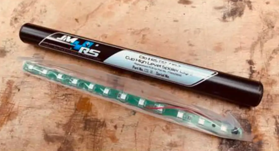

I've recently bought the JMRS replacement board to sort out my cup spoiler light.

Pretty easy once it's out of the spoiler, which I described in previous replies and needs a decent amount of patience. The PCB is only held in by metal clips around the main housing and some prongs on the inner clear plastic diffuser. Both are simple to get off.

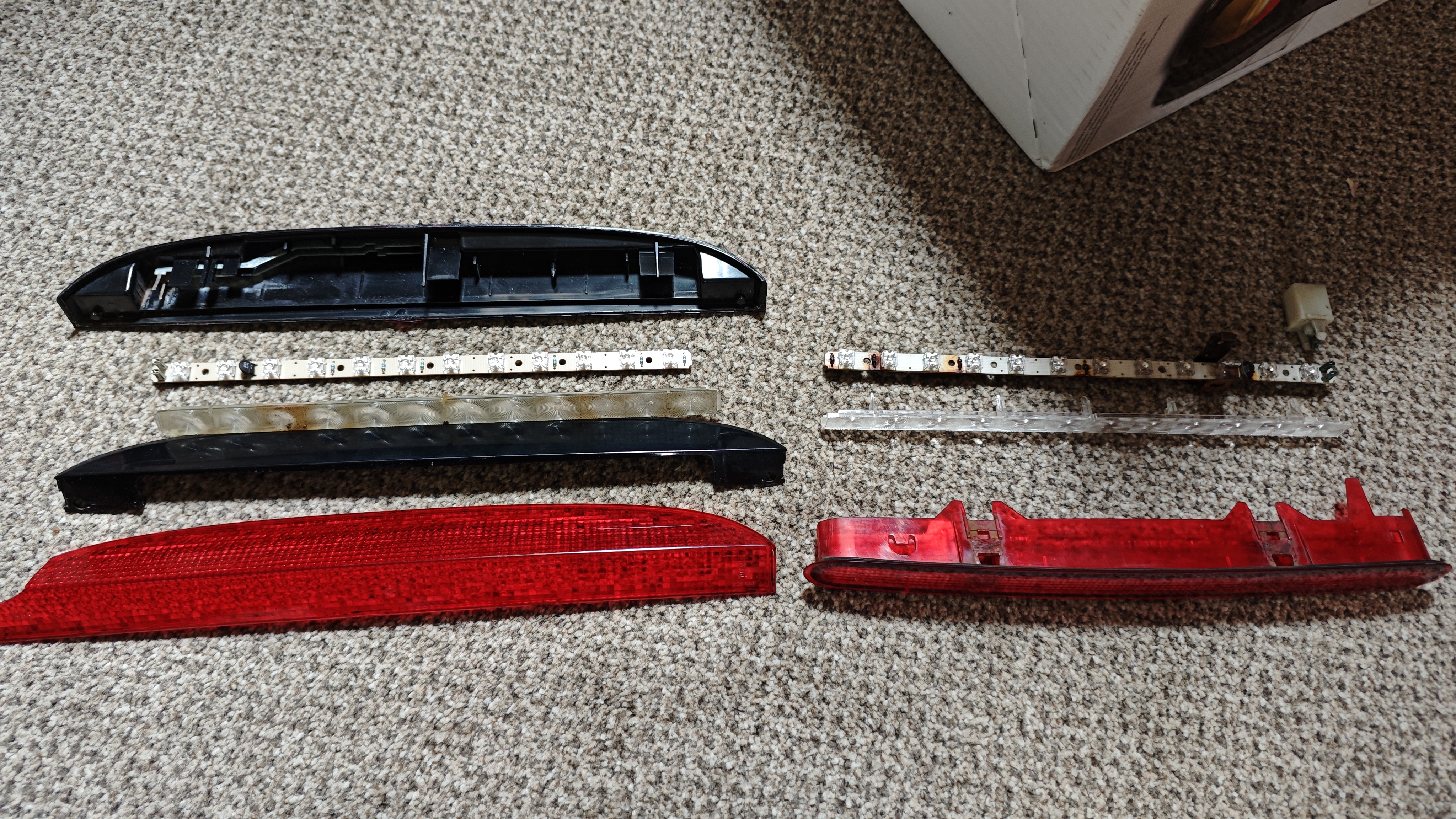

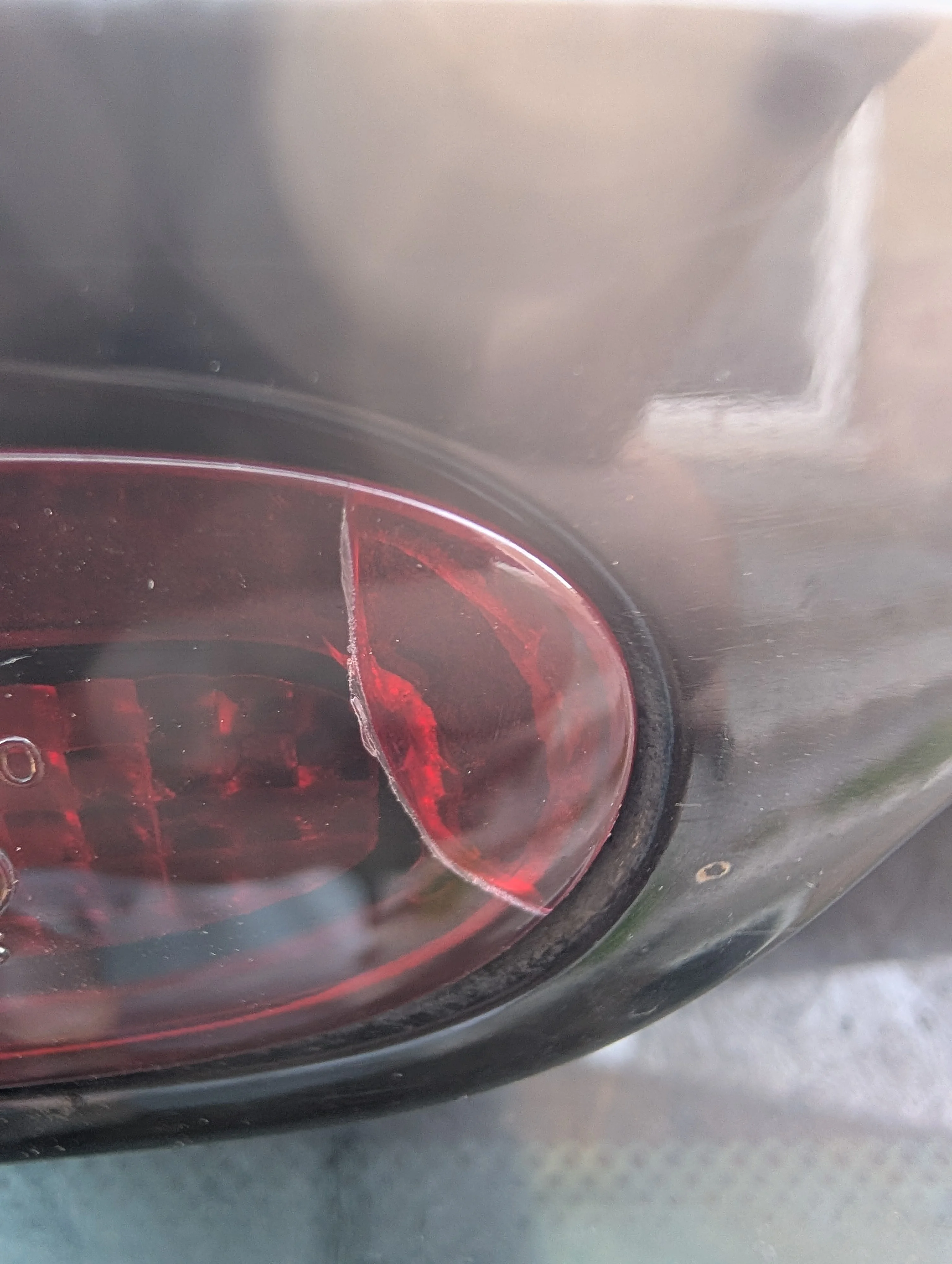

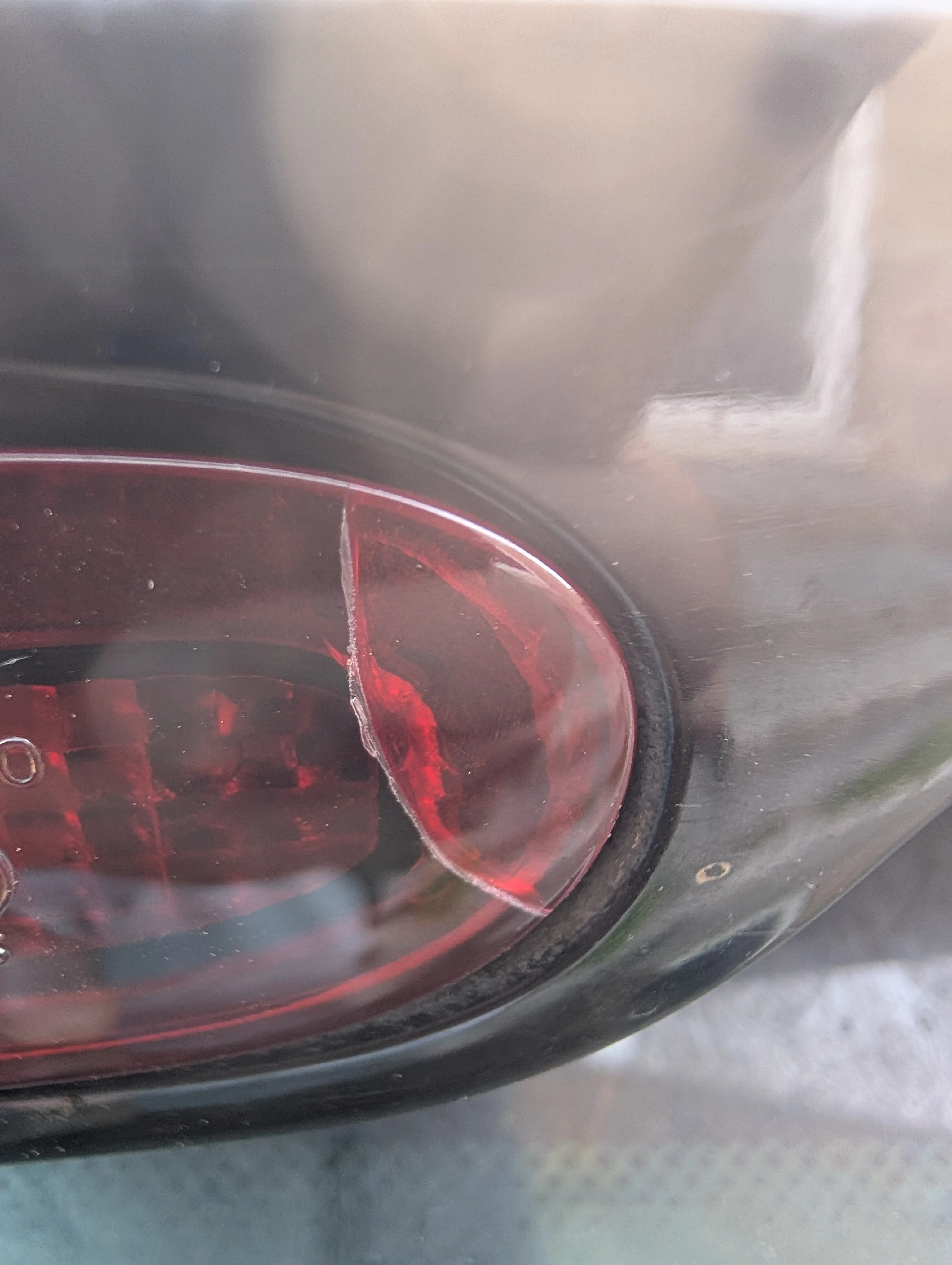

Well I had a test go at this. Read that it could be a pain in the ass to get the light out and the spoiler back on. Wanted to see how bad it was to do before I replaced the actual led board.
Light came out piece of piss. Old PCB came out fairly easy after fiddling with the metal clips.
Refitting spoiler a bit of a pain but doable without a second person.
But FML I cracked the light unit pushing it back into place so got to get another one now anyway.
So yea, if anyone has a 182 cup spoiler high brake light unit they want to get rid of, hit me up please 😂

uh oh 😶 i haven't tried refitting the unit yet and it never occurred to me that breakage could be an issue at that point... good luck with finding one, i think it's the same one as is on the mk1 megane coupe, if that helps at all
I think it's because it went in at a bit of an angle. I gave it a tap and it hit the lip on the edge.
Lesson learned for next time though!

I repaired mine for a fiver. See my Clio Projects thread. My damage was very similar to yours.
