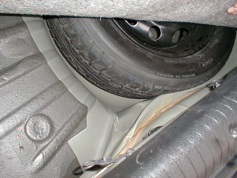

My 1.2 was hit from behind, no damage to the bumper apart from 2 small marks where the reg plate screws of the car that hit it were. The boot floor creased but the insurance said they would repair it.
All this internet talk of 95% chance of writing off is rubbish. Its just a crease in metal, albeit in an awkward place.

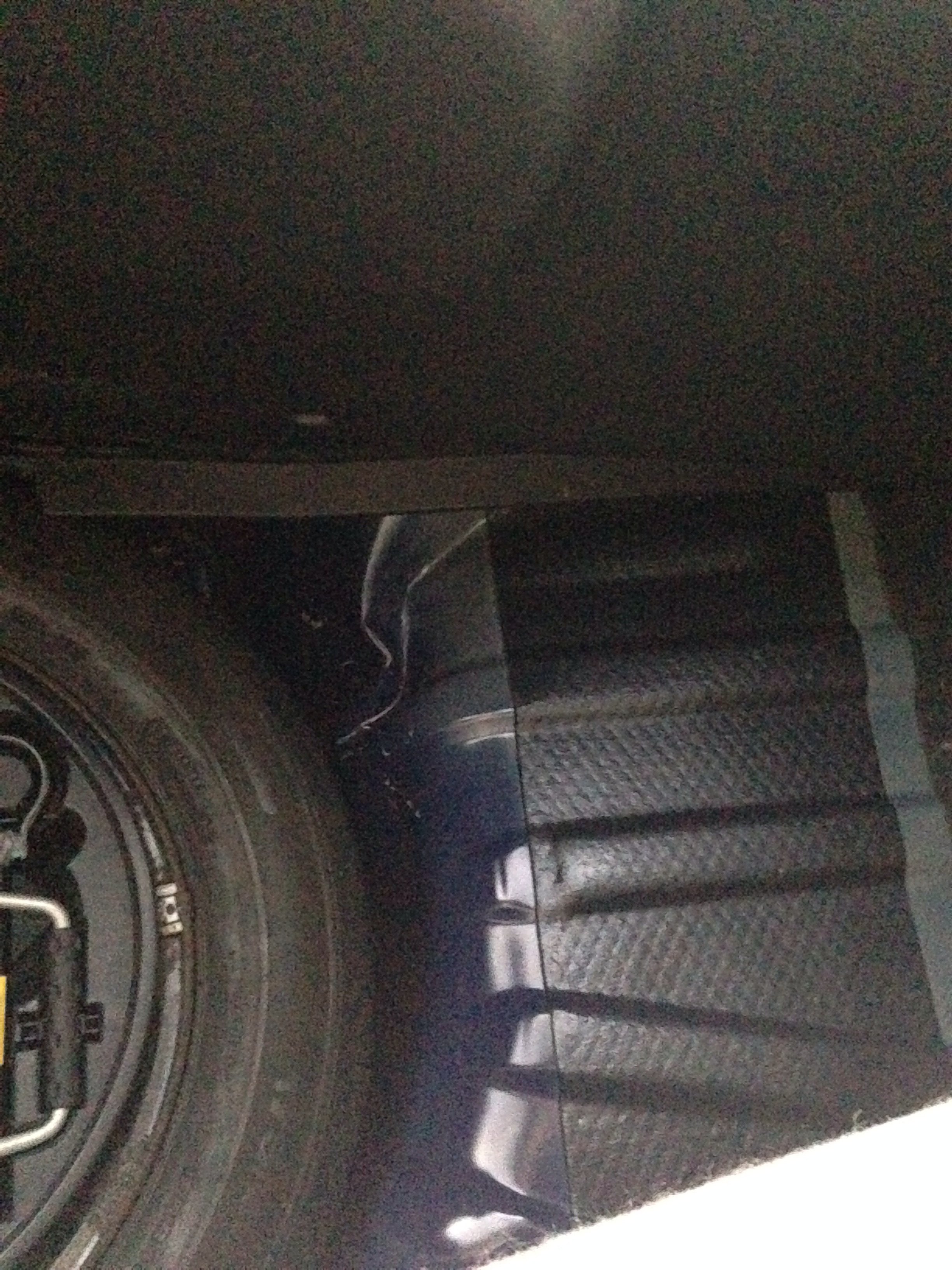

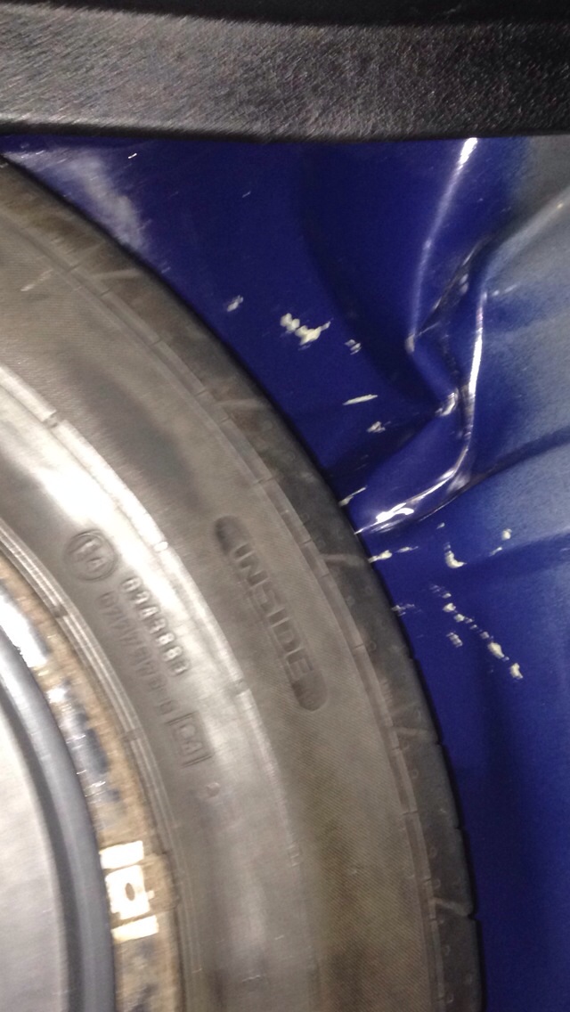

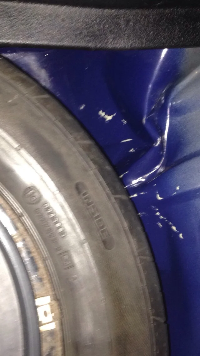

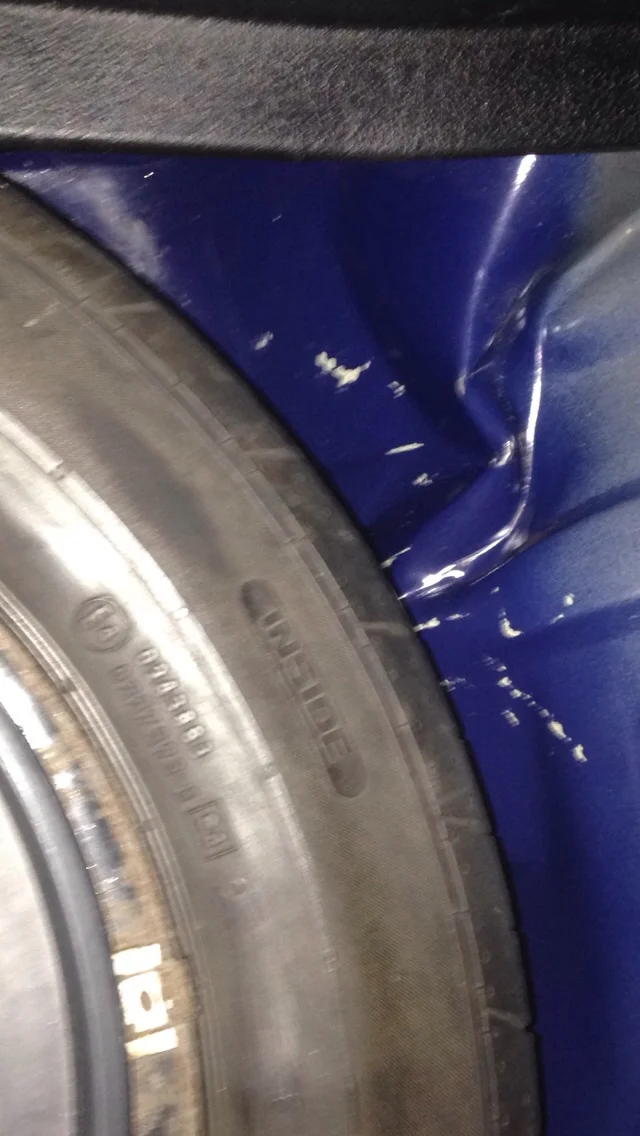

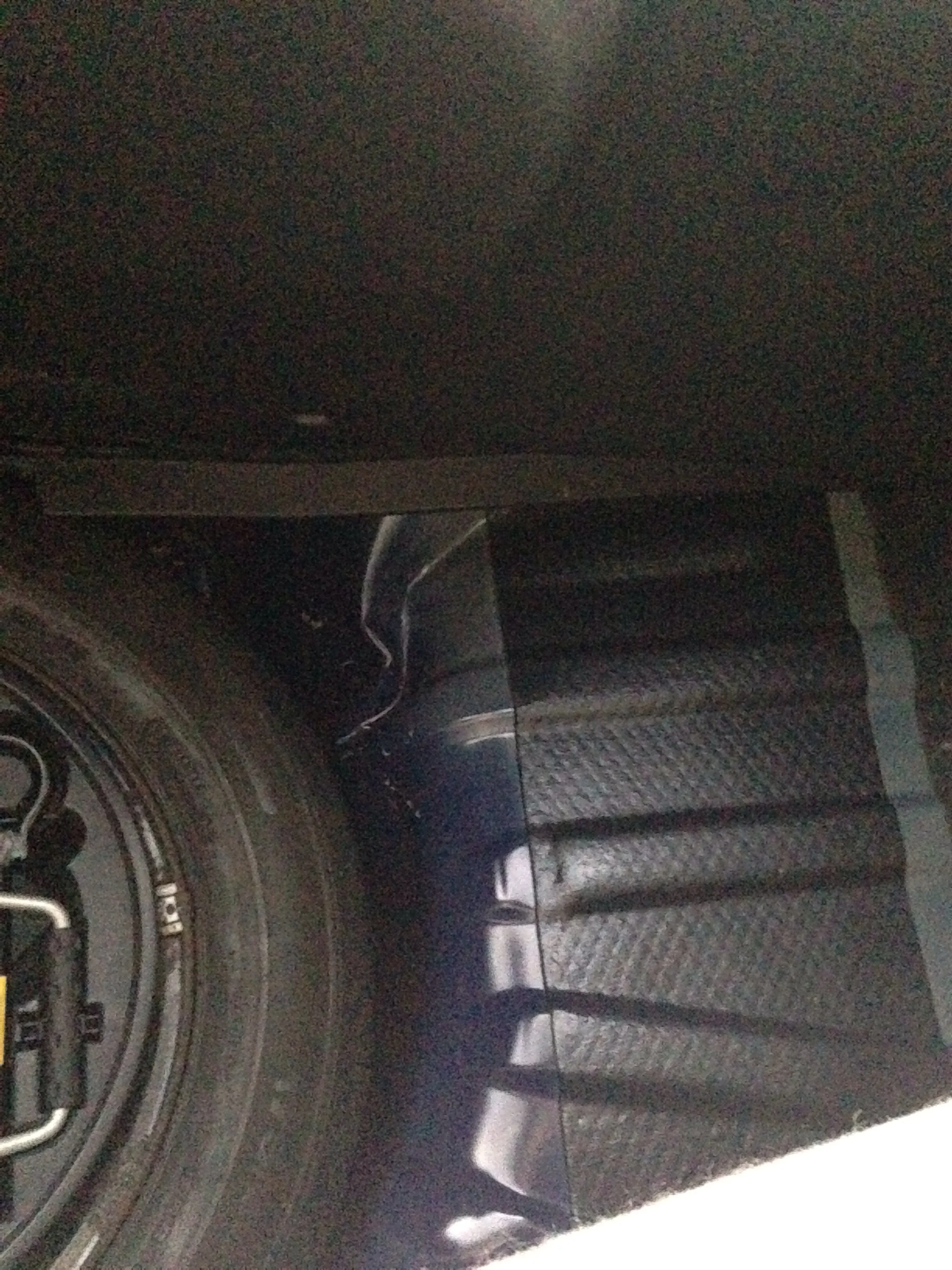

The insurance company seemed to want to write mine off but don't think they valued it high have you got an email I can send you photos ,yes the consensus seems to be bad for boot floor
GrahamS
Depending on age and mileage that is likely to be dead. Would be easy to repair by giving it a tug on a jig but the insurer will have to put it back to how it was before and a tug is unlikely to do that.
