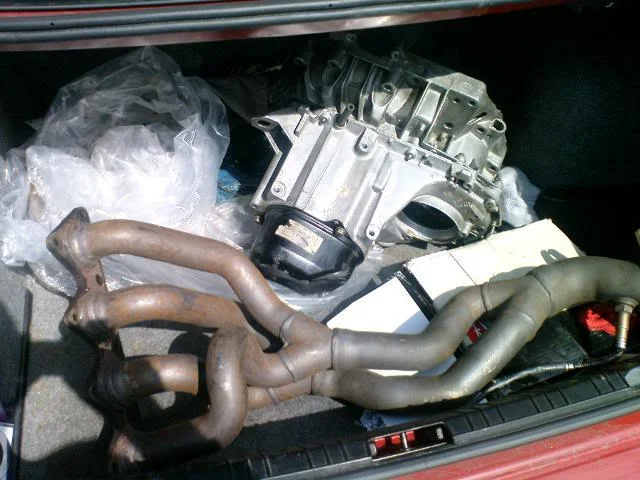

got some new goodies for my trackday at croft.

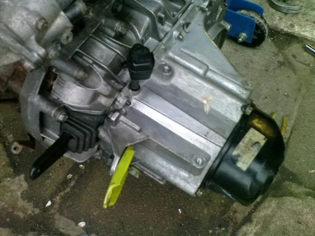

above is my avanti transmisson, jsut got it back from avanti/benr!
avanti dog gears, levers, rods and bearings in JC5 case
avanti MAXI LSD, bolt on crown wheel with intechangable final drives, shorter by 14% ATM
air cooled oil (setrab or mocal), pumped by mocal external pump
also got a new engine to go with it before i fit the SC (mental note, must get car to AWT)
engine spec is
AWT Bowl port and polish (mild headword)
AWT GrpN CAt 420 cams
AWT re built head with new steam seals, guides and valves
AWT fitted a new head gasket, studs, seals etc
AWT fitted a new cambelt (kit)
AWT fitted a full new aux setup
New end caps, cam studs
AWT matched inlets (rs lower)
182 exhaust manifold and link pipe for 172
had to order this to match my 172 exhaust up

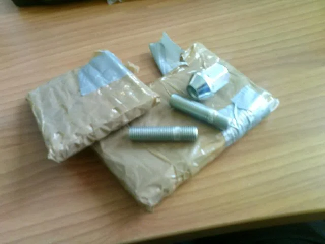

these came today too (stud conversion kit) should make it less hastle to swap the wheels!

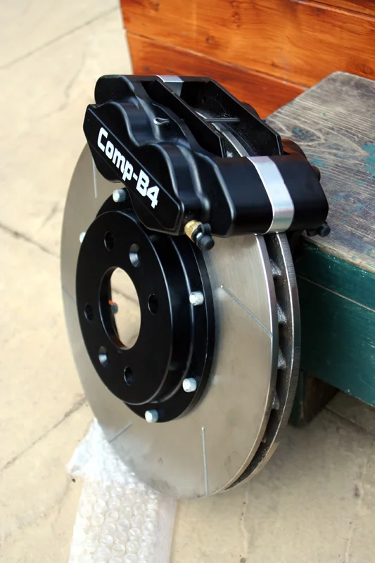

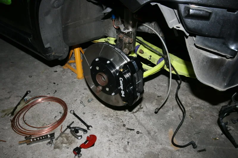

are you thinking of any brake upgrades? (if not already got)
  C63 AMG, F430 & 172
sounds a beast, whats the expected output? 200ish
how much has this dented the wallet? a LOT
my brakes, 4 pots, 295mm two pice bells and rotors

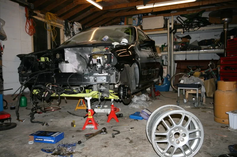

the car

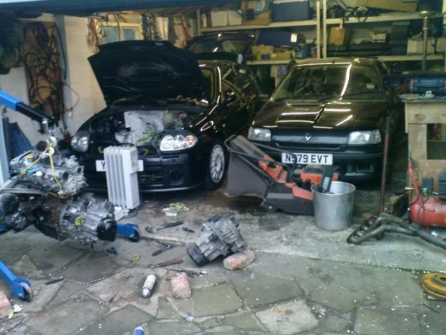

not much progress last night.

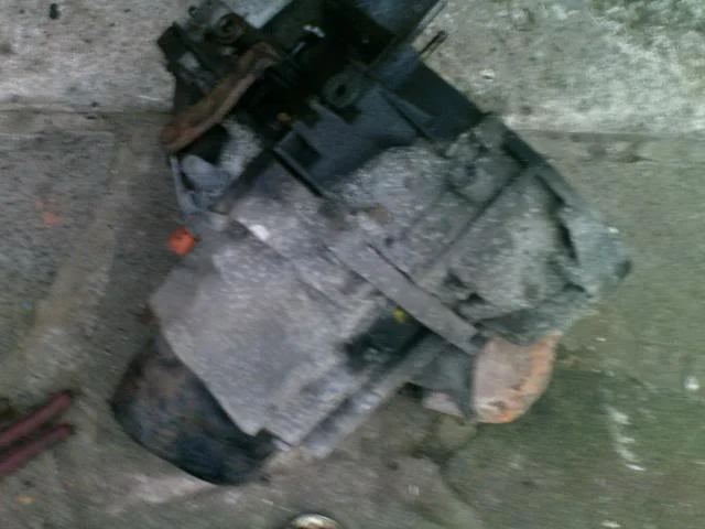

first up was to change the box's over, removed the old on in about 30mins which wasn't too bad! But the avanti came with no selctor mech link, no cable brace, reverse sensor, i also had to block off the oil pump -8 fittings.....the above should not of taken more than a hour at most! but the bloody selector link was a right f**king b**ch to fit! Getting the grease covers backon was HELL!
anyway, re fitted the new box with a new release bearing!
old box off!
new box on!
On of the engine with the new box! and also mine and SamboRT's (brothers) track cars in the garage! (and my dads track spec Flymo)
