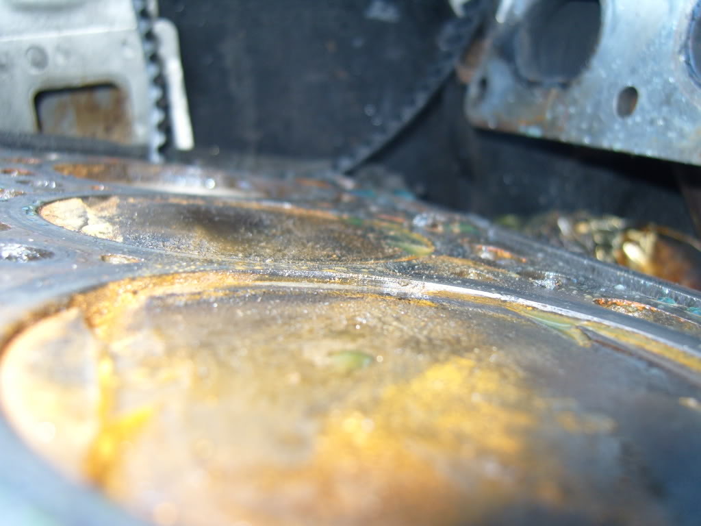

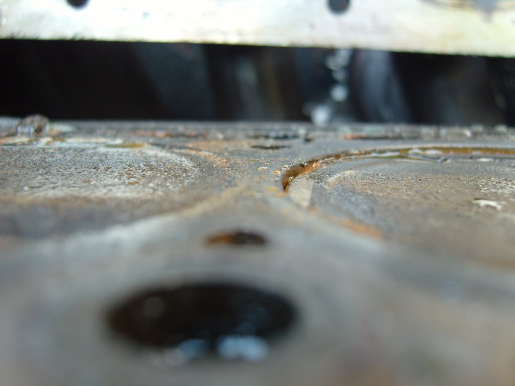

Its fucked the bottom end though as the heads off and its still hard to turn over. but is this a sign of pinking on the pistons?:
poor pic i know, but they ALL have it

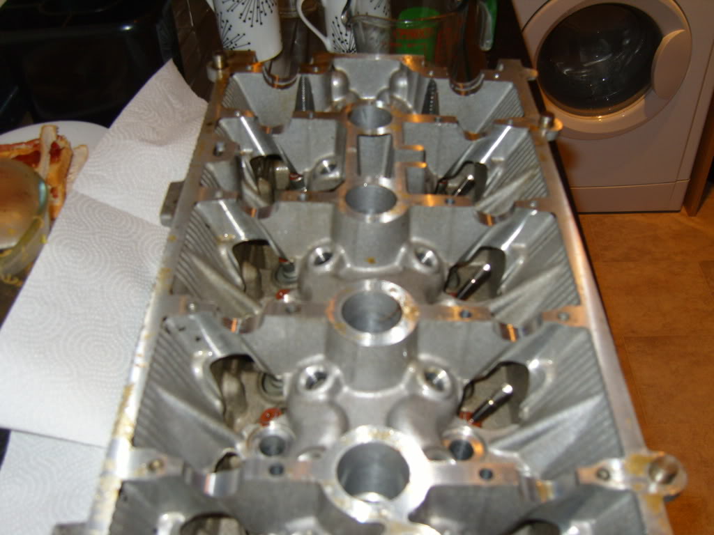

little bit of progress:
this stuff's great! £1.29 and i've cleaned 8 valves and the head and rocker cover:

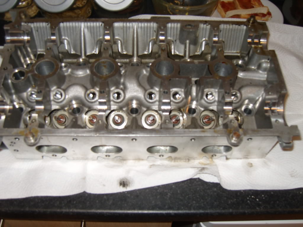

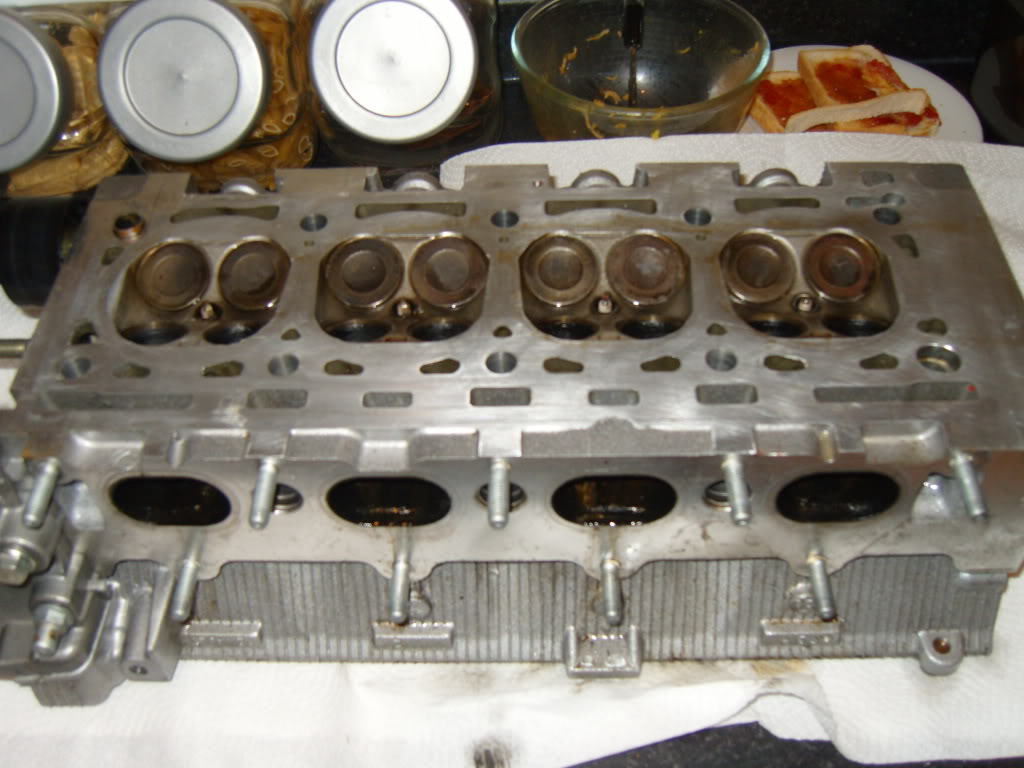

head cleaned and starting to put in the inlet valves. will grind them in tomorrow..
new stem seals:
as you can imaging the fiance isn't too p[leased with my work bench lol

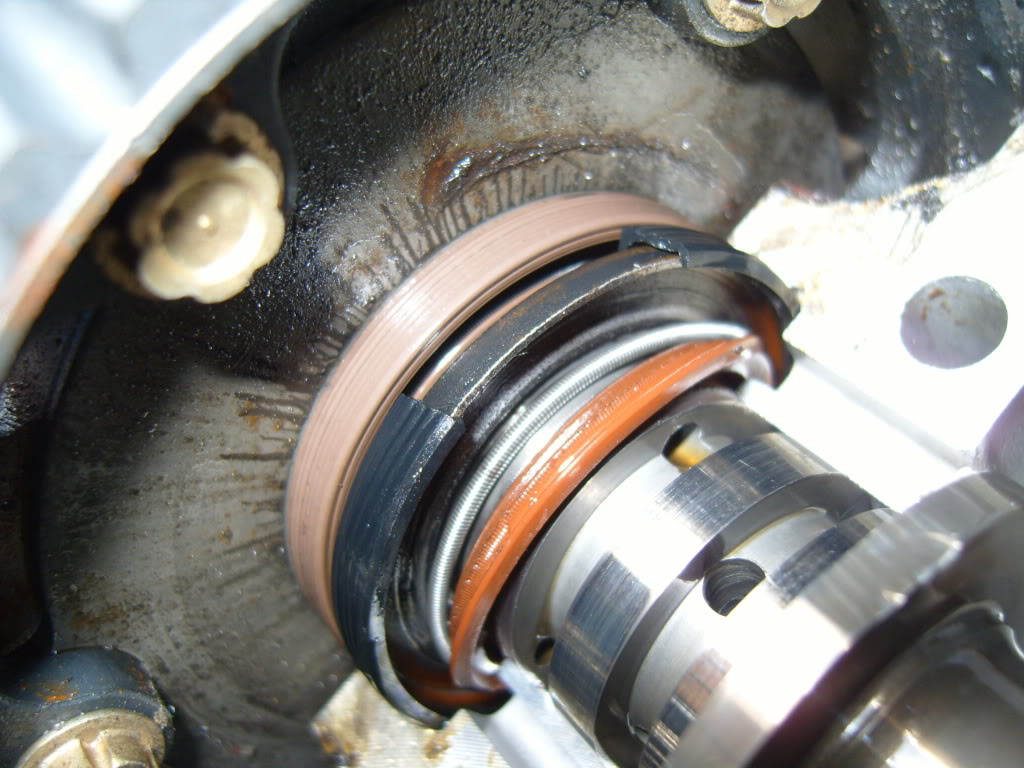

i believe i've found the cause of the bottom end failure.
The oil seal on the inlet cam has broken up and i would have thought that'll be the cause of the oil on the cambelt.
would this have caused any damage to the dephaser?
  f**ked ph1 172

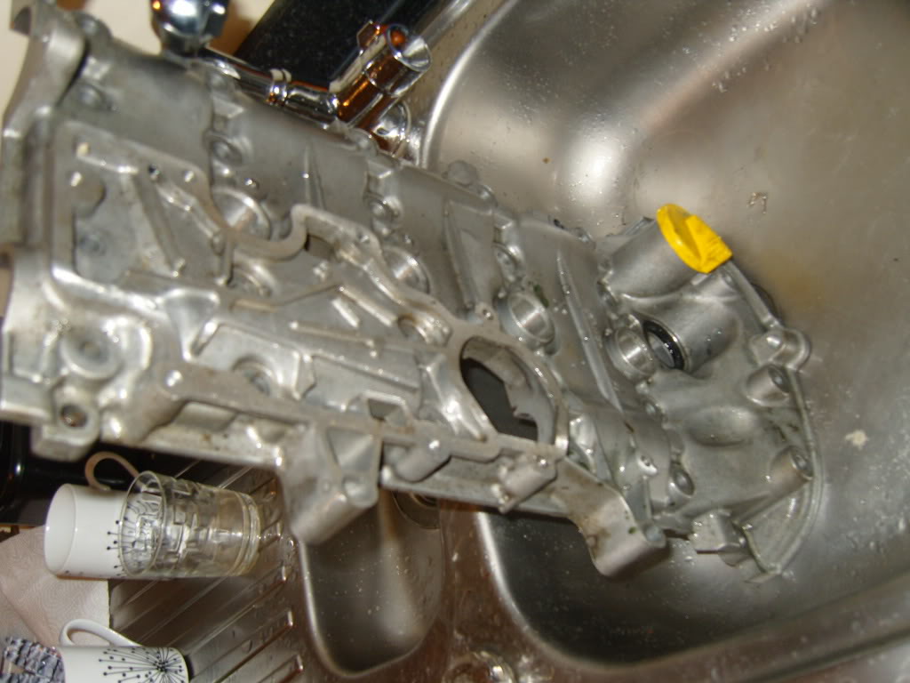

pic of the seal:

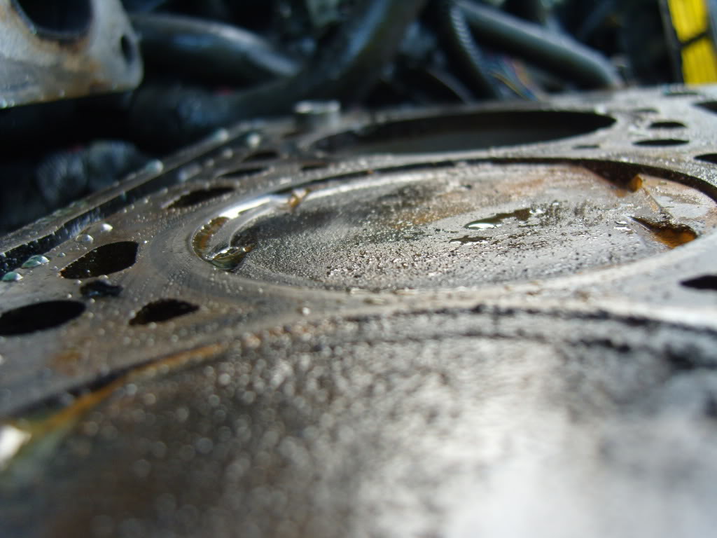

Pic of the head

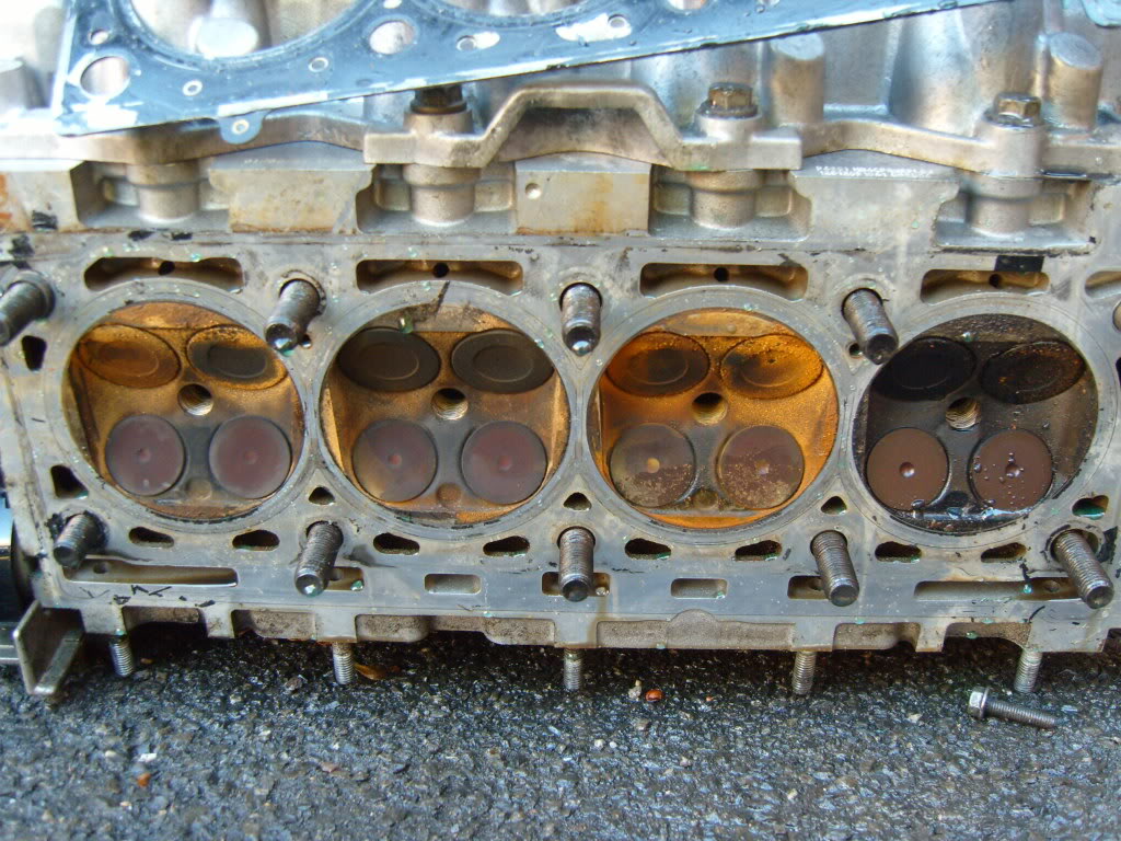

Then whilst trying to get it to tdc i noticed that one of the con rods must have been bent as it didn't raise as much as no.3

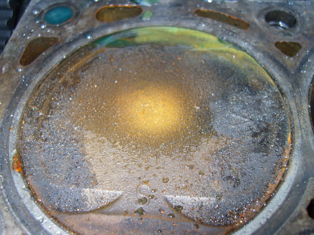

Pic of the hot spot on the pistons:

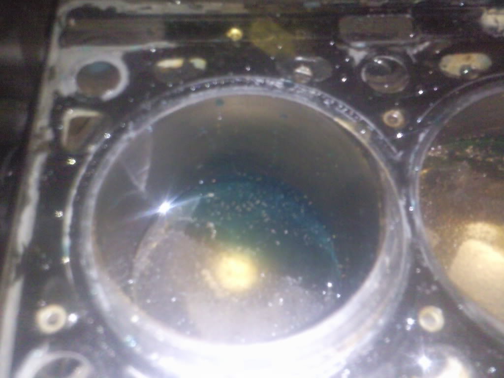

Then i noticed this!

Exactly, the little end of the rod will be moving around on it like a ho. EXACTLY the same as what I did to my Corsa!
