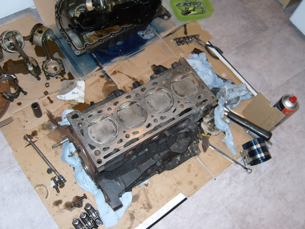

coupe of days later i started the strip down.

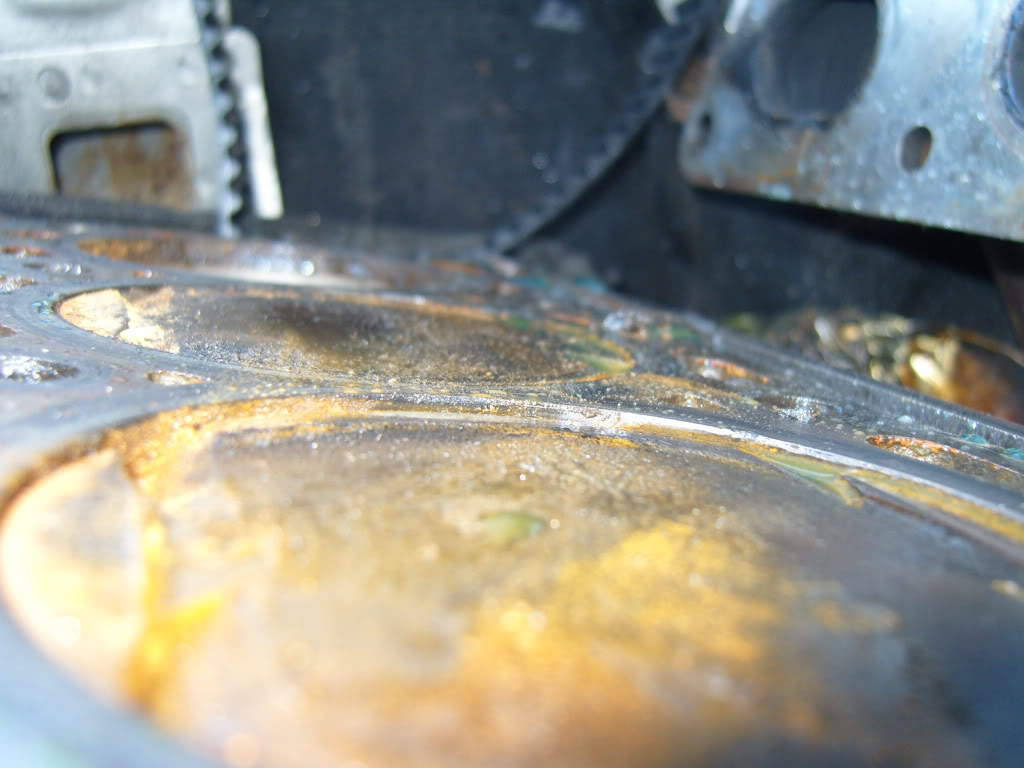

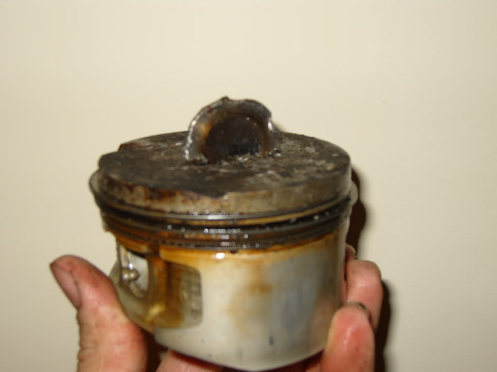

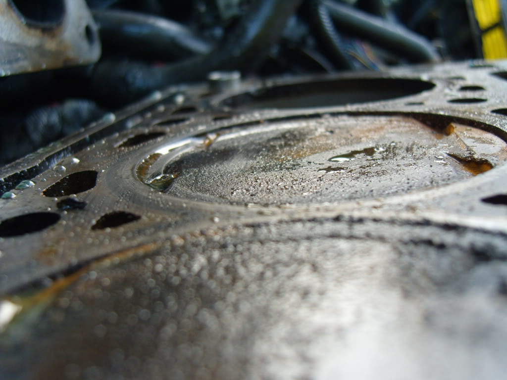

Found a bit of the head had broken off, but didnt believe that would have caused the problem i had. it was also very hard to trun over.

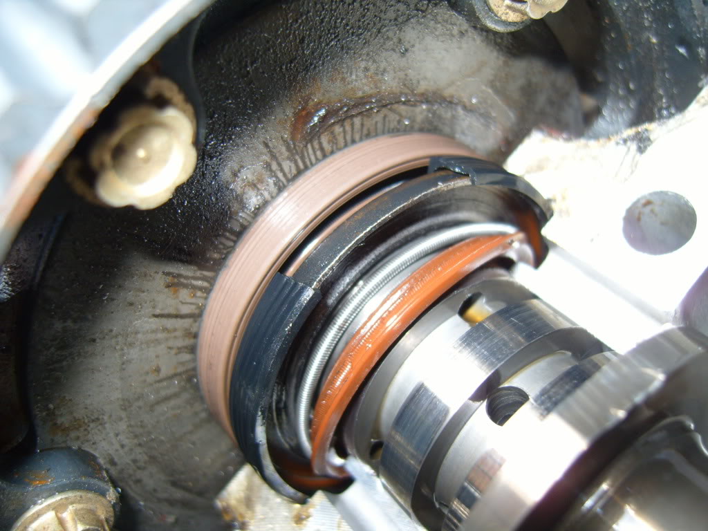

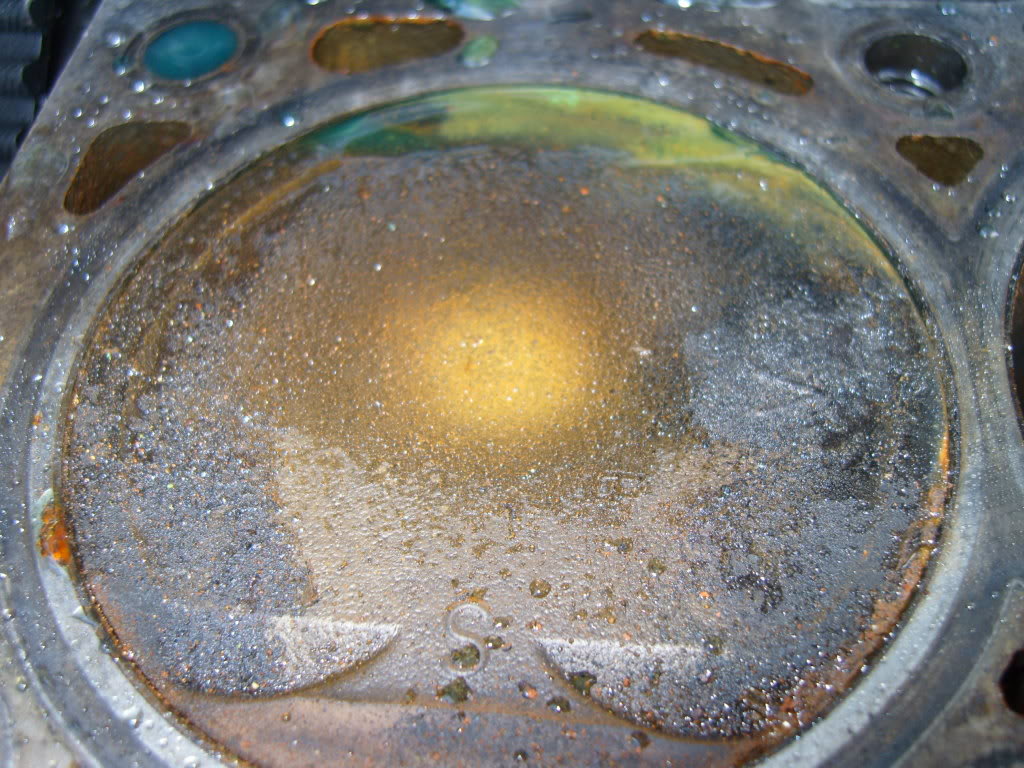

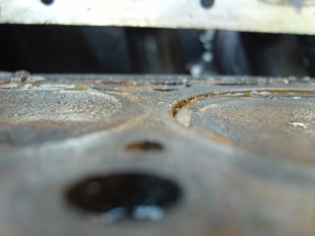

i discovered hot spots on the pistons, a split oil seal on the camshaft, and what appeared to be a bent con rod:
followed by this discovery.
http://i432.photobucket.com/albums/qq49/dunlop172/th_SS100017.jpg

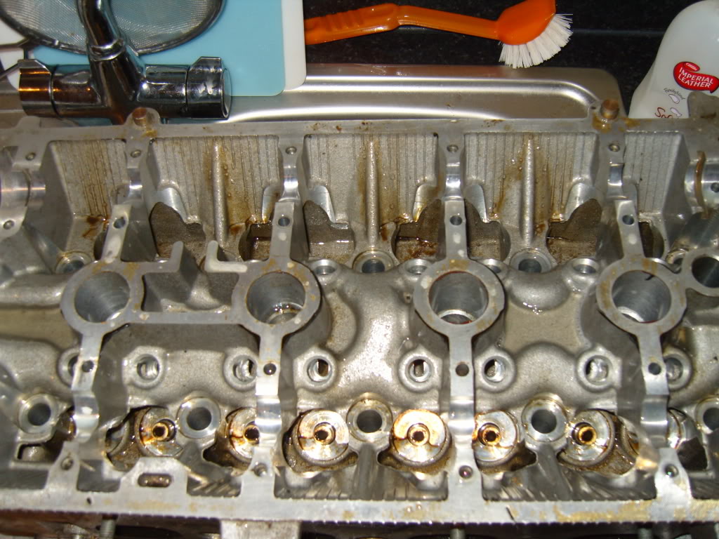

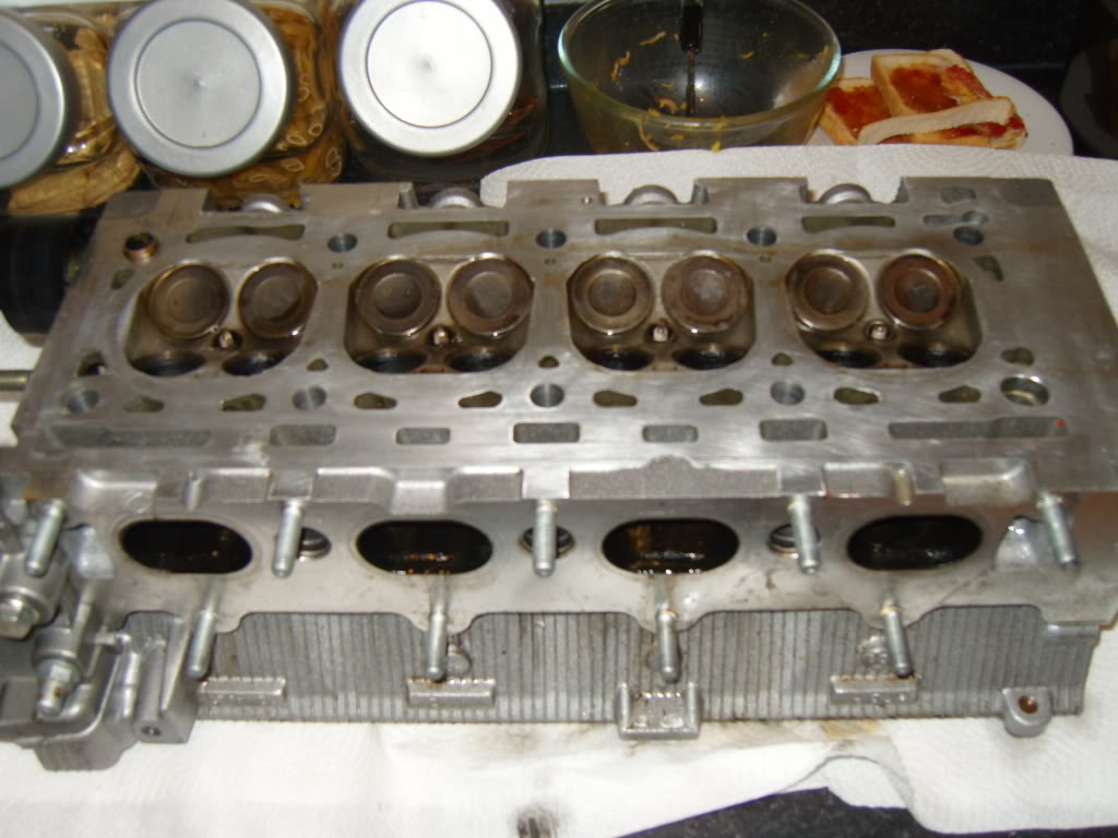

New head build up with new valve stem oil seals
and valves lapped in:

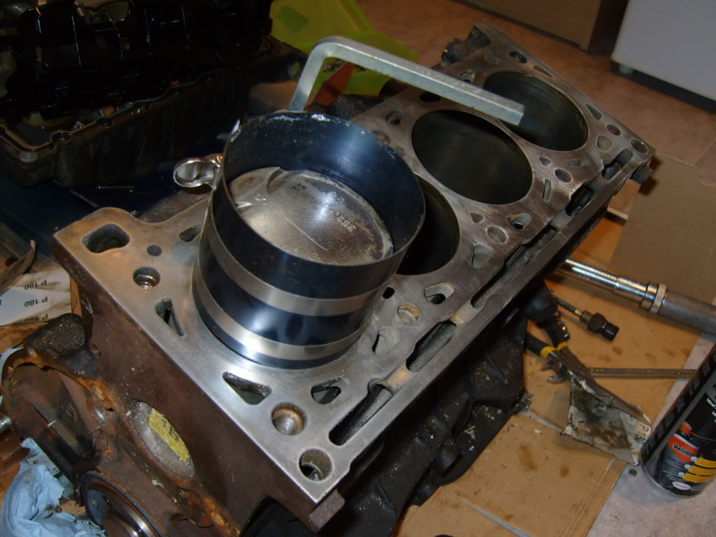

old pistons out:
lol
my pre-prepped new ringed pistons going in:
awaiting assembly lube and big ends before the crank can go in.

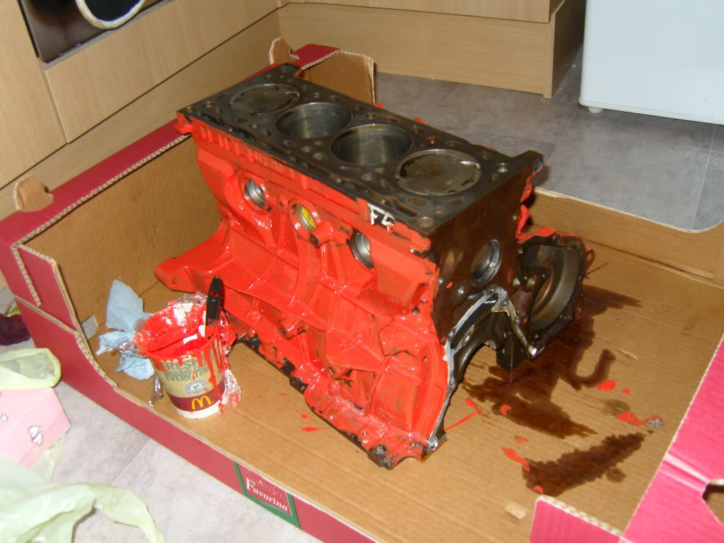

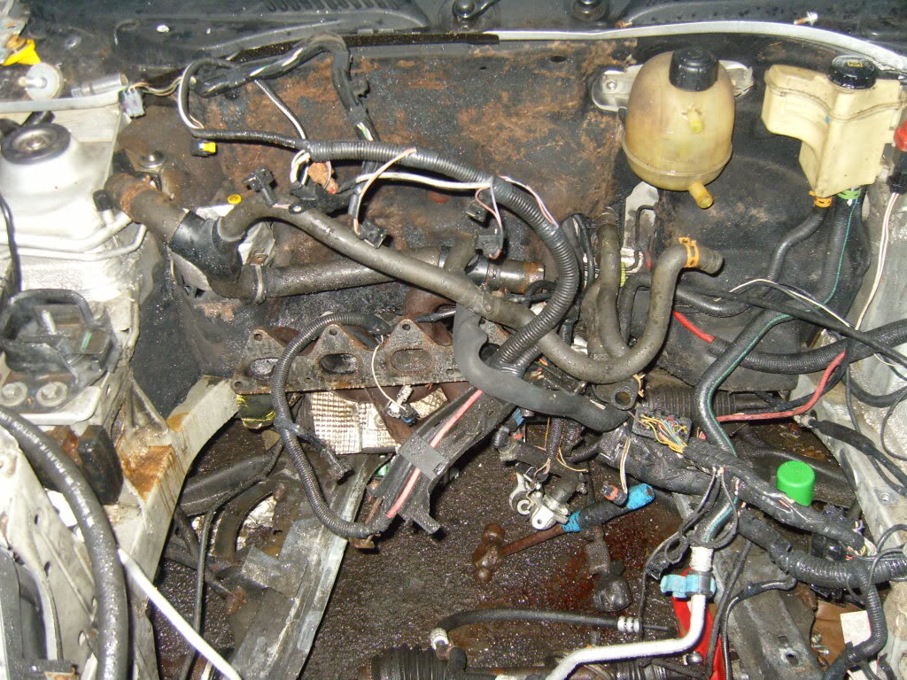

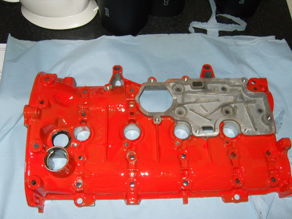

slowly got a few more bits done, mainly paint today. inbetween having to cut the sump off my old one as the bolts are rounding :(
Pics:

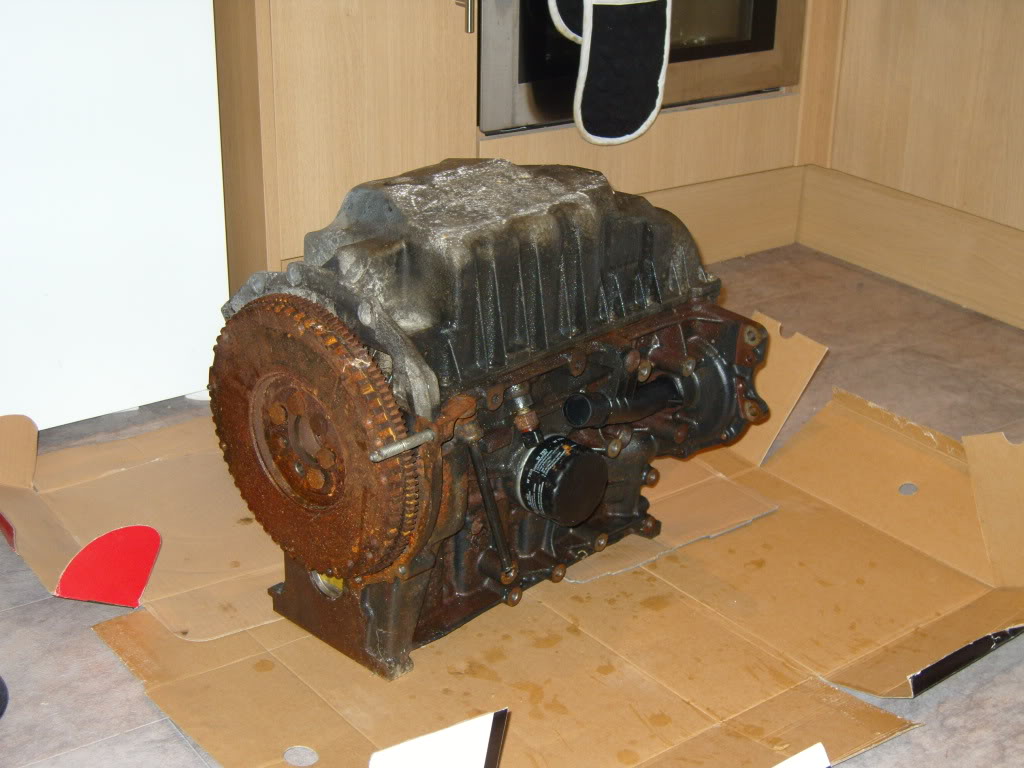

engine out:
Painted rocker cover:
block
