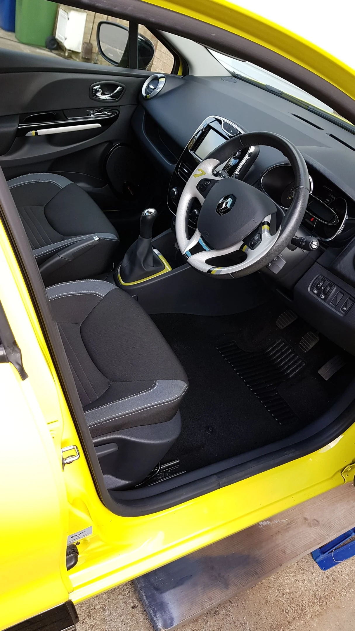

limited edition Le mans (check the hideous steering wheel)

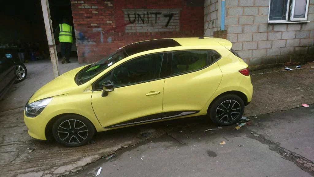

This is how the car was when we turned up - look at the front wheel:
The owner didnt have a clue about cars and had tried to fix the car himself by replacing the airbags and possibly the pretensioners. The car wouldnt start for him even after some mates of his had spent the weekend trying.
After a thorough going over the damage was the wishbone was bent, archliners were off the car and some small odds and ends that needed tidying up.
I didnt want to buy the car unless it started so concentrated on that. This is where Joe works his magic. Joe connected Clip to the car, diagnosed all the faults and reset the Airbags , fuel inertia cut off and various other things. We had troubles with the car battery but after a bump start the car fired in to life. Joe honesty is a fooking wizard with clip!
We drove it round the block and it seemed fine, the steering wheel wasnt straight and the car was veering a little but drove safely. I bought it and paid the man asking price. I didnt want to haggle as at that point it seemed a massive bargain as it was.

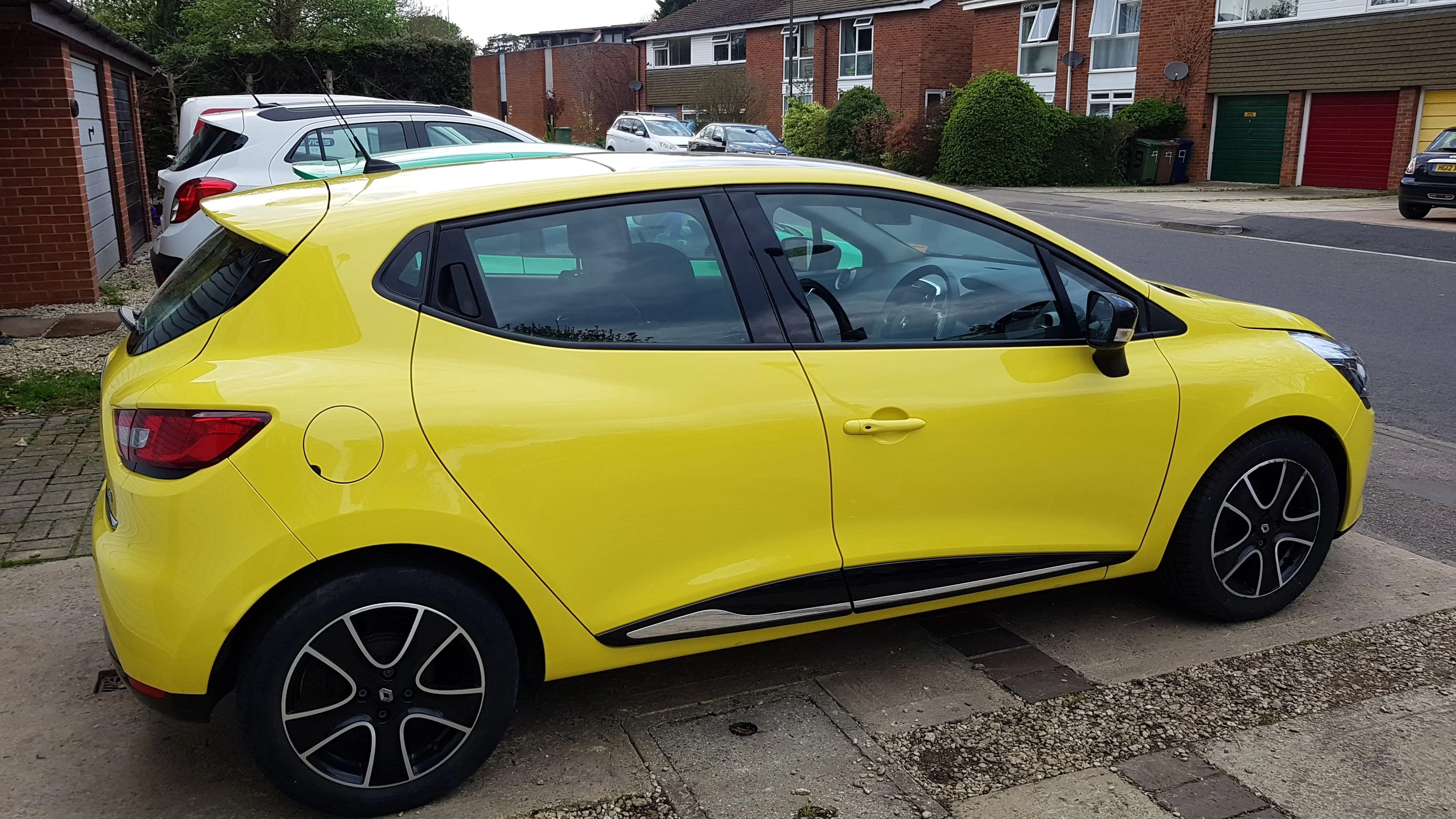

We taxed it and insured it and Joe drove it back to Oxford for me. I got straight on to Ebay and bought a new subframe complete with wishbones and ARB for £100. Renbreakers on ebay are amazing and have bought a good few things off them. They arrived and the next weekend i set about replacing them. Not the easiest of jobs on axle stands on your own due to the weight of the subframe etc and having to hold the subframe and stick the bolts in etc. Got it all done in a day though and the good news is the wheel was now central.
I then carried out a full service - oil+filter, Airfilter, coolant change, pollen filter. I also spent this weekend cleaning the car and restoring the paintwork as it wasnt very vibrant or shiny. Took it for an alignment and 2 new front tyres and it now drives perfectly!

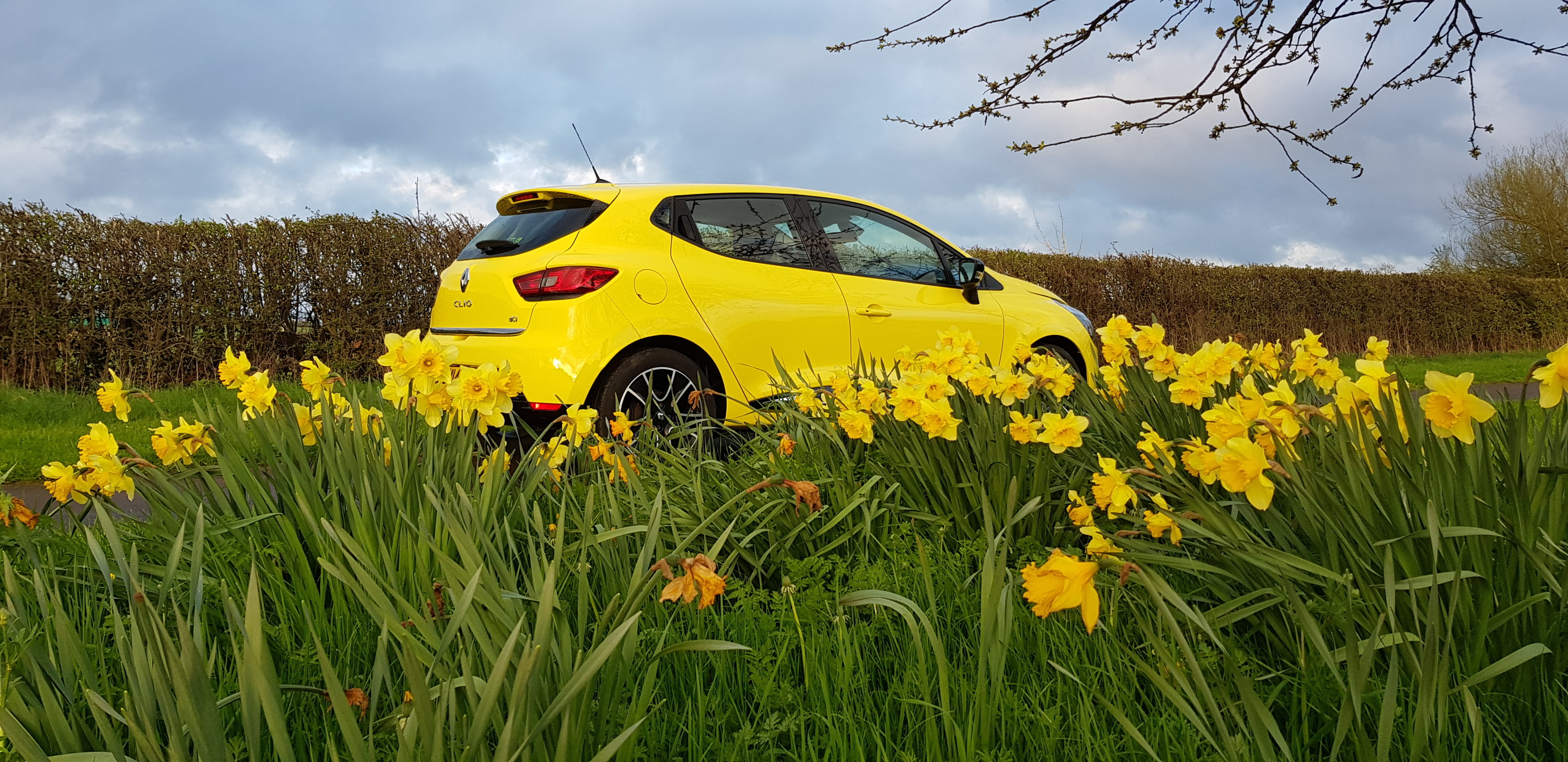

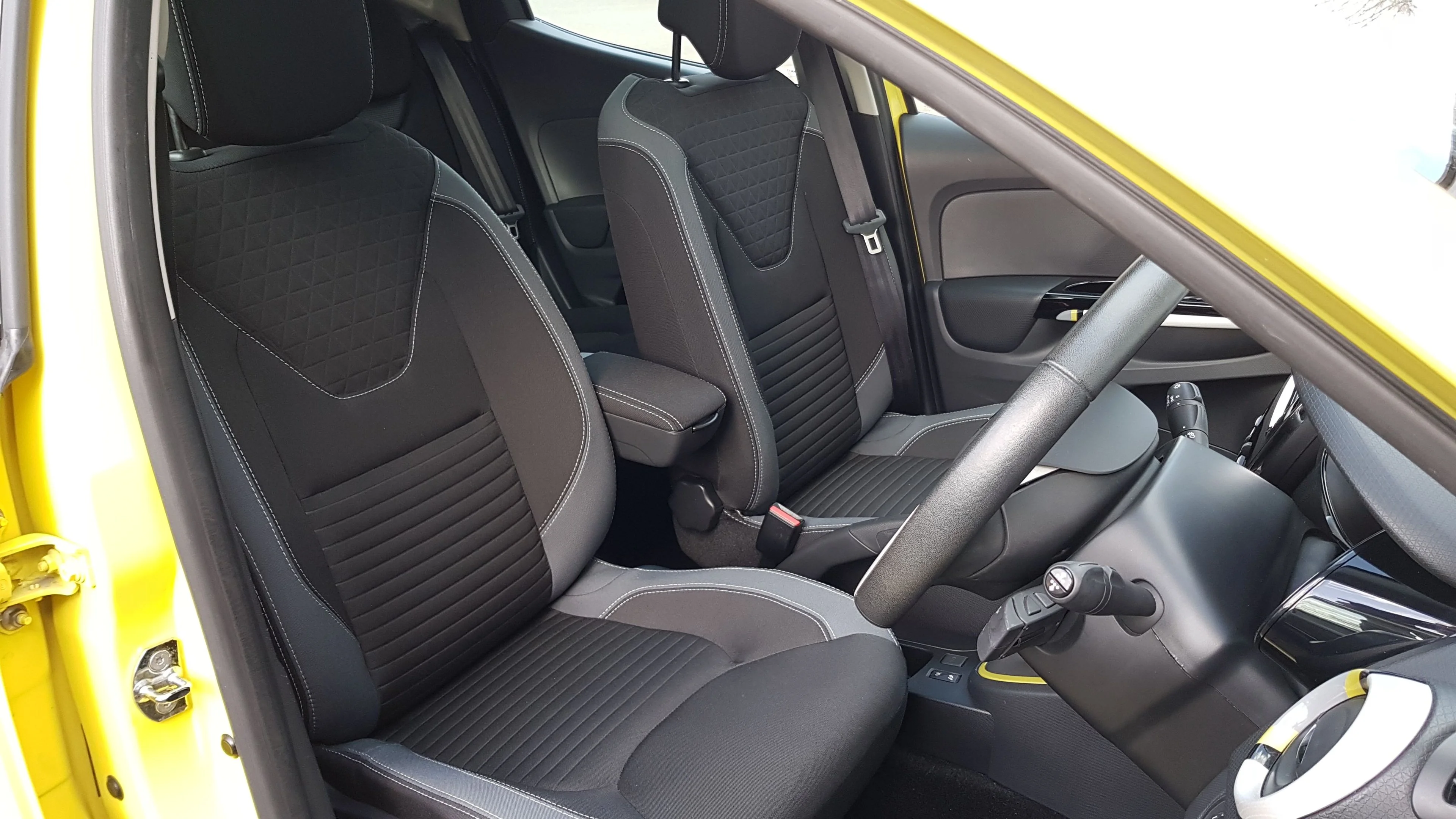

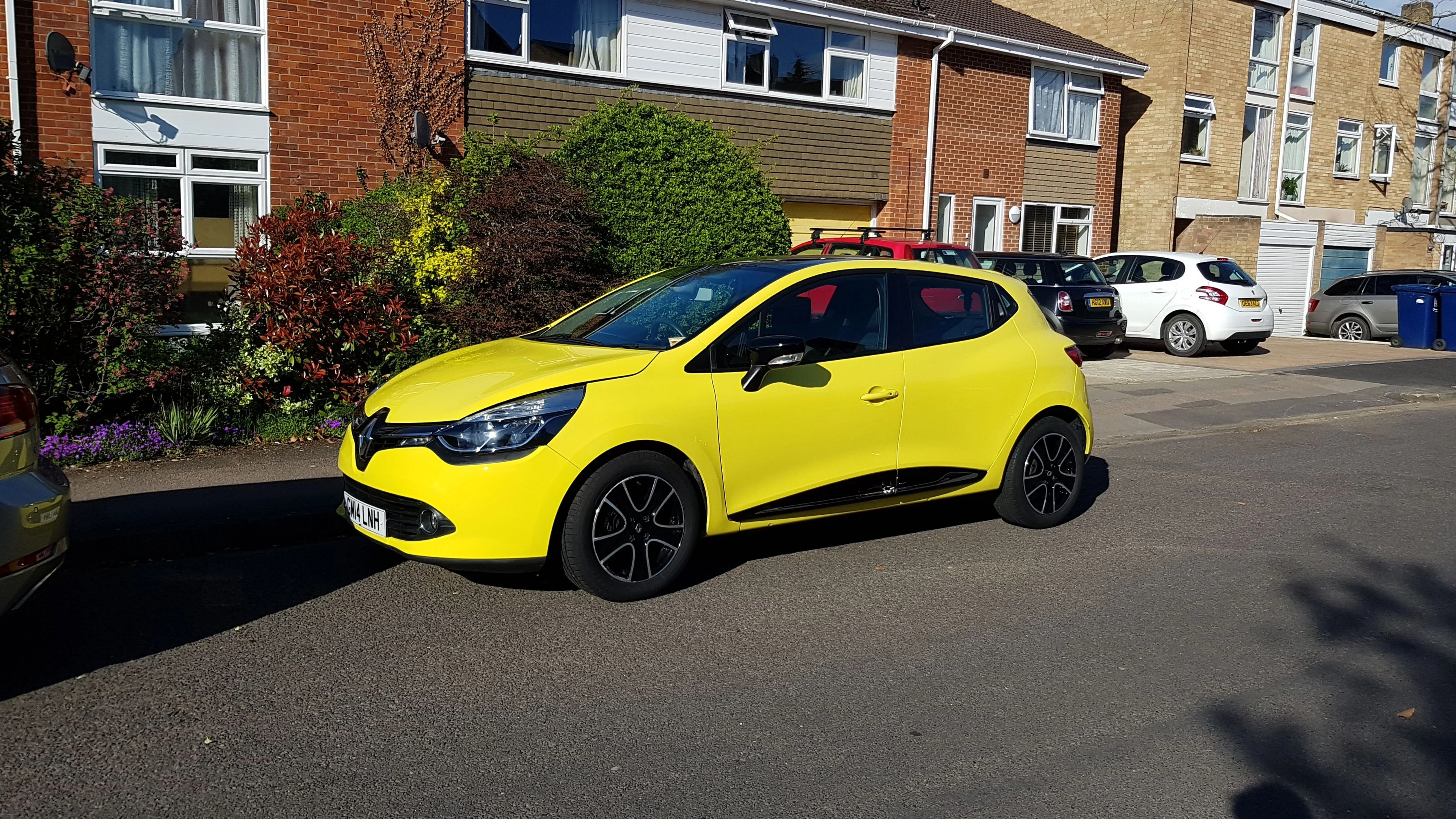

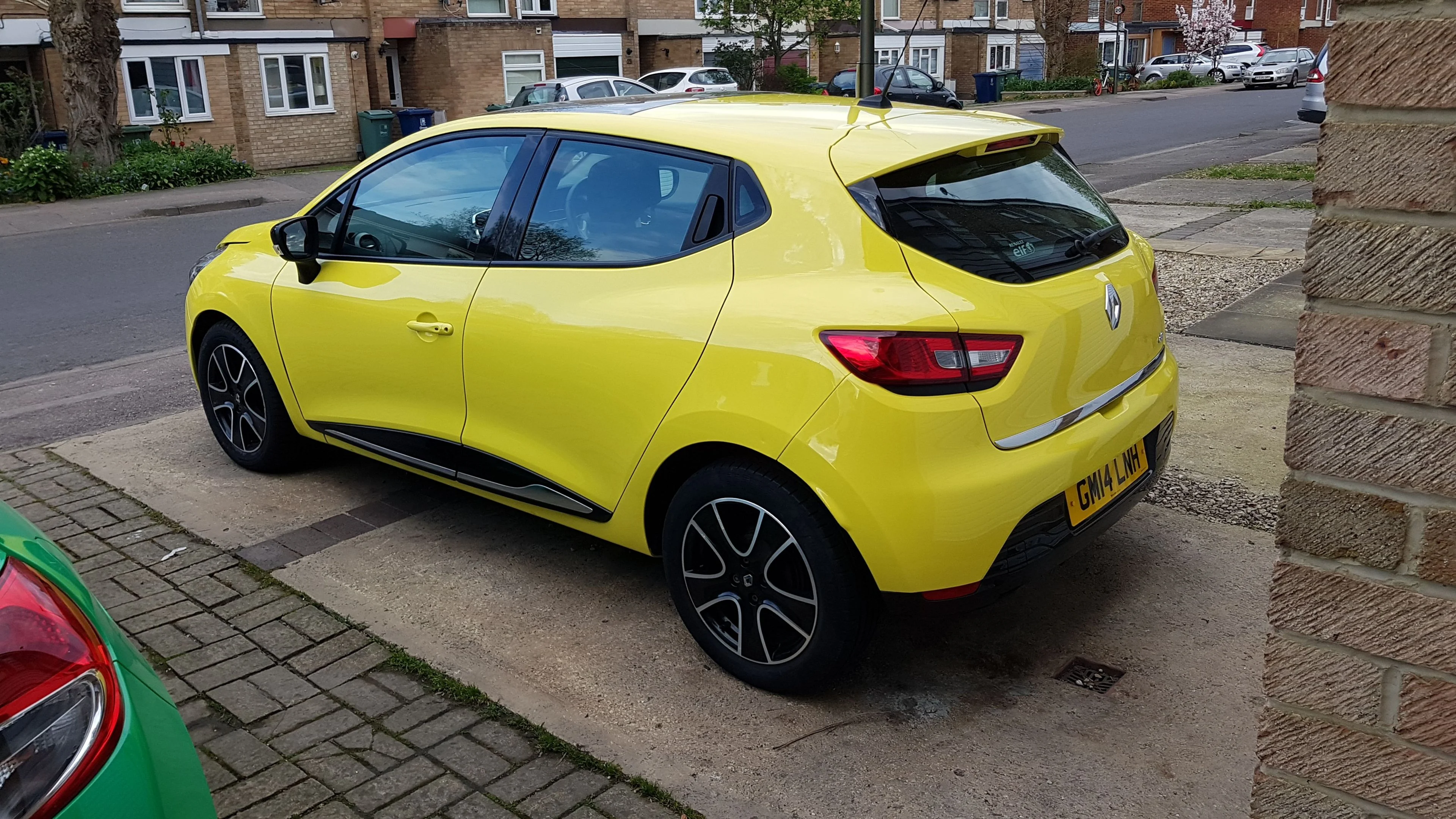

Here are some pics of it now, I reckon it looks pretty good, the black pano roof has been lovely in the sun, its comfortable , easy to drive, no loud exhaust so really quiet, soaks up bumps so much better than my other clio RS's. Ive probably saved just under £6k buying this.
First 10 minutes of driving this back felt like driving the mk4 edc, kept trying to go for the paddles to change gear managed 64mpg even with the wheel that far back in the arch, but it was lovely to drive!

That transformation from the first pic to now is crazy! Expect nothing else from you Gus.
Would never be able to tell it was a category car. Who cares either for that price!
Is it bad that I kind of like the steering wheel... Does the white bit pop off? Would look good a gloss black or anthracite!
  • Like
Reactions: Gus
Not abad idea Louis ! Might try and see if the plastic fascia bit bit pops off. Perhaps have it dipped in carbon or resprayed.
That looks like a different car in those pictures, great work and an absolute steal!

That's a steal and perfect for munching the miles. My Mrs has the edc dci and that's sat on 62 mpg after 28k in 2 years! She doesn't reset the trip and doesn't use cruise (typical woman!) so it's not too bad. We've had no issues with it at all and it's only been to Renault for a recall on the windscreen wipers. I would think the plastic part in the steering wheel should come off as ours is black.
