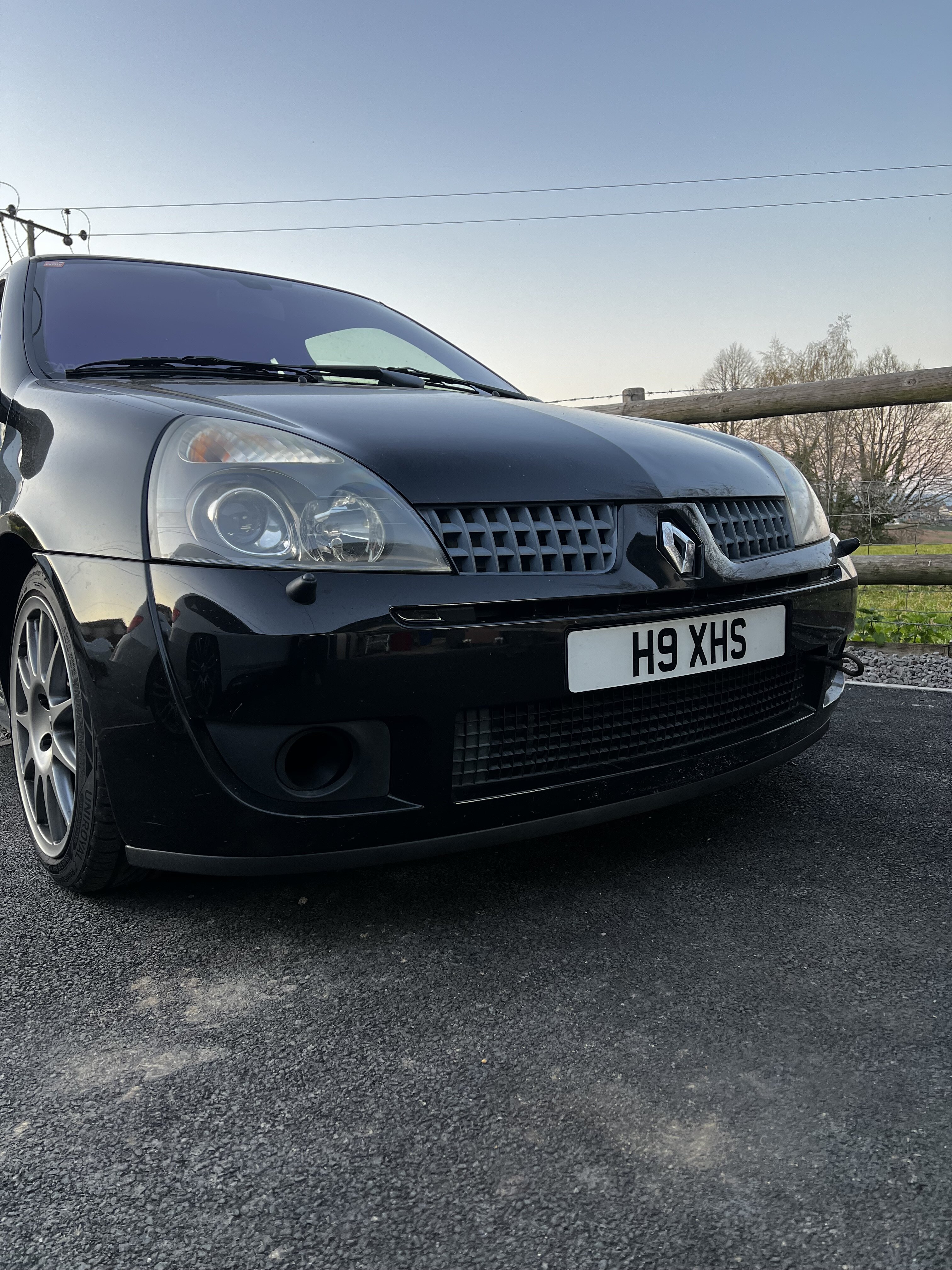

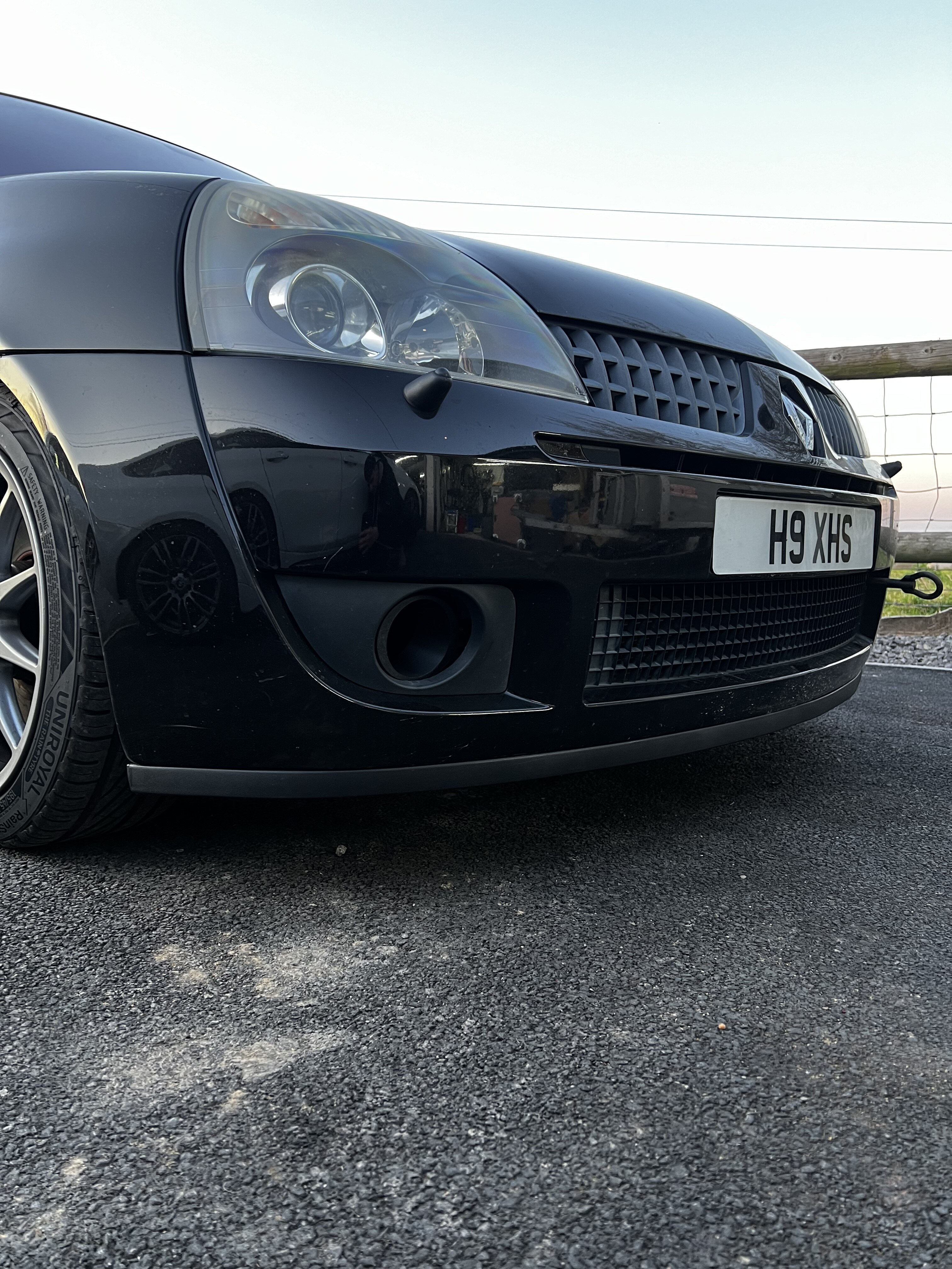

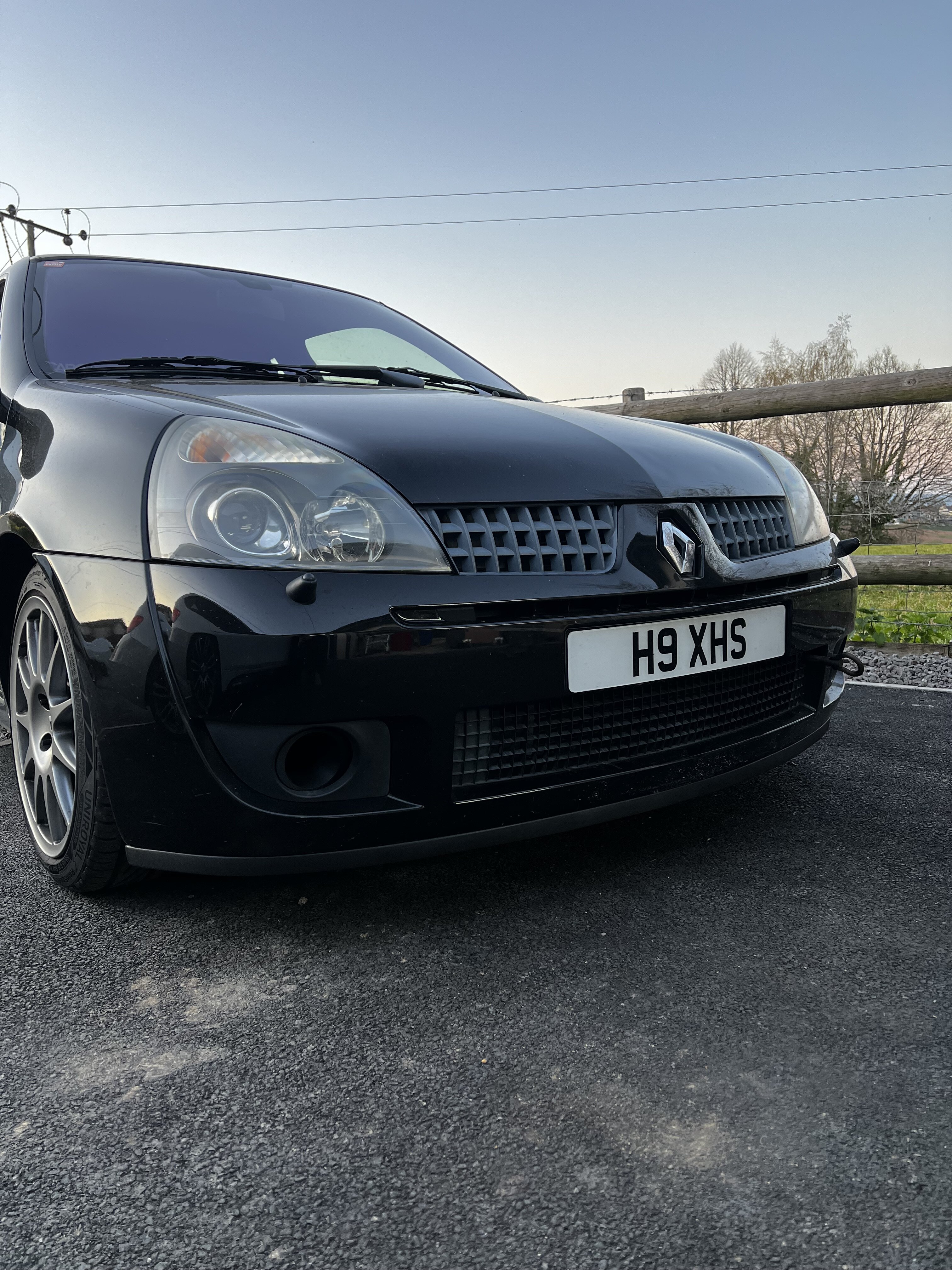

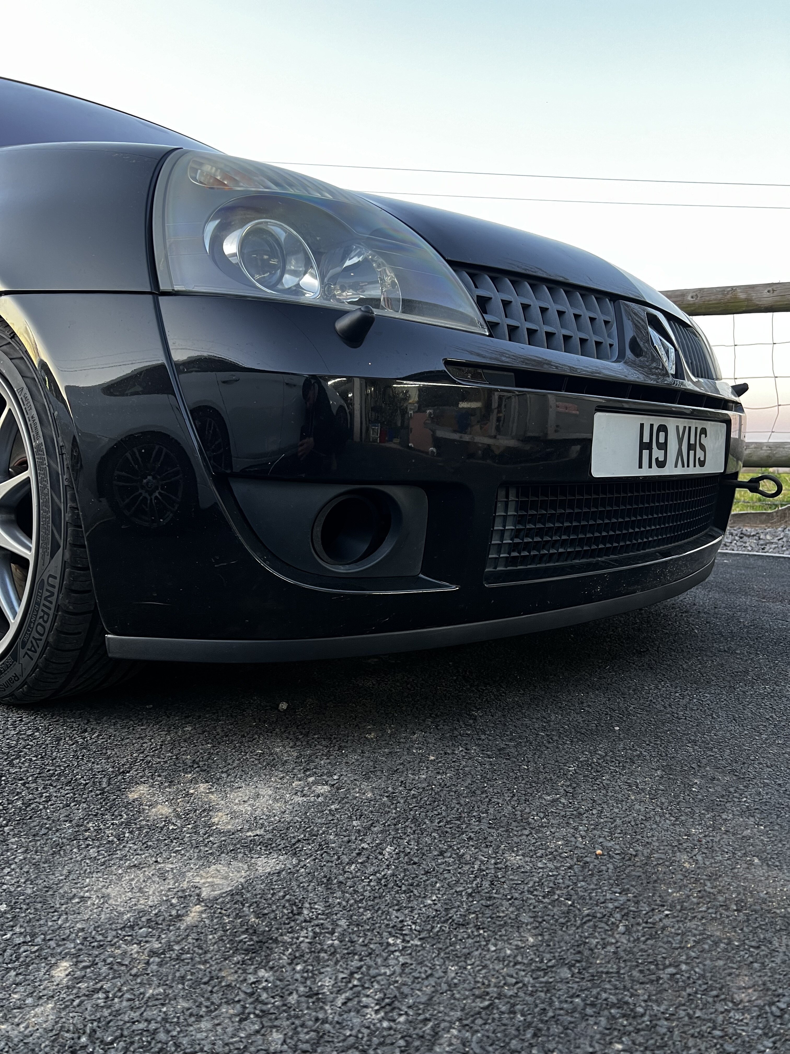

Yesterday evenings job, install the £9 fabia splitter I’ve had lying around in the garage for a couple of months. Easy 10 minute install & cheap - looks loads better.
