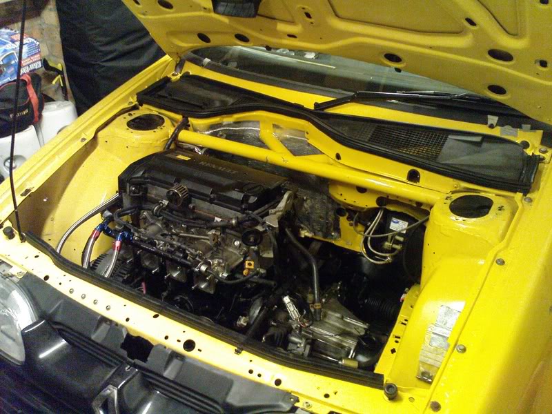

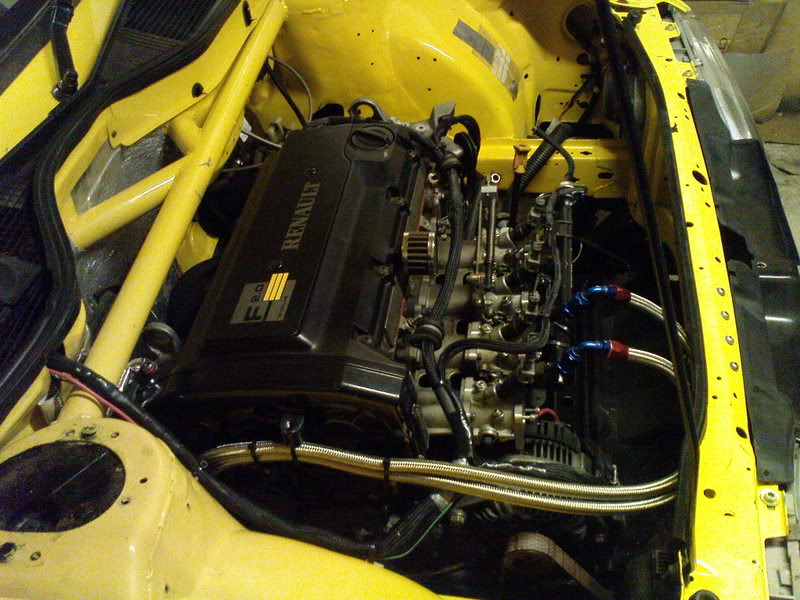

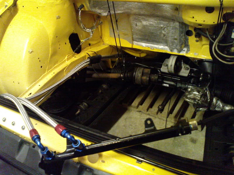

We had no choice with having the swirl pot and fuel pump in the spare wheel well.Expensive when you start buying 12m of the stuff.:eek:

Swirl pot and fuel pump are sealed,any fuel lines inside cabin have to be braided without any joins,
