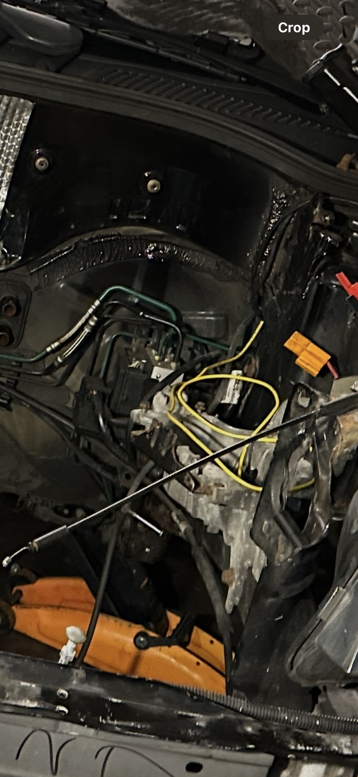

As @Louis says it’s unlikely to be one to the MC.
Best pic I can find is below, but the lines come away from the MC behind all the heat shield and sound deadening stuff and into the ABS pump. They then go off to each wheel from there. If it’s leaking NSF then it’ll be that section. I can’t remember if there’s another joint where it goes into the arch or not now though.
