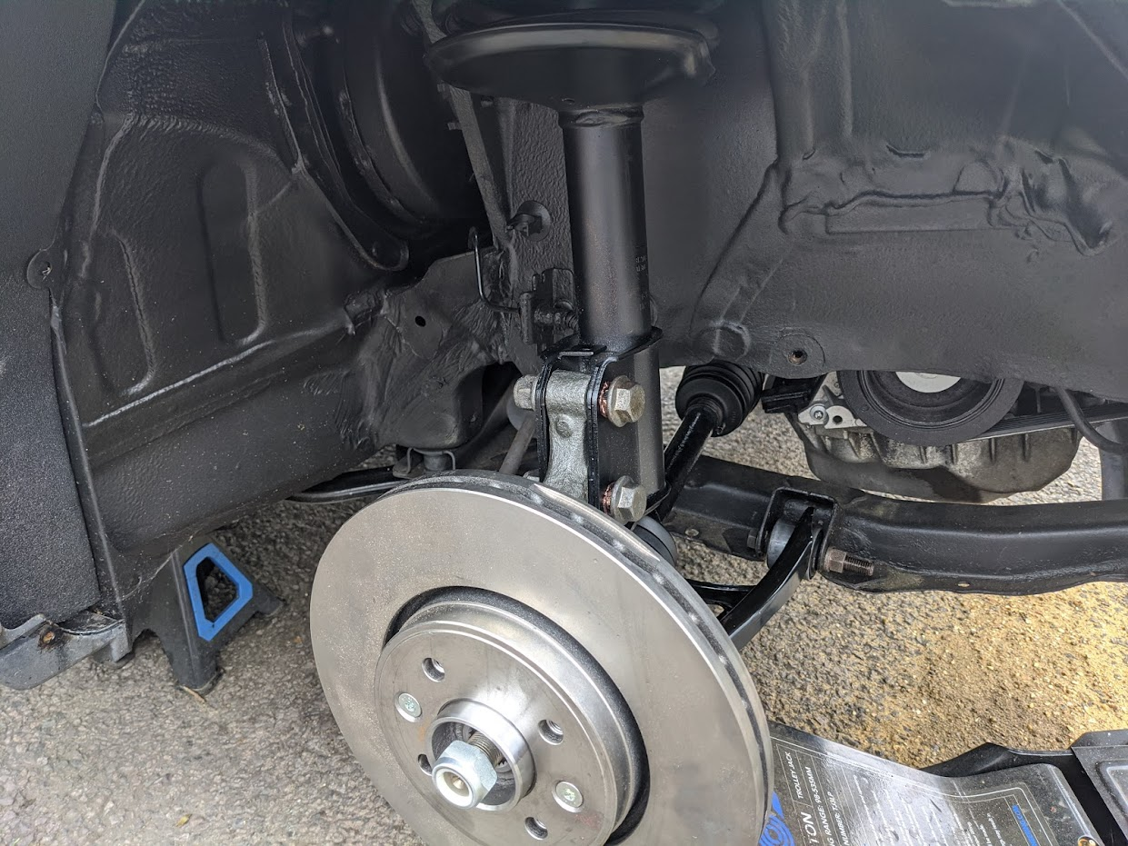

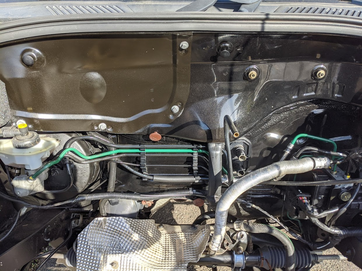

I'm only half joking. If you take the drivers side wheel off and liner you can get a good look at it, enough to give it a bit of a clean up:
The half not joking:

Had a look yesterday and quite a bit of rust on the bottom of it. Will def rust treat it this weekend. Can access half of it easily by taking one clip off the liner and bending the liner back. The inside half I'll have to get at from underneath. Glad the MOT highlighted this as it def needs treated. MOT also highlighted slight rust on the shocks which I'll also treat, but nothing like as bad as the rust on the brake servo.

Looked worse than it was, surface rust, looked like from fluid spilling when filling. Not easy to access but managed with a small wire brush, coat of kurust and a coat of black hammerite. Should last longer than the rest of the car now.
