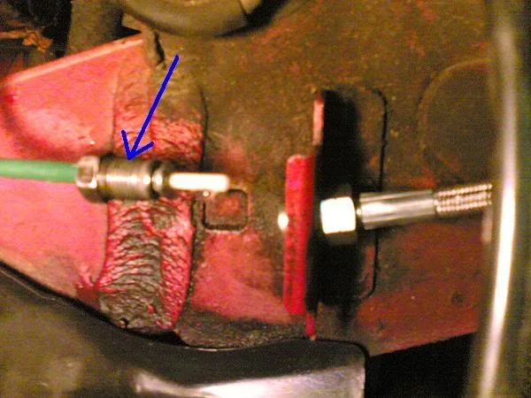

Fitted the better goodrich lines this morning and bled my brakes. Got to the last one and the thread on the union is buggered. Ive tried everything to get it to screw into the new brake line but it wont go in. It wont go back into the old line either. I take it the brake pipes on the car are 3/16. Does anyone know where I can get a new union and what size I need as I think im gonne have to chop the pipe, stick a new union on and flare it (hopefully can do this while its all still attached).
Any help or suggestions will be appreciated.
some of the handier High St parts suppliers keep unions and make up pipes; sounds as though the car's off the road until you can fix it anyway, so you could take the tip of the pipe off, remove the union, and take it with you to whoever you can find who stocks them. might still be lucky at this time on a Sunday

pipe is 3/16.. you can get the unions from motor factors but i found a bag of 25 metric ones on ebay for like 2 pound so i bought a few bags of metric and unf
can be done on the car too if you get a flaring tool that suibtable.. its worth paying for a good one too i origionally bought a draper one which was ok but it had plastic dies which were pants and out of the countless times i used it i only ever managed to make 1 flare look nice
bought an on car one from snap on for about 50 quid and it does perfect flares every time
and make sure you havn't buggered the thread in the new pipe either.. dont want to cross thread the new one in

it's not just the thread you need to worry about - you need to be sure it has the same length/bevel to the tip (beyond the threads), too.

you cant really do it wrong mate thats a standard single flare... double flares are used for unf fittings and female unions
as for length of the union it dosn't matter as it will still bottom against the flare/inner wall of the flexy pipe
i think it depends upon the application; i've had problems before with the tip/bevel (beyond the threads) being too long, not seating properly and not engaging much of the thread (not ideal with brakes) - apart from in the thread and thread length, unions do vary at the tip beyond the thread. that's a short one but it's an easy mistake to come home with something slightly different :)rolleyes: at me)!

it would have been simpler to point out that there are both long-nosed and short-nosed unions and that, if you use a long-nosed one when you need a short-nosed, you can find that the flare butts up before the threads engage properly/at all (depends upon application).
also, talking rubbish about the bevel on the union - was thinking of the flare (jesus!).

Thanks for your help. I had trouble finding the correct union length and size from anywhere. Got home and had another go. The end of the union had flared slight from being overtightened over the pipe flare. Luckily managed to knock something up to squash it back in and all eventually scewed back in nice and tight. Went for a good drive and no leaks so I was lucky really.
