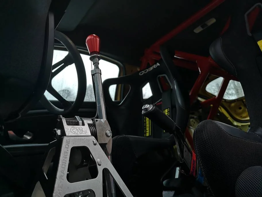

JamesBryan

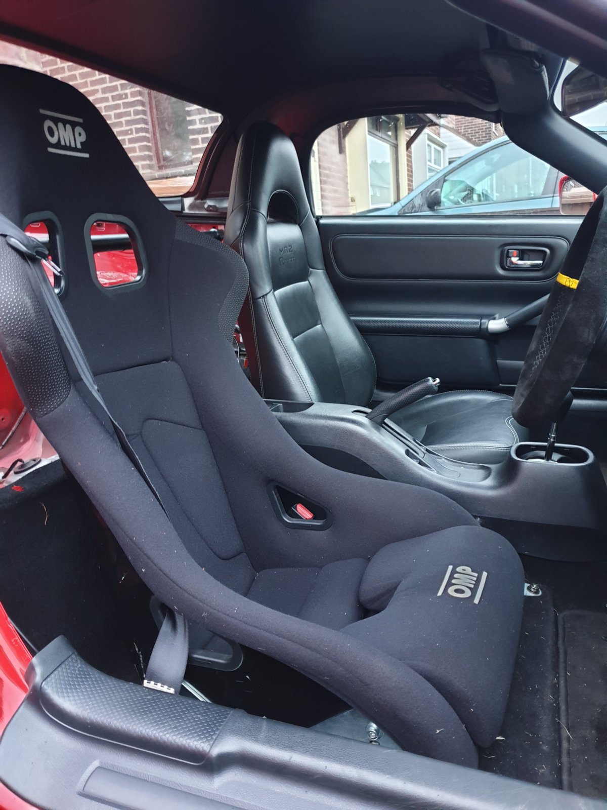

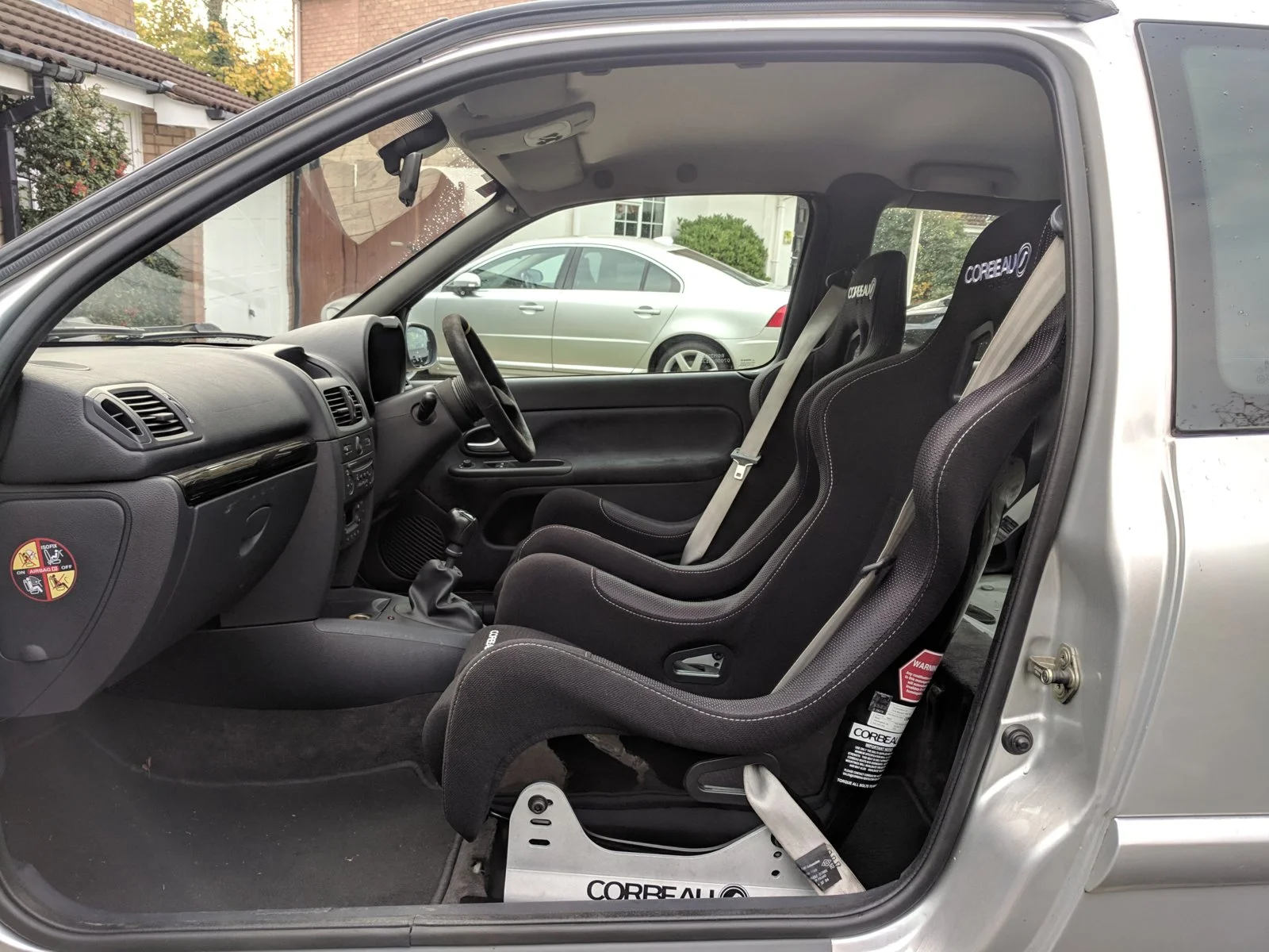

This is mine.
I have the option to go more angle though.

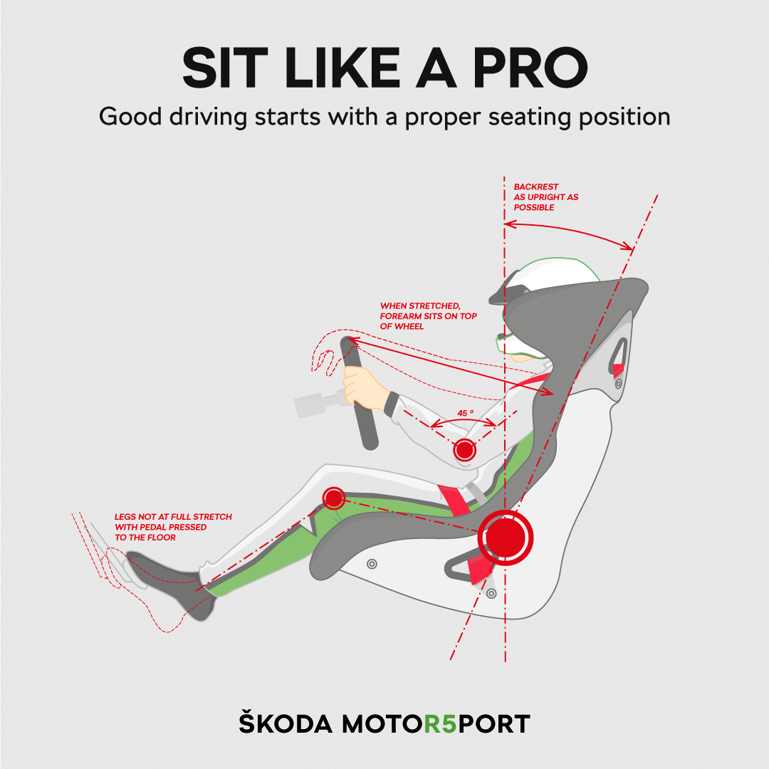

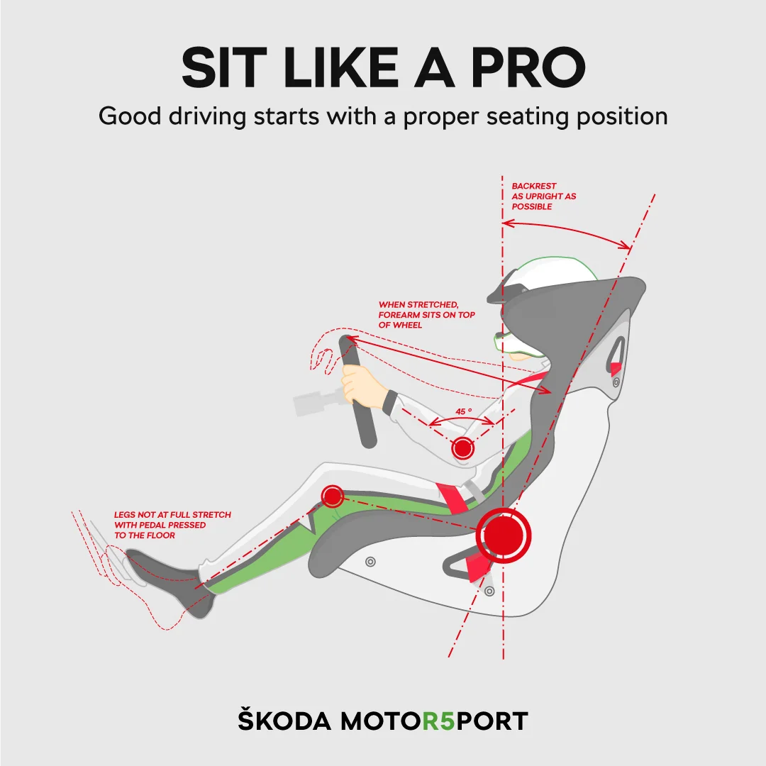

You're 'supposed' to be as upright as possible with your arms at a 90 degree angle and your wrists should be able to bend over the top of the wheel.
Like yourself this wasn't comfortable for me so I've got mine as tilted back as possible.

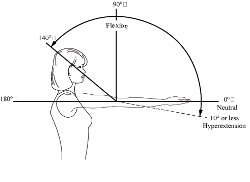

I guess that driving with the arms at 45 degrees is even more awkward. Surely they mean 135 degrees? ?
135 degrees of elbow flex would be essentially touching your forehead :ROFLMAO:
Unless you're measing with your arms flat by your sides. Then you'd be correct
With arms out, 45 degrees is about right.
Filters
Wales - South
No it's not, that's what 45 degrees is. ;)The angle in the picture in the article is more like 135 degrees.
Kinesiology and flexion studies would tell you otherwise.
What they're depicting is elbow flexion, which is measured in reverese essentially...0 degree being out infront of you 180 degree being behind you.
Filters
Wales - South
I don't know expensive words like that. ? But in that case the drawing in the attached article is wrong.
It's actually correct :LOL:
Take the red axis point for the elbow and apply it to the verticle line on the diagram in the article, then follow the elbow line to the hands (remembering 0 is hands straight infront of you, 180 degrees is arms/hands behind you) and you get roughly 45 degrees.
The diagram below explains flexion, to some degree...:ROFLMAO:
1418461
The picture doesn't show any relation to the vertical line? All I see is an angle saying it's 45 degrees, and looking like 135 degrees. This is my last comment about this, as I don't want to ruin a thread about a good subject. ;)
I will be installing my seat in my car soon, and I'm interested in what angle I will get it in. If I remember correct, I had them pretty upright in my old G40.
Doesn't it? Pretty sure there's a big red vertical line.
You're right though, it is a good subject....for those with a basic understanding of maths and trigonometry ;):ROFLMAO:
1418512
  Clio 172 Cup
Great. I saw that Skoda picture and I seem to pretty close to it's recommendations.

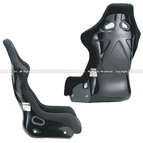

Lack of lower back support is a major problem with a lot of seats I see - a flat bit of board for the backboard? Really? Because our spines are a straight line, are they??
Racetech seats are the only seats I've seen that actually resemble the human form without the need for extra cushions.
Very interesting to see this as the biggest problem on paper I have found with my seating position is nothing...? Yet after 20 mins I find my right ankle begin to ache. I'm expecting this is due to the fact that I'm using the car in a more casual setting out and about enjoying it with a lazy positioning on the peddle. Which is causing this. As to being in the seat on the track day moving from accelerator to brake will prevent this from happening as opposed to being sat in the seat keeping the foot at a set position for longer periods of time in a more casual driving style?
Has anyone found this or have some tips or things I need to change? After searching I found the same subjects describing that fig above and when in the seat I'm sat bang on in this position. If I am to pick a hole I could tip the backrest back a hole as mine looks more upright than that of the picture.
