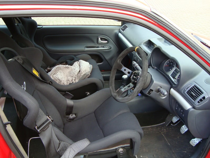

I still have the rear seats/belts in mine, as well as fixed bckets/harnesses, so if a passenger can get into the rear they're more than happy to use them ...
no you dont! (well not in that picture because i can see the bare metal of the rear!)
usually you mount the harnesses to the rear seat belt mounts, so how have you got around this??
