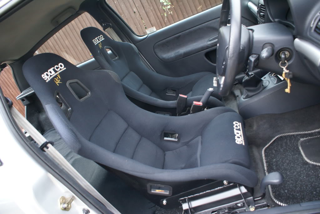

Like this.........?

You can keep most bucket seats with standard seatbelts. You can also get clip on harnesses that you can have in the car but not so you have to wear them. You will have too look into it but harnesses arent hard to fit if the fittings are aready there.
If you put the seat on sliders, you can still get access to the back. This will be an extra for you to buy on top of subframes.
