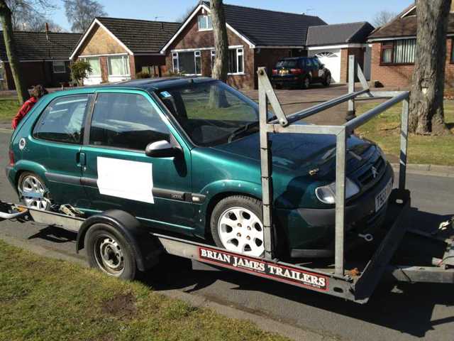

We made the 3 hour journey to Scotland to collect the car, as soon as I saw it I knew it was a good buy.
The guy was very friendly, he gave us some spare parts and panels FOC which I was very happy about.
Here are a couple of pics of the car after we loaded it onto the trailer
I'm made up with this to be honest, I have some plans which will get the car ready for track and fingers crossed a decent little runner.

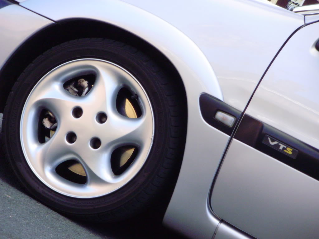

I had either Saxo VTS, Speedline Chronos or some 15" steels through the course of the time I had with the car.
They're a tight fit, even with 15's.
Looked best behind VTS wheels IMO.

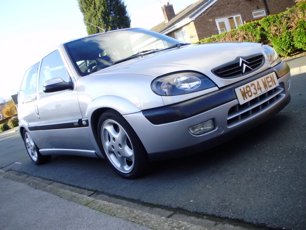

Much, much better than standard VTS brakes mate, I imagine your VTR ones will be even smaller than the VTS ones too?

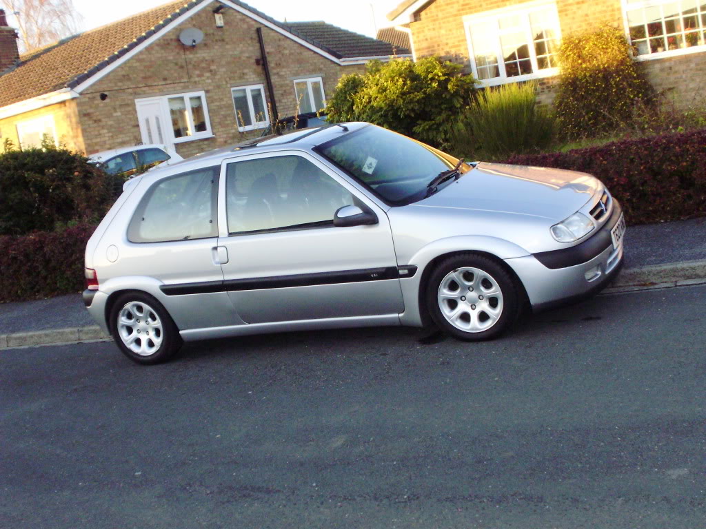

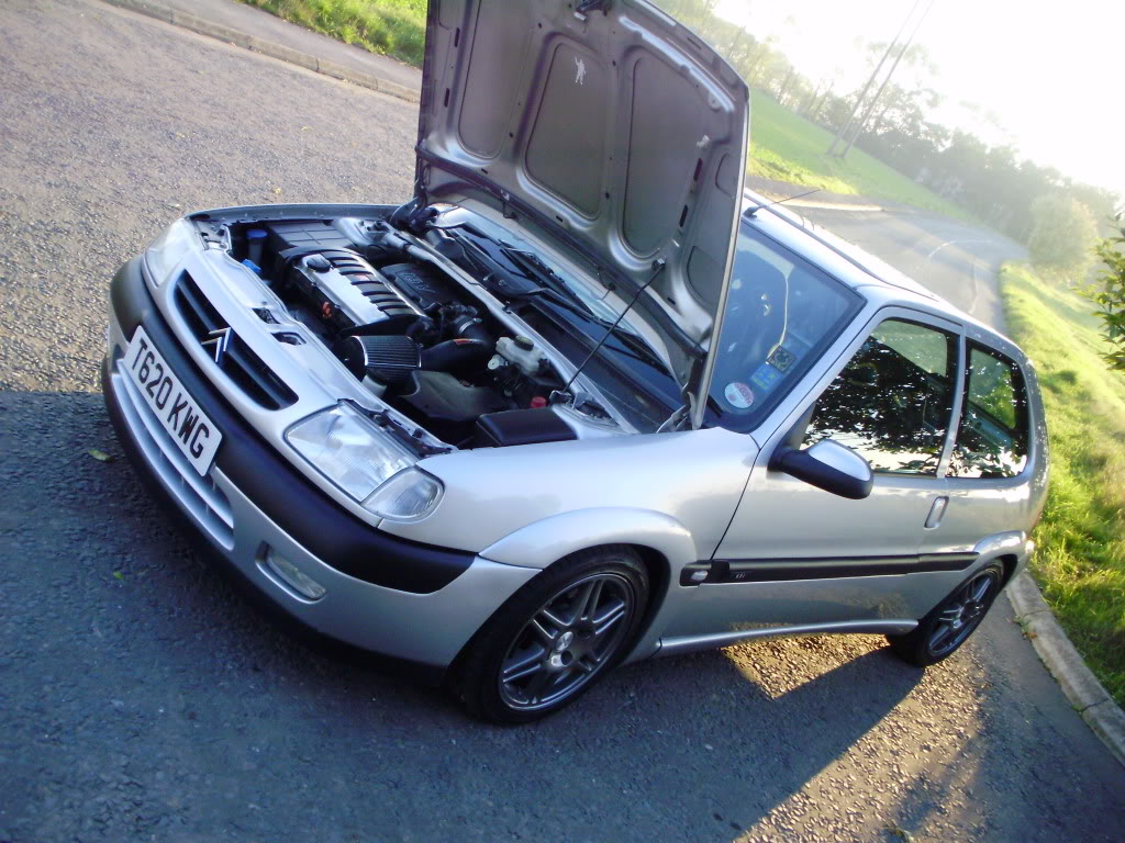

What happened to me was I had a Mk1 VTS with the 283mm brakes, and then I bought a Mk2 which was standard. I couldn't believe how bad the brakes felt in comparison so I swapped the brakes over. Standard lines and master cylinder.
My mk1
Mk2

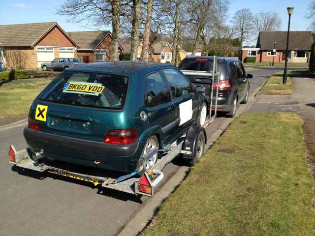

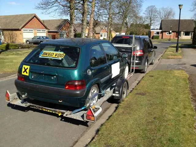

Today, after having to wait a very long time due to the house move, work etc, I was able to borrow a trailer and bring the car home.
The battery was dead as it had sat untouched for 6 months almost, but I got a battery charger as an early 21st present so I managed to sort it and it started straight away.
We loaded the car onto the trailer and headed home.
There are a few bits I need to sort very soon. I need to get the undercarpet sponge out as it's wet and stinking the car out. But more importantly, I yanked the handbrake up and it snapped the cable :/ so I need to buy a new one ad fit it.
