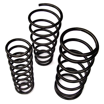

This is a shock:
This is a spring:
I actually misread that and saw springs rather than shocks. I do know the difference between the two hahaha. :)
No just me not reading properly haha.

Shock absorber is just another name for damper so I have no idea why you would think it's specifically called one not the other tbh. Is that just a cs clique thing or something?
Nope don't think i'm part of any Clique, well not had any formal membership card.. I just got nagged repeatedly by someone for calling them "shocks" so now share my pain.. thanks
They are known as shock absorbers or dampers because they absorb/damp out shock loads from being transmitted from the road wheel to the car, there is no right or wrong between those two, both perfectly acceptable industry standard terms.
