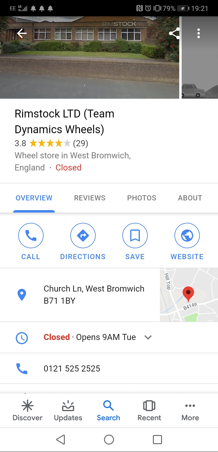

These guys were at one time doing a set of pro race for like 330 delivered. They are or were the UK suppliers so other companies would buy through them. They also supply them for the ktec racing championship, or did.
Pretty sure they guy to speak to was Justin. So give them a ring. I would pick these alloys as imo they offer the best vfm.
  Peugeot 207
Pretty sure they guy to speak to was Justin. So give them a ring. I would pick these alloys as imo they offer the best vfm.View attachment 1413463
I’ll definitely ring them tomorrow. At the moment I’m favouring the Pro race 1.2 with Nankang semi-slicks.
