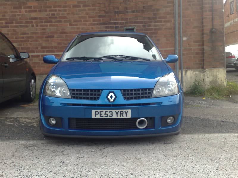

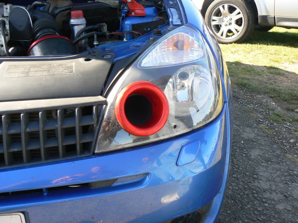

Unconventional and ugly, but I'd guess it's one of the most effective.

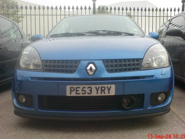

Before spraying:
After spraying:
iirc, if you have it in the fog light hole for MOT purposes you have to remove the other fog light?
With these CAF, especially the pic by Inferno, surely these will collect crud, grit, leaves, water/rain, insects or a small bird etc and therefore clog up the filters very quickly. A lot of these after market cloth and foam filters do not filter as effectively as standard paper/fibre filters and therefore more chance for the engine to be damaged. At least with the standard setup, the CAF is behind the bumper and protected from these bits and still be drawing the same cold air. If its for RAM air effect, I would still say any effect is nil.

You can clean a foam filter though - just do it often if it worries you. I see your point, but the one I posted was (I believe) a track only car, so it makes no difference really.

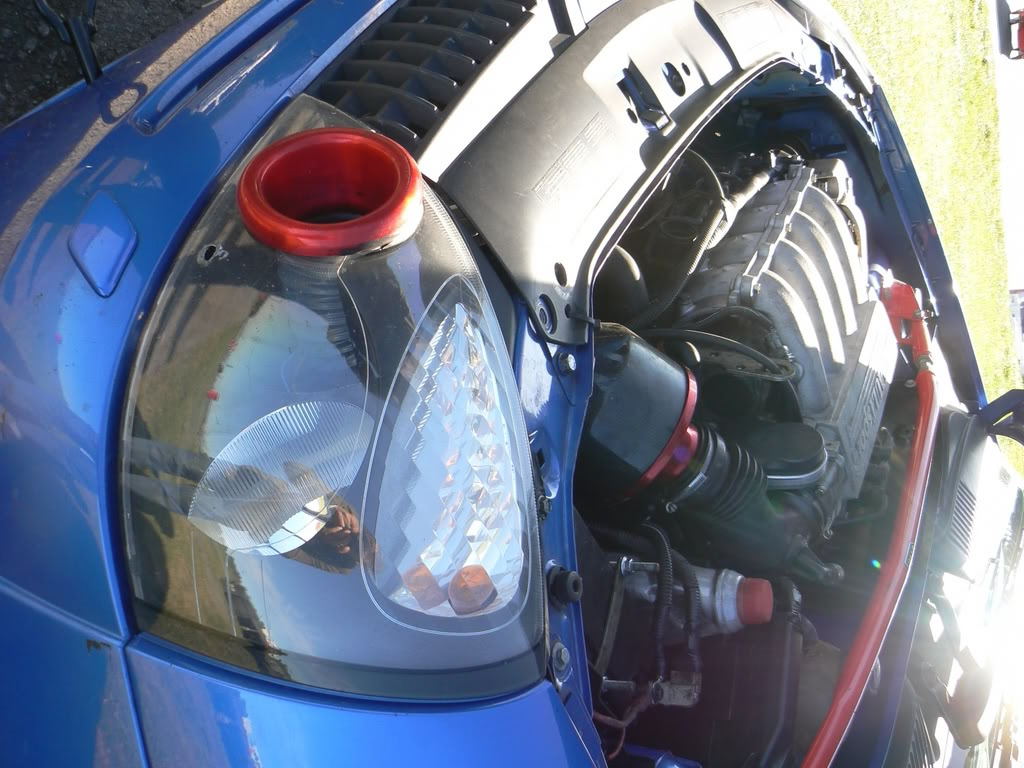

Ram effect as you rightly say doesn't come into it, but through the headlight is the most effective route. It's at the right height for lower temperatures (there is a difference between air temperatures at road level and at headlight level), and it's the most direct route for air to take to get to the engine.

You could always put something within the tube to prevent large contaminent getting in, but the liklihood is small. Cleaning filter isn't too hard though.

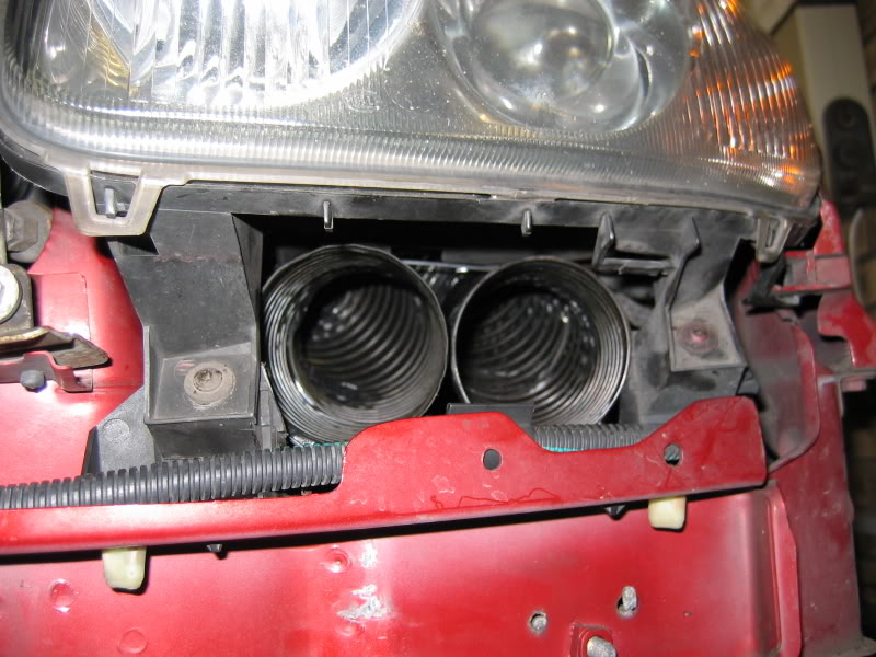

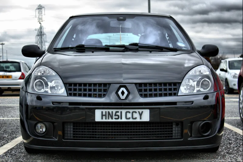

I have 4 inch ducting, fits right over the the fog light surround on the PH1 so its quite stealthy.
I'm gonna stick some black mesh over the front of it to stop it sucking up s**t!

^^ Never understood why people dont do that if they have a PH1. Its such a good mod and the inlets are high enough up from the road to suck in cooler air.
So many on here with PH1's run them all the way up from the fog which is just stupid IMO.

I'll certainly use Dave's method on this car as i did on my last, same benefit and inconspicuous.
yeah!! someone who agrees with me at last
fog light for an intake is a pants idea on any car, its too low
