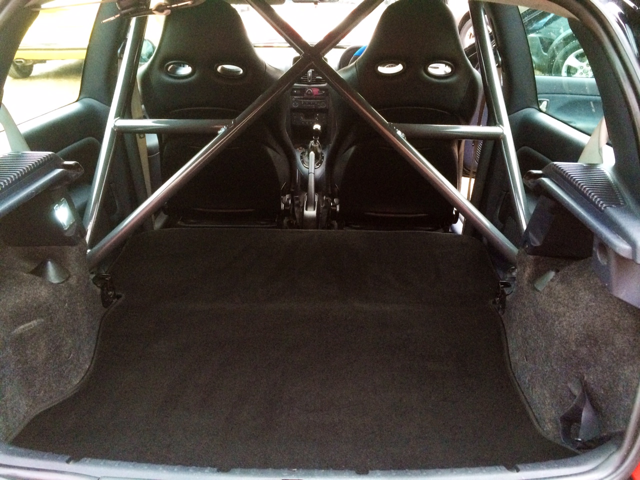

Happy with my rear cage in my daily!

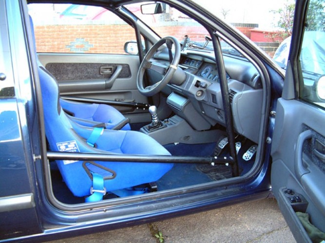

I have a feeling the diagonal that slopes down from the dash would be the most annoying part of the cage if I was using it as a daily driver. You can't just swing your legs in and out.

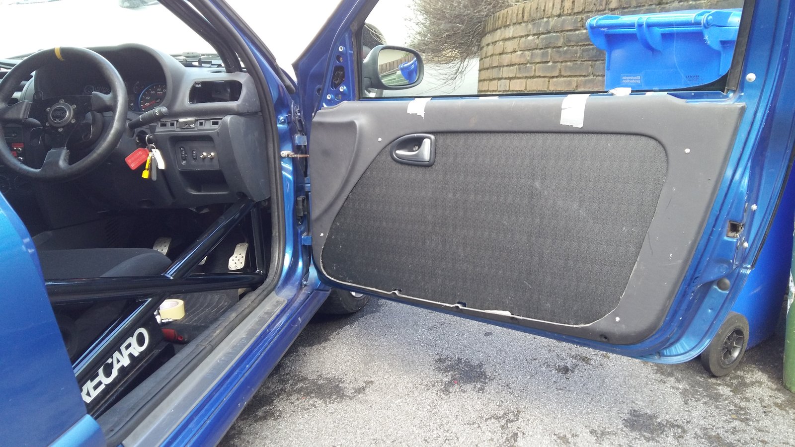

Definitely, so just buy a cage without it, just a single door bar:
If you get a non- dash dodger then the front leg will also be further forward out of the way.
