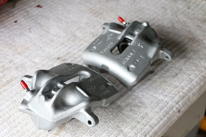

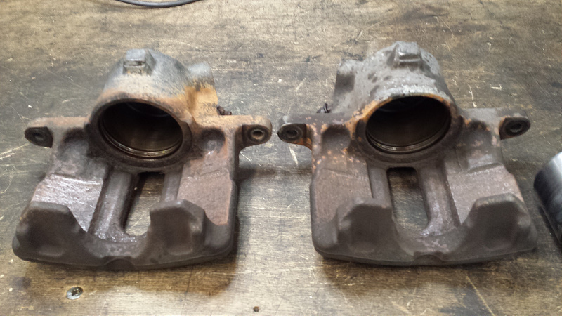

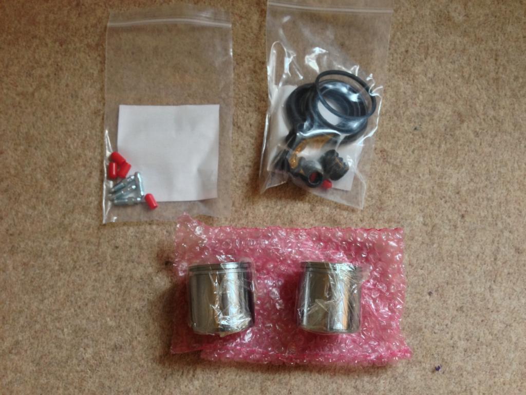

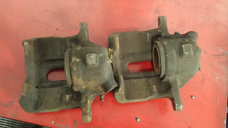

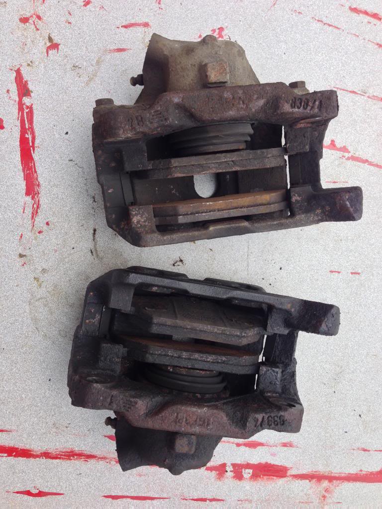

Stripped, cleaned, painted and fitted with new seals and pistons.
From this
Untitled by scottieraven, on Flickr

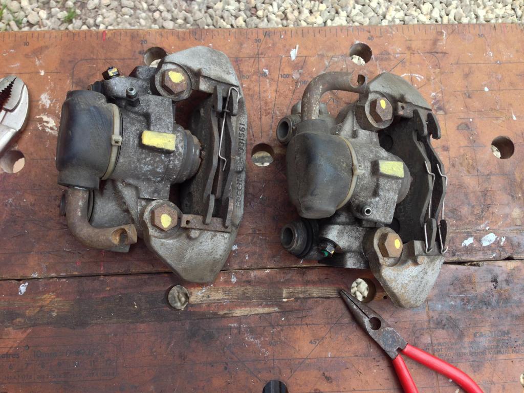

To this

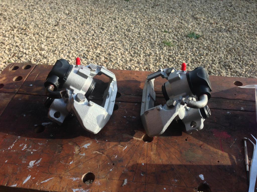

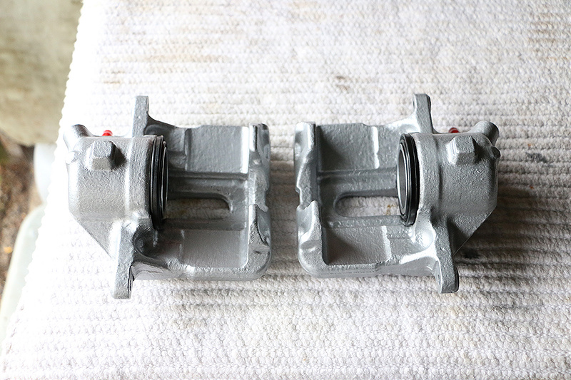

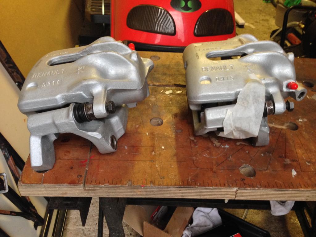

Then cleaned with a wire brush, 2 coats of paint then rebuilt.
005 by scottieraven, on Flickr
012 by scottieraven, on Flickr

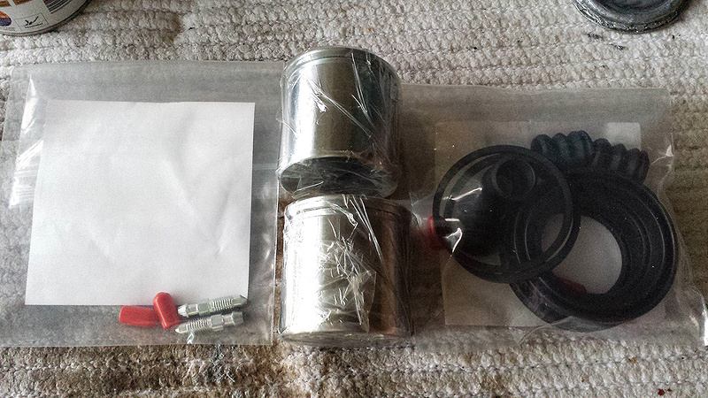

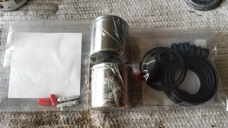

BiggRed kits are great if you fancy having a go yourself. They seem to get very positive reviews for their in house refurbs too. They're certainly very good with customer service based on my dealings with them. If I wanted some rebuilt (by someone else), then they are who I would go to.
