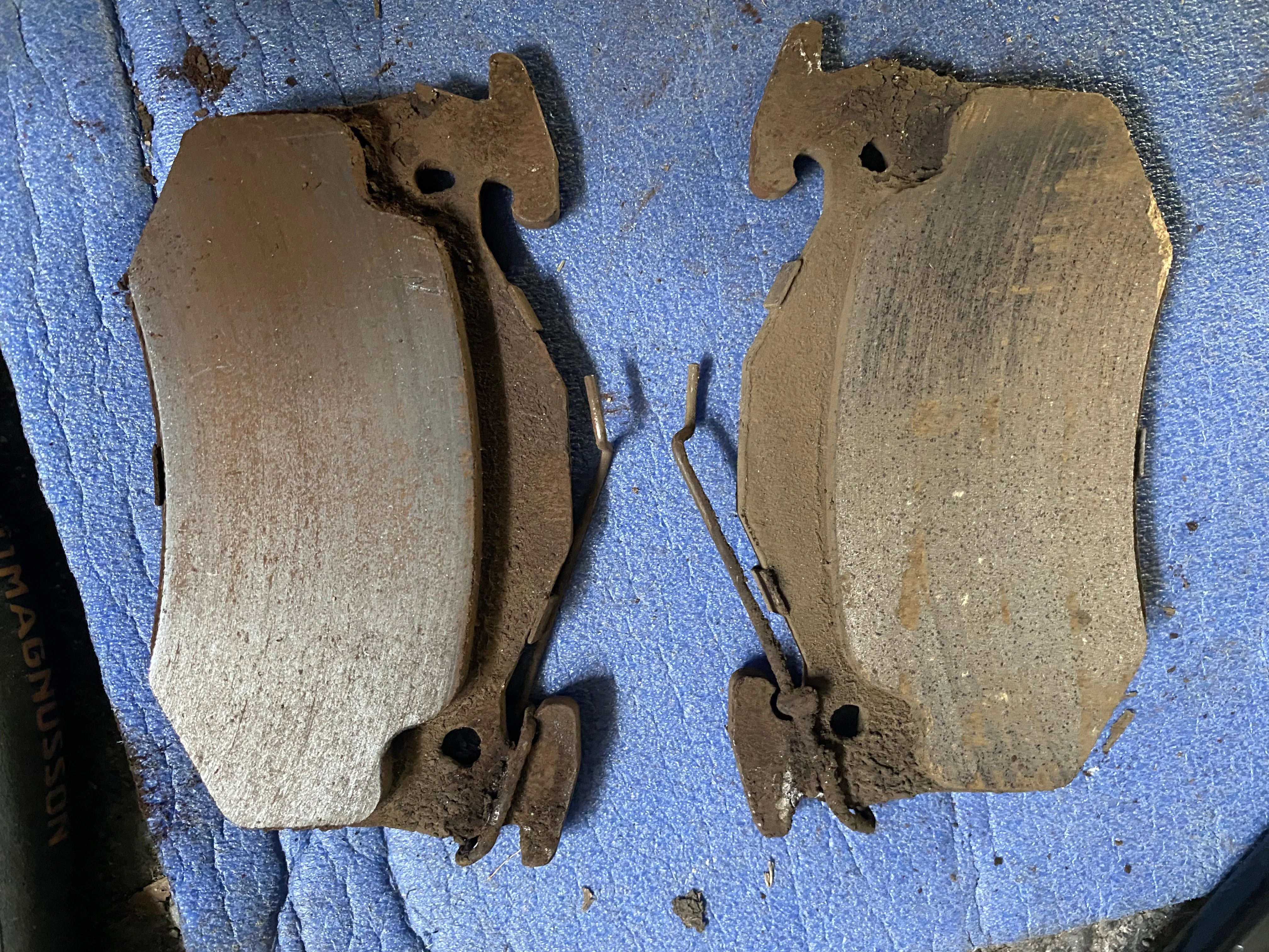

Nothing appears to be loose until I take the pads out. Is this amount of play in the caliper normal?
  • IMG_8461.mov
    18.2 MB
Okay, excuse the ignorance but how do I get grease in without taking everything apart?
I’m going to clean up the back of the pads and the locking slider bar and just make sure that everything has a little bit of copper slip on the back. I’ve just moved the caliper about and it does make a slight knocking sound which is similar to what I’ve been hearing. Don’t laugh if this was the cause of the problem and I’ve just been replacing two dampers that were okay. The bonus is I have two new dampers! :ROFLMAO: Every day is a school day.

With everything reassembled and the handbrake off it’s fairly easy to move the pad carrier with your fingers through the wheel and get it to make a knocking sound. When I tried on the opposite side of the car, it was really difficult to make any kind of noise and even then it was very slight. As Louis has said, it seems likely that the slider needs packing with some new grease to reduce the movement. I’m guessing that the other side probably wants the same treatment also, but I have no noise from that side at all. I have now checked absolutely everything at the rear of the car for movement and this carrier is the only thing that has some free playing in it. So, I’m convinced I’ve found the noise from the rear of the car. I will fit the new damper in the next couple of days myself as it’s a fairly straightforward job and it will be having some new springs fitted, but not by me, at some point in the near future. I need to buy a breaker bar to undo the slider bolts as they were extremely tight and I didn’t have anything apart from my foot and a makeshift bar to undo them. Not ideal! Rubber grease is added to the shopping list 👍
