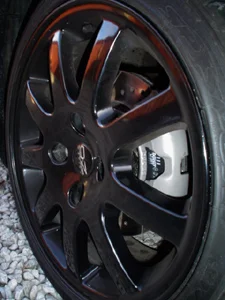

On my old black saxo vtr i used hamerite gun metal gray, give it a few coats, best if you take the calipers off, then spray with a good quality transparent spray - forgot the name of it now :dapprove:
they look'd mint and subtle to the core lol :cool:
