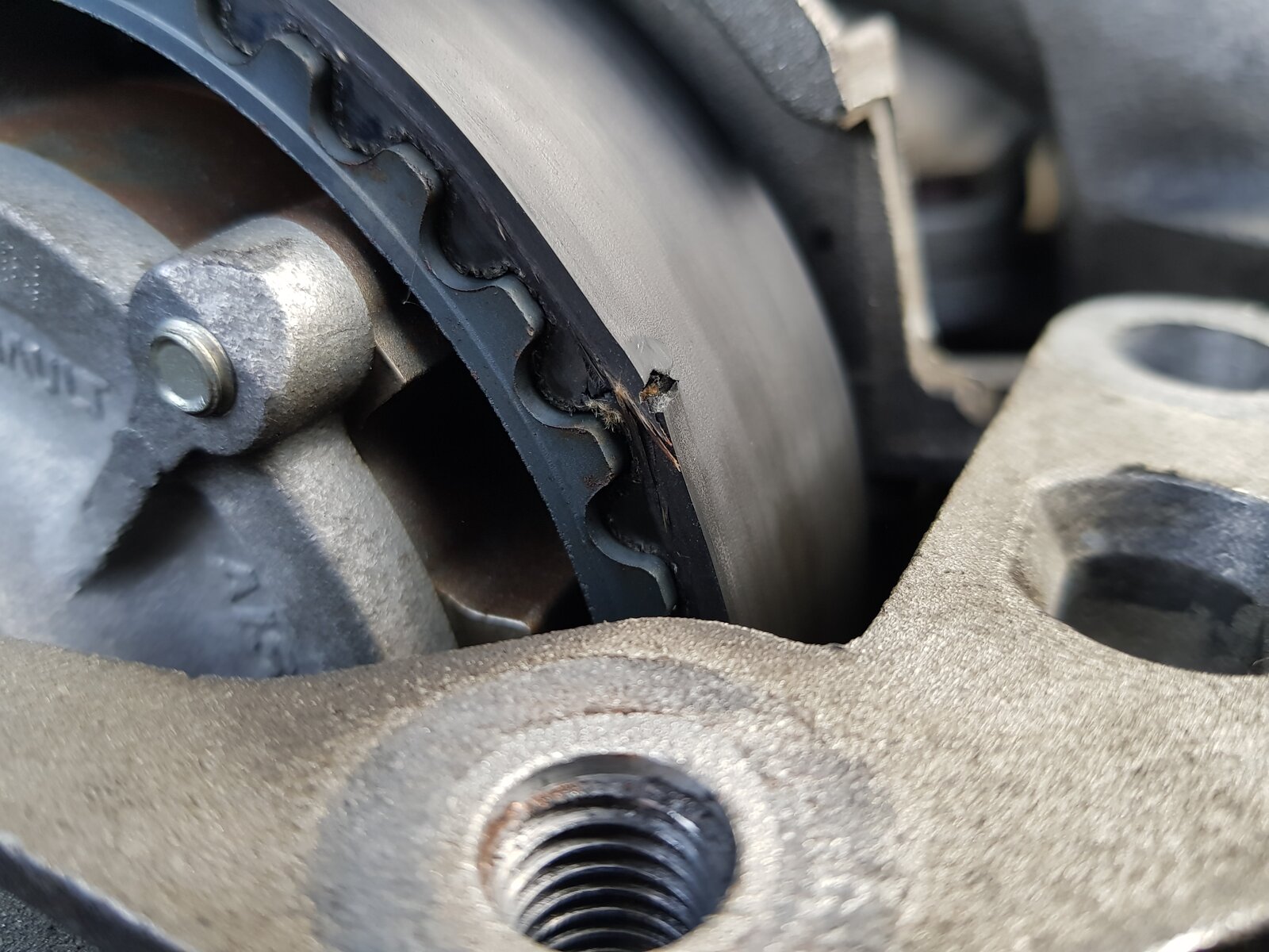

Check out the picture, any ideas what's caused that!? Noticed it while changing the upper engine mount...

Looks like somebody has put the wrong length bolt in and then replaced it for the correct bolt, don't ask how I know :cool:
Interesting. Wont ask how you know ;) But, what bolt could this have been?

To be honest, it was on a 197, I picked up the wrong engine mount to cylinder head bolt and wound it in.
It was a 10mm bolt going into a 12mm hole, but as the mount and cylinder head weren't aligned, and it felt like it was going in.
As soon as it touched the belt, it wouldn't screw in any more and I thought I'd stripped the aluminium, but I'd nipped the belt exactly the same as the picture.
Cost me a new belt and a couple of hours labour.
Morale of the story is, don't change a cam belt after work in the dark!
