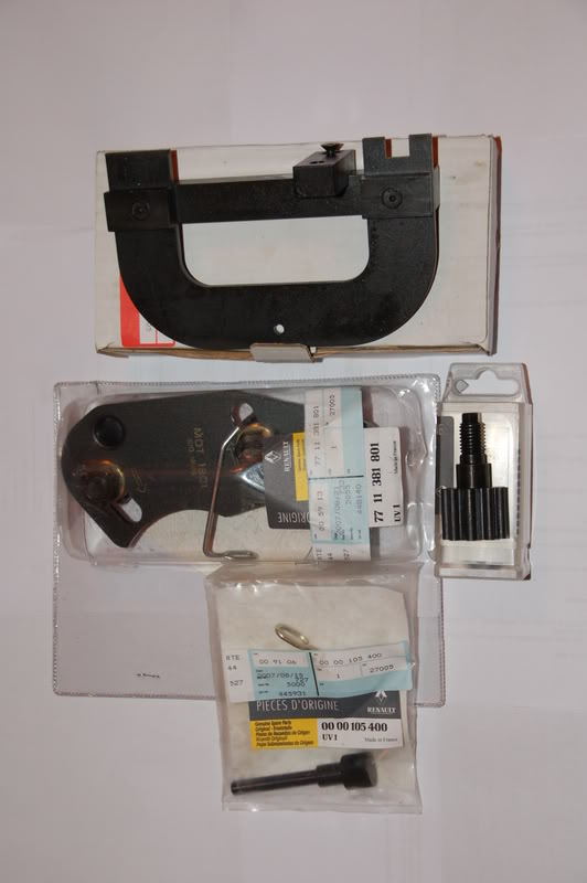

"you need 2 cam locking tools for the cambelt and the crank pin" also a Aux pulley to do the belt.
There is a particular tool you need to do it, and Renault don't even supply them.

you need the cam locking tools (available from renault)
pulley locking tool
cam locking tool
crank pin
plus aux tool (make one as the offical one is crap)
^ These:
