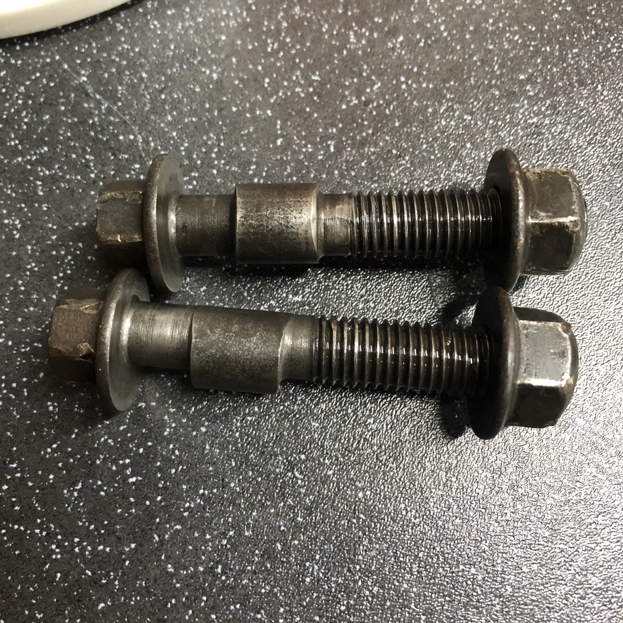

Camber Bolts. These ok?
Car  RS 172
Hi guys. Found that I had these, but missing the washer. They still ok to use?
Not ideal, but they can be used if the bolts are tightened right up otherwise they can slip. Where as with the tabbed washer there's no where for it to slip to because the tab inside fills the gap.
Thanks guys, annoyingly i bought them two years ago and opened the packet tonight. I'll just order new ones. they are 20 quid.
