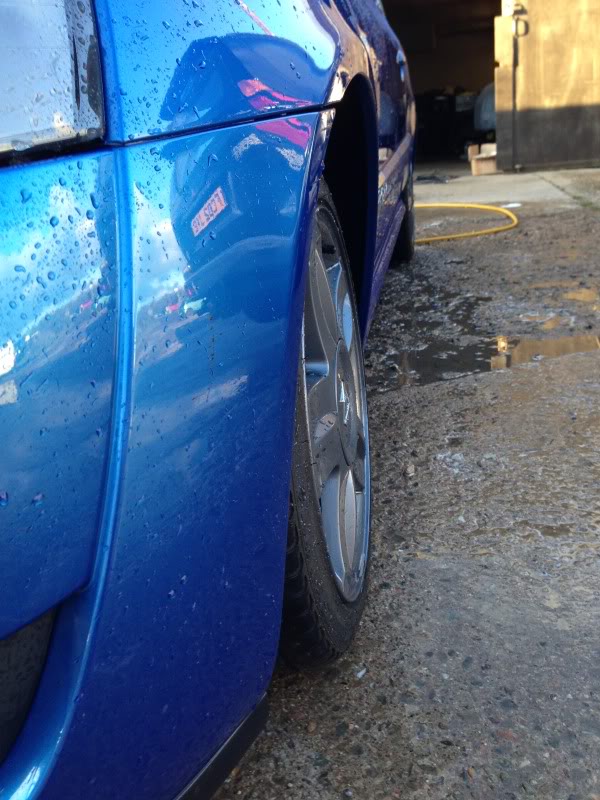

Hello All,
new coilovers and top mounts and wheels fitted time to start thinking about geometry..
want your advice on front and rear camber please
what do you or would you run?

I will be getting some RSR's soon and wondering what camber to run (mainly track use) but needs to be driven to tracks but don't want the tyres to wear too quickly on inside edges.
what is the max camber that you can get with camber bolts?
Rsr's just work better with more camber, I've seen people say they get 5deg with camber bolts but some say only about 3
I'm running Bilstein B14's with Eibach camber bolts and I'm at the limit with -2.5deg.

Max on camber bolts varies, so cant answer that for your specific car.
The RSR on the clios seem to really work the outside edge, so you need loads of camber to stop that.
172 cup. I have had nearly 5 degrees both sides on my car with the camber bolts in the top hole.
Being lower tends to give you more camber too, as it straightens the wishbone out which pushes the wheel outwards.
And I still used to wear the outsides of RS-R's with sportlines fitted.
