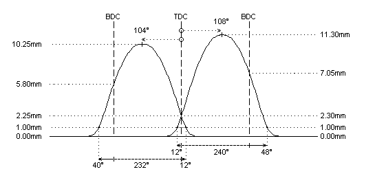

Im looking to eek a bit more power out of the old girl, im looking at cams and was thinking of the quite aggressive catcams (5502423), uprated valve springs and 197 injectors.
Does that seem reasonable as a setup? I know NA gains are never massive but it seems like that will give me the extra I would like at the moment.
