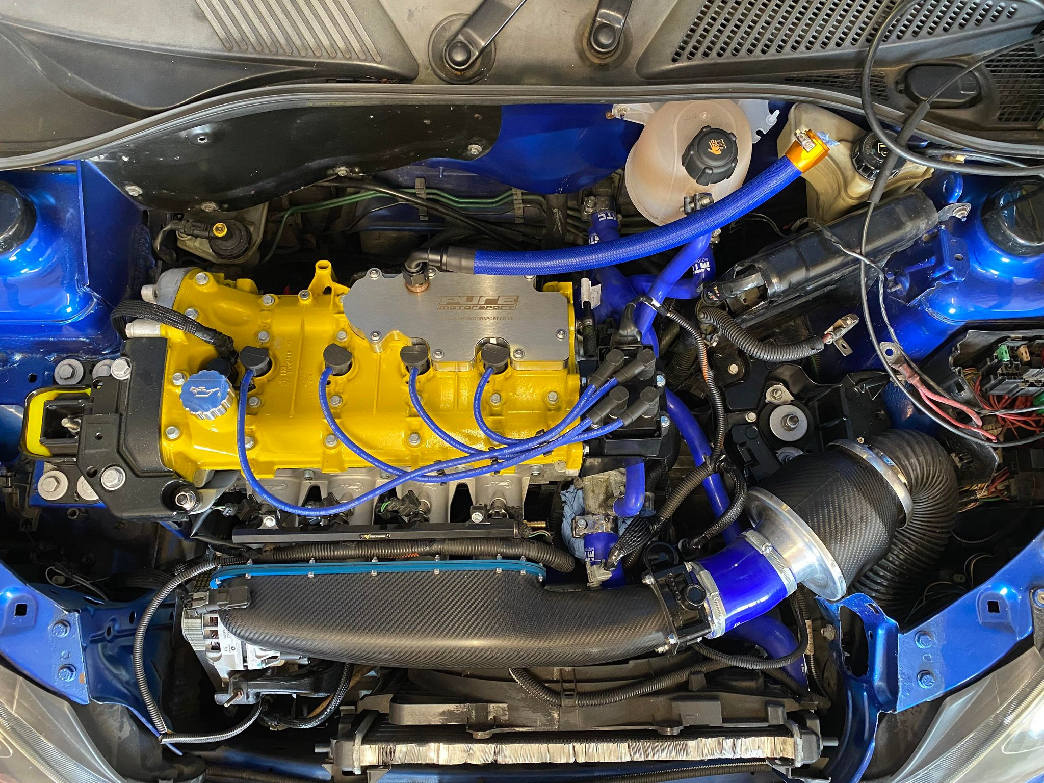

I'm currently working on my 172 Cup build with the aim to acheive as close to 200bhp as i can. I've spent the past few months tidying up my engine bay and installing an RS2 intake, I've had 197 cams put in when I had the cambelt done and I'm at the point now where I'm about to sort all the fueling side of things.
I find that I'm going through a bit of a minefield trying to find the right approach with the fueling with differing opinons and advice coming in from all over the place, I've spoken to multiple companies, tuning places and people running the same intake and trying to get the same sort of power. Apologies to anyone I've already spoken to, I mean no disrespect to your advice, but I'm just trying to get my set up right before I take the car off to be mapped.
Originally I was going to go with 197 injectors and get the car mapped and see what the outcome was, job done however...
I've been told now that stock injectors will be fine for 200bhp and they're capable of 208bhp (it was my understanding they'd be running flat out at that power which isnt ideal) hence 197 injectors being the choice).
I've also been told that running the stock injectors with an upgraded fuel pump and return line would be more than enough for 200bhp and I must upgrade the pump to up the bhp.
After digging around I've found multiple people saying that the stock pump is capable of over 230bhp and its the injectors that are the limit here, you see the dilemma...
So now my thoughts are do I just upgrade the injectors and the pump, fit a regulator and a return line, but I feel like im readying the car for a boosted build which just seems exessive, is there any downside to going all out with the fueling side of things?
I'm just afer the general consenus here, anyone with experience of NA builds, RS2 intakes, etc any input or advice would be greatly appreicated.
Cheers!
