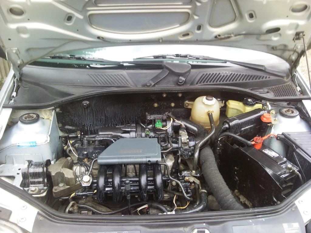

can any1 tell me what this is?
liv
  1999 mk2 clio
my oil light n stop light is on at all times and i have had the oil pressure tested ( passed the pressure test ) and the oil pressure switch has been replaced replaced but lights still. i think it might have something to do with the tiny black box to the left oil the oil cap on top of the engine. can any1 tell me what it is and what is its purpose? thanx
tried to upload a photo of it but dont no how
l
1999 mk2 clio rn 1.2
liv
  1999 mk2 clio
the black thing im talking about has a beige wire going to it
liv
  1999 mk2 clio
the car is driving perfect just the light stays on. no not milk its cleaner i sprayed on it just hadnt wiped it of yet when i took the pic. just wonderin if the black thing could be the problem as mine is broken

anyone unsure of what the black thing is im meaning i have uploaded it as my profile picture and have an arrow as to what im meaning. thank you any help appreciated

Going on what I know from my time on 106s...it looks like an interference blocker. The 1.1 106 has something similar and it simply prevents electronic interference from window wipers and stuff messing with the radio signal. That will have nothing to do with you oil light I don't think.

you see its not actually a removable part the black thing is part of the engine wireing loom and is bolted to the engine beside the oil cap. theres an number on it witch is 7700876108 is that helps i tried google it to see if it was a part number but couldntt find anything
  Clio 172
It's 100% a suppressor, it's just there to neutralise the electrical noise that the coils produce. Without this gizmo, you'd probably find you got an engine speed related whine through the radio.
It may be designed to earth through its mounting point. Then again, it may just normally be bolted down to stop it flapping about. If you're not getting the aforementioned whine through the radio, then I'd be inclined to just leave it alone.
