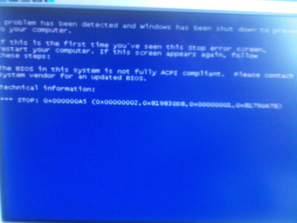

Blue screen says something like The bios in this system is not fully ACPI compliant.
Im guessing it needs to be updated?

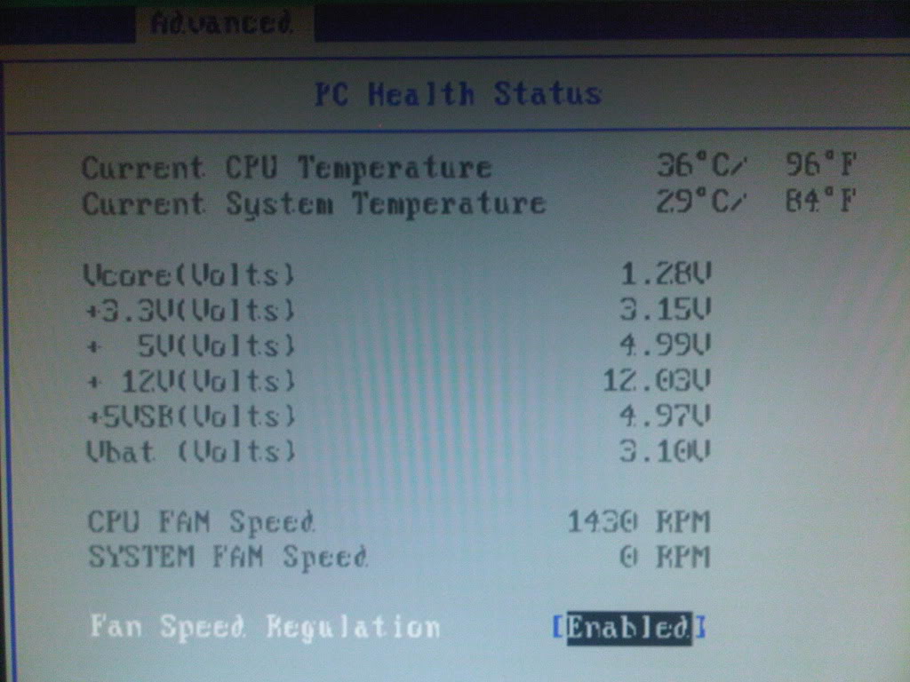

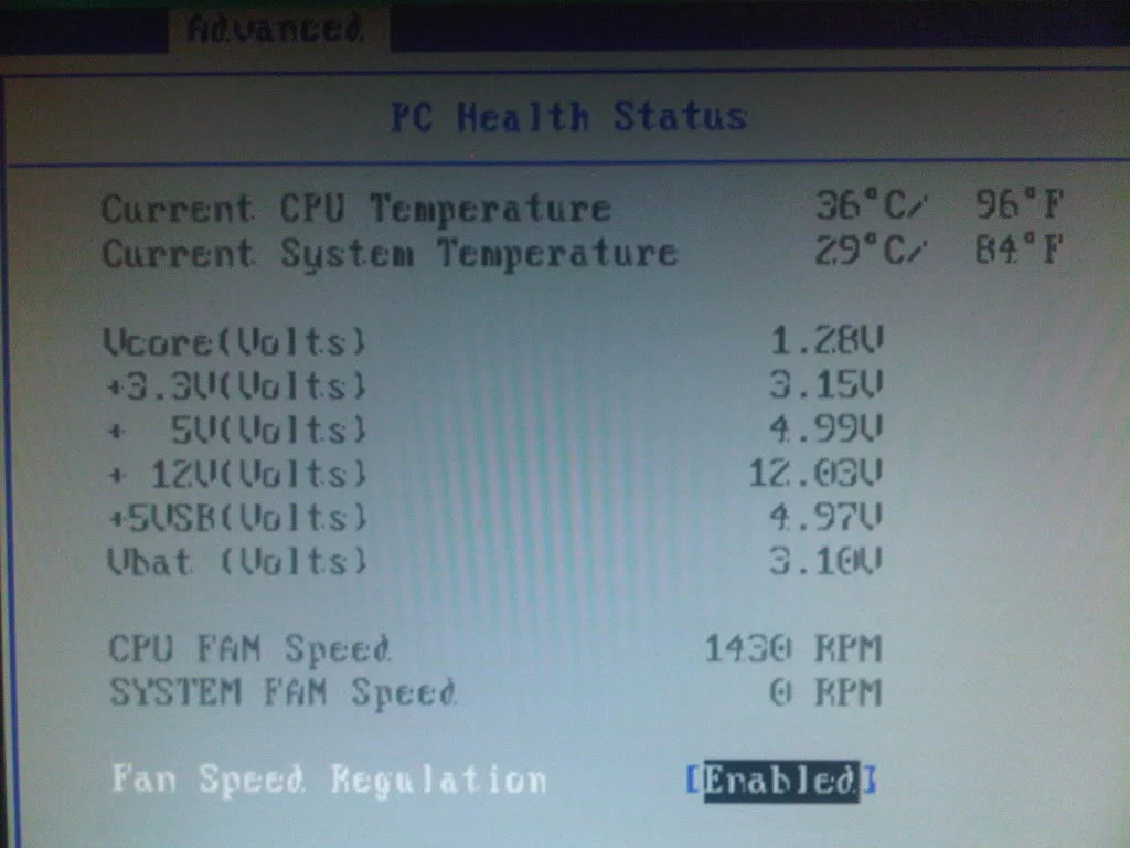

Could be psu not providing enough power , then when a particular device starts it gets unstable and restarts.. check the voltages / temps
Could be a dodgy gfx slot
  Clio 1.2 Extreme 4
They can be checked in the bios, am I right? If so ill check them.
Ill also upload a pic of the blue screen.
  Clio 1.2 Extreme 4
Blue screen:

Usually can see the temps / volts in there . Not always reliable though as can be fine until a blip then its restated
  clio
All looks ok... Have you still git the original drive you removed first time ? Id put that back in to see what happens

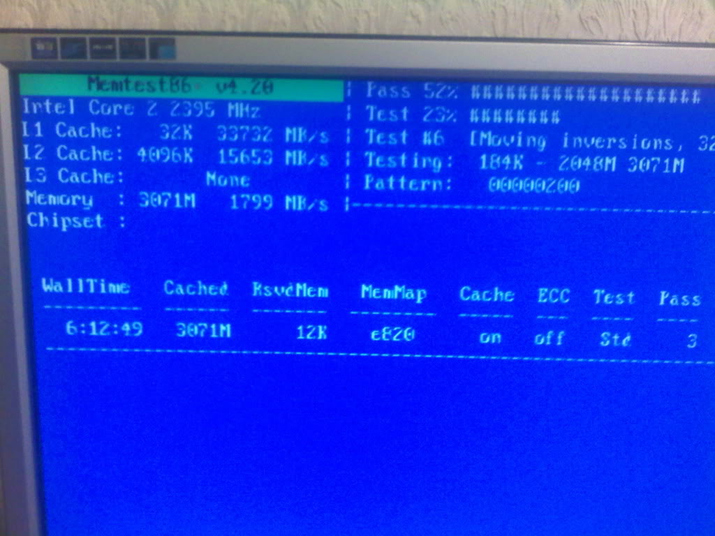

Going to do the mem test now, do i just download the usb installer and thats it?
I did that plugged in the usb and at boot it says no bootable device found? :/
Update: My pc doesnt seem to like booting up from usb?
Just burned it to a disk and its now running, will post results when its done, thanks for all the help so far.
  Clio 1.2 Extreme 4
Its been going for 4 hours 15 mins and doesnt look like its going to stop any time soon?
It shows pass 2 and errors 0.
When does it finish/stop?
  Clio 1.2 Extreme 4
Well i let it run for 6 hours, and the result is above, it said 0 errors 3 passes.
What do you suggest i try next im lost as what to do?
