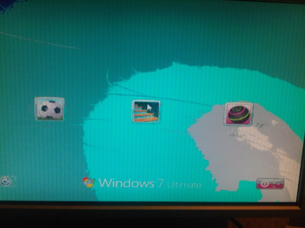

My pc recentlty started looking like this, is my graphics card dead?
Ive tried uninstalling and installing the latest drivers but no luck :/
Any help will be appreciated.

Looks more like a software issue initially - especially on the Shut Down icon on the lower right corner - almost like its running in 8-bit colour?

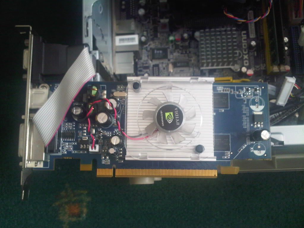

The fan looks clean - is that a new addition? Does it spin freely to the touch and also spin fine with the PC on?

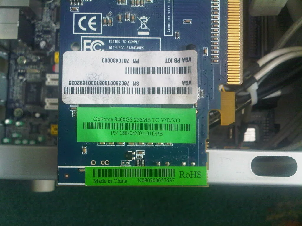

You've got both a DVI and VGA port on the rear of the card. Have you got a screen/monitor that you can try both connections with?

I think i saw somewhere it said it was running at 16-colour.
The fan is standard, although it did have alot of dust on it before i gave it a clean to try and make it work but it didnt, there was alot of dust around the fan bit, that may have ruined the card?
VGA gives the same result on a different monitor, i dont have anything to connect it to through DVI.

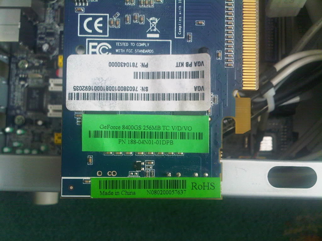

Iv tried the drivers, i think it must be the graphics card is ruined?

A friend looked at mine then and confirmed the graphics card was pooped, as it's 4 years old just gonna pick up a cheapie
Would say the card is dead. Looks like you have some artefacts on screen as well as the 16 colours being forced.

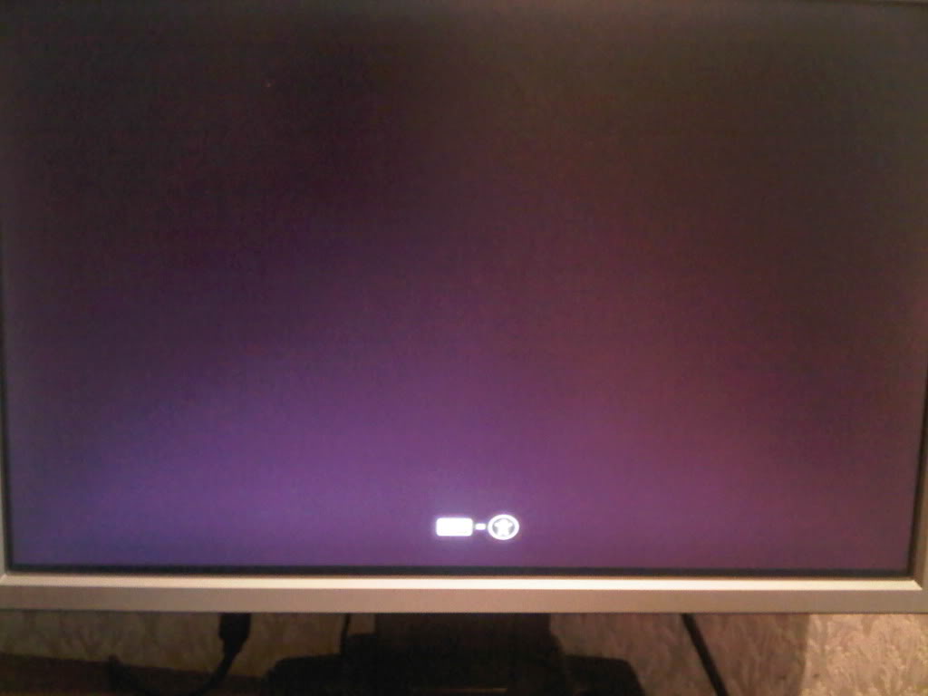

Tried booting of usb, computer keeps saying removable device not found!
So tried booting of cd and now its stuck at this:

I thought the lines down the display picture were artefacts, however it is too uniform. Never seen it do lines like that when set to 16 colours. Still though windows should still load a default simple driver that can display true colour at lower resolutions upon initial install.

Have you tried pulling the card out, blowing down the socket, then properly re-seating it? I'm pretty certain this isn't a hardware issue since you said Ubuntu worked fine.
Tried this, gave it a vacuum aswel to get rid of the dust.

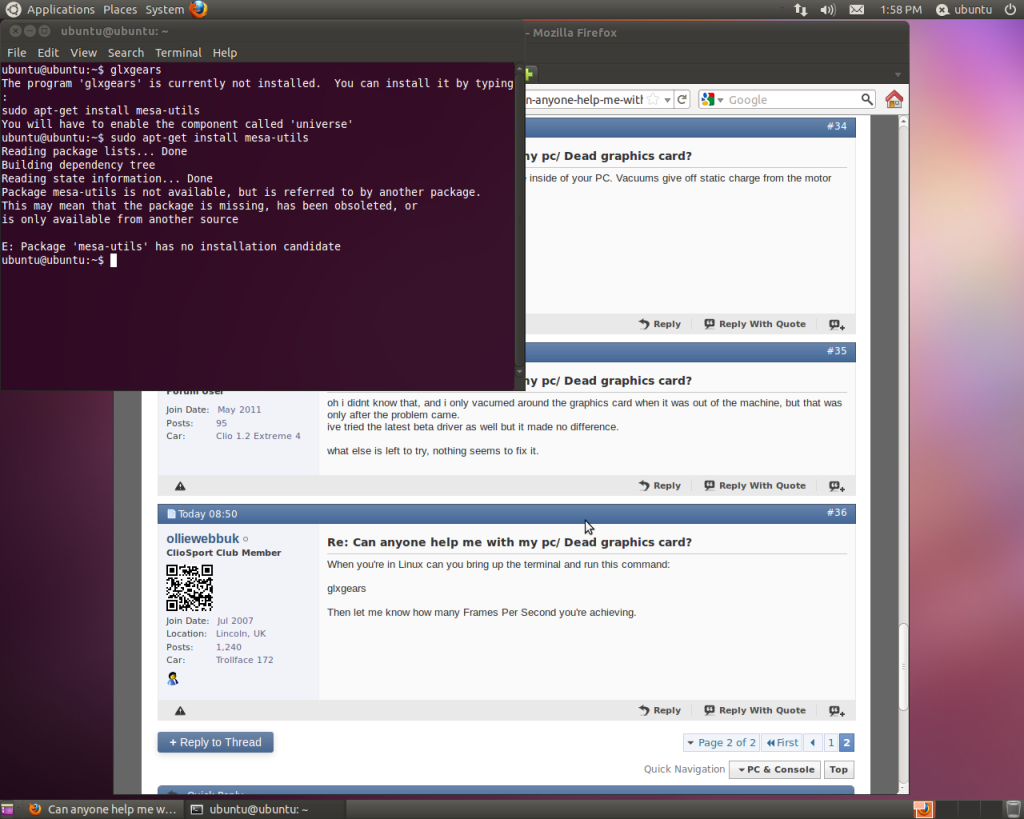

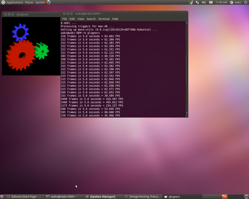

When you're in Linux can you bring up the terminal and run this command:
glxgears
Then let me know how many Frames Per Second you're achieving.
