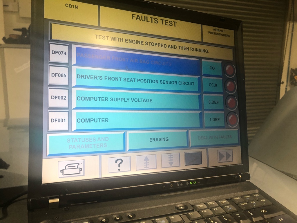

However it seems to be very crash happy and slow to operate, now it’s running on the oldest IBM thinkpad I’ve ever seen, I’ve just bought it to clear the airbag faults. I’m getting my head round the system and for some reason it’s just not clearing my faults, when you rescan the faults are no longer there but yeah,

No, just trying to clear for now, I’ve had this car storage and now it’s got an airbag fault, and when I tested the system I got the below if you can relate

You can't clear the faults without repairing the problem, it'll just come back.
You either need to sort the issue with the wiring or reprogram the airbag system to tell it it doesn't have certain things.

I told the system it no longer has the two circuit systems (as you can reverse it) but obviously you can’t tell a computer it’s not got a computer if that makes sense
I watched this video and obviously he has different errors to me, but the process should be the same
Originally when you turned the ignition on the airbag and service light didn’t go out, then I reprogrammed the system and cleared the faults, cycled the ignition and the the lights now go off and then come back on after 5 seconds,

If you have told the system that it's no longer there you need to then unplug the wiring, otherwise it's basically seeing a foreign object that shouldn't be there and bring the lights back on.

Well tbh with you I thought this might be the case,
On the video he has a fault return and it’s basically because someone has “bodged” it and put a resistor in, however he mentioned unplugging somewhere,
Anyway, il unplug the seats tomorrow and reset the system again and see if I get any more progress!
