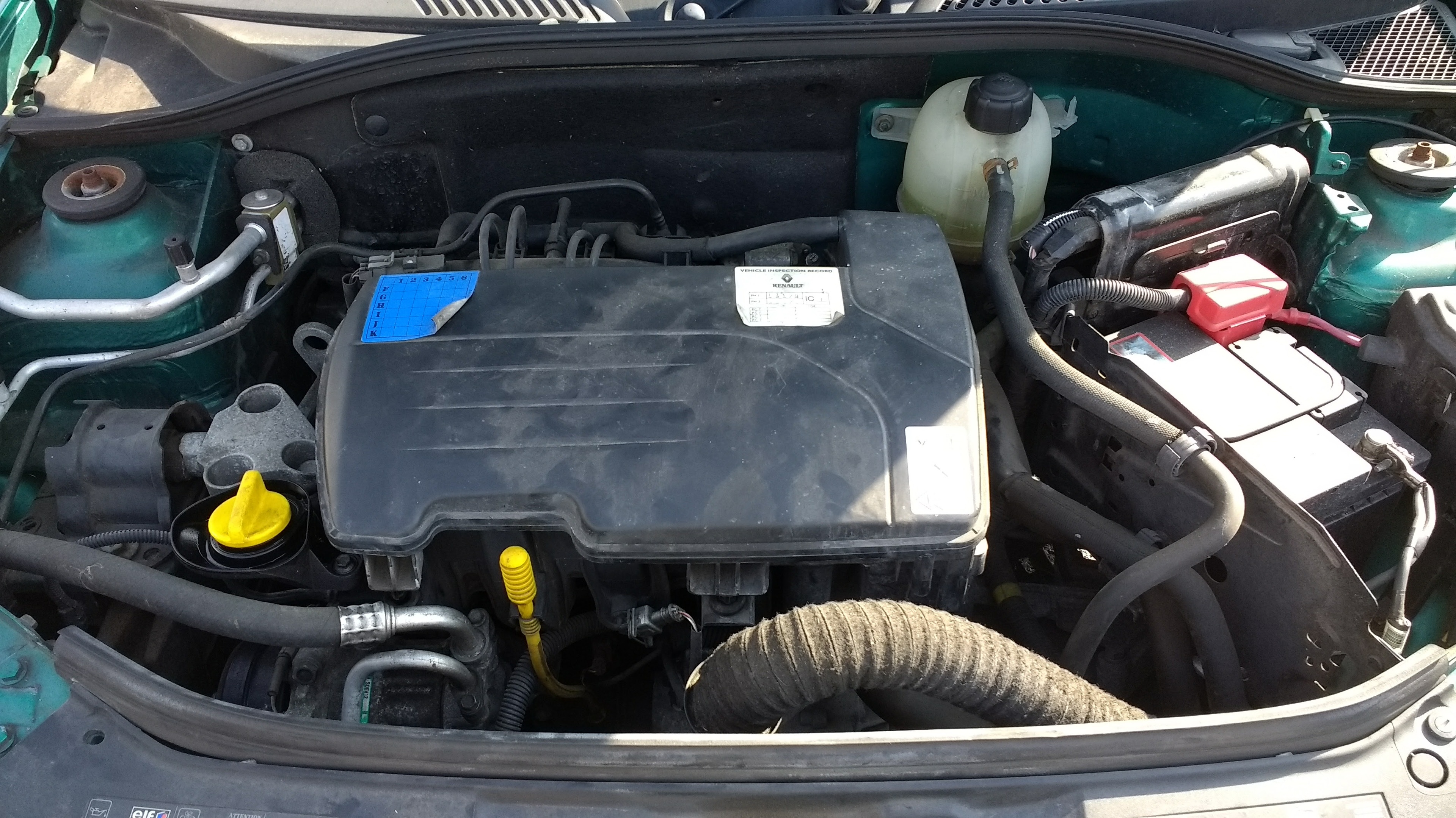

I was intending to do a proper removal and clean as the car is frequently idling roughly and losing power, but my engine looks nothing like any internet guide or my Haynes and after hours of reading everything I'm so confused as to what is permissible without going that far.
Luckily, access in situ is trivial. Here's what it looks like.

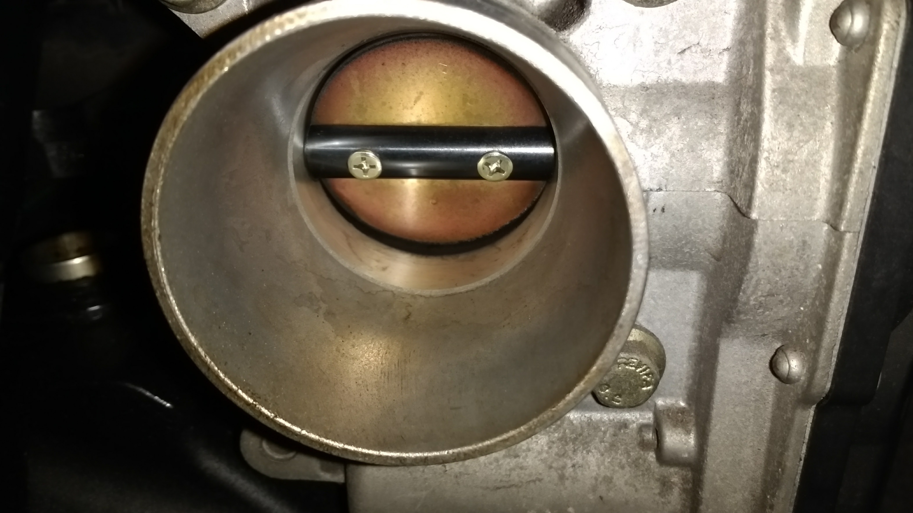

I have some Wynnes Air Intake & Carb Cleaner. I've read that I can't touch the butterfly, so how do I do it? And also read that I shouldn't clean it at all because it's not controlled by wire and I might damage the balance.
Would somebody mind a very straightward idiot's explanation? Can I just spray it in round the edges, let it dry for a short while, idle the engine, do the little timing reset jobbie and see if it worked?

Does you engine have the airbox on top of it ?
Hey, thanks for replying, appreciate it.
The airbox is part of the engine cover, comes off with it. I had a look inside the airbox while I was there, seemed clean.
Throttle body is just behind the white sticker, pull the cover off and there it is.
You could clean it in place yeah, just makes it more difficult for the sake of 4 bolts holding it on.
The throttle body removal spiel in Haynes is *long*, only being 4 bolts in this engine hadn't occurred to me.
I'll see if it comes off easy, thanks.
Indeed it was, thank you so much! Amazing what a sentence or two of help will do.

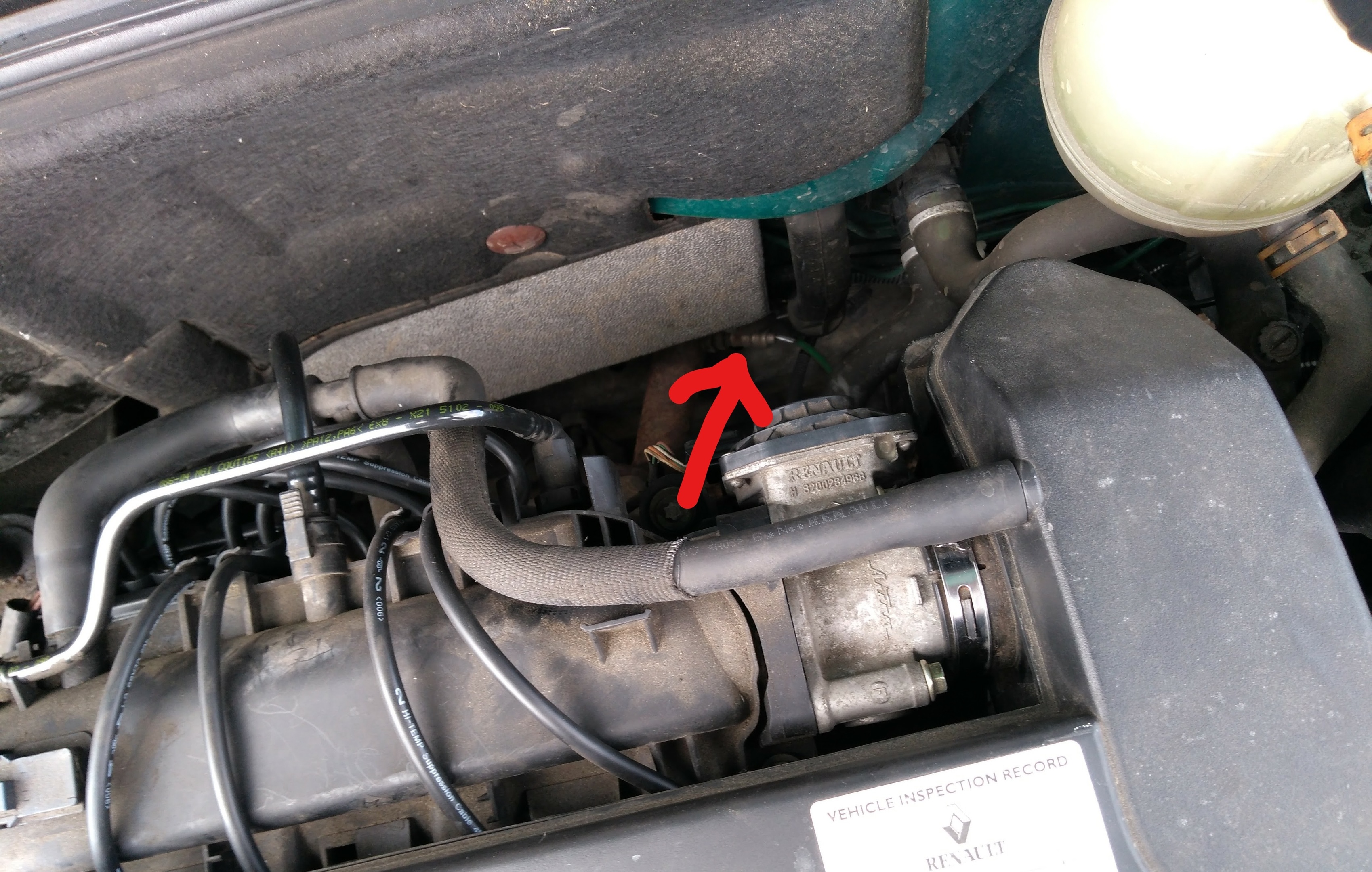

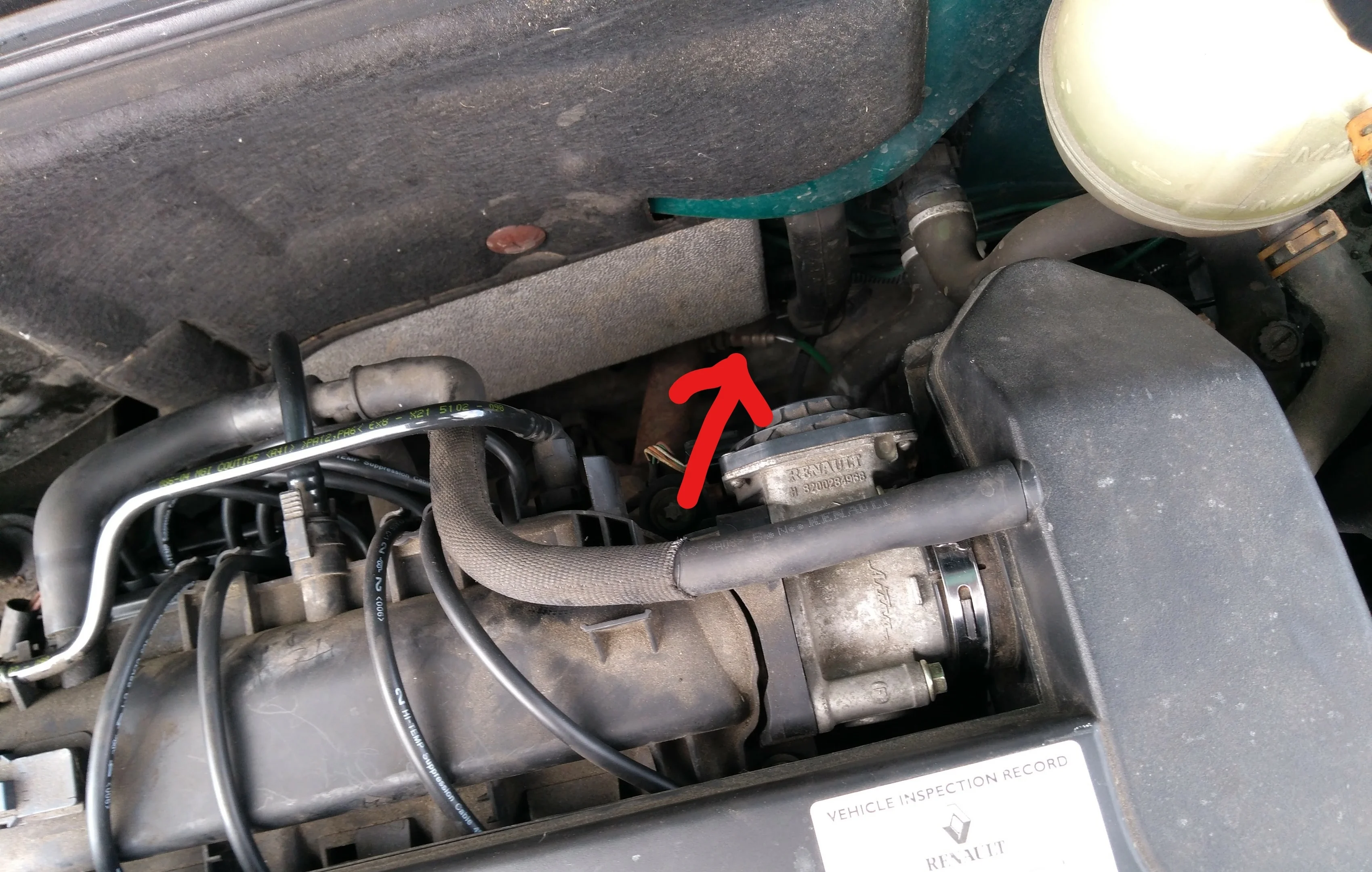

Cause of the symptoms turned out to be a bad pre-cat lambda.
Since I didn't find any clear information about the location, I've attached a photo. On my Clio Mk2 Dynamiuqe, you lean right over the engine, it's at the back near the bottom of the car. Can change it without having to jack the car.
