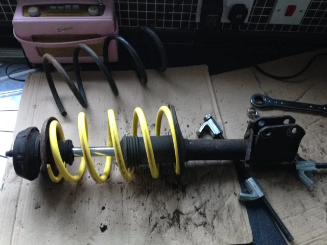

Hi - just in the middle of changing over my standard springs to 40mm lower springs, all was going so well.
Started with the fronts, and got the shock absorber out, took the old spring off, got the new spring on and buttoned the shock absorber back up.
Trouble is now that i can not for the life of me get the shock absorber back in place.
Ive been trying for around 2 hours and now thinking to myself surely something must be wrong (unless im just crap)
It just seems like it is tool long, ive managed to get the top end through the gap and but the nut on at the top (under the bonnet)
But the bottom end will not swing into place to line up with the bolt holes at all, i must have tried a hundred scenarios to get it to line up but hitting a brick wall.
I compressed the springs really well before putting the shock absorber back together, and unless im missing something it seems fine and solid, and put back together correctly.
Has anybody ever experienced this before? And if so how did you overcome the problem. Or if i am just being a spanner, is there a specific way to get it back in that i have not come across?
Not that it would help but here is a pic of my put back together shock absorber (excuse the pink radio)
Also, not sure if this would ever change, but from head to toe it measures 60 inches.
Could it be that the actual shock absorber has extended when the old spring came out and is not compressing again? i dunno just a thought.

Have you got both sides jacked up?
The anti roll bar will be holding the lower arm up, you'll need to get someone to put some weight on the arm so you can get a bolt in.

As above, you pillock, you need the front end completely off the ground to save the ARB from pushing the side you're working on up.
  330i. E30 Touring.
Get someone to put a bar on the wishbone and put a foot on it. Hub will lever down and you can slot one of the bolts in.
  172 Ph1/Scooby MY00
To be fair, the first time I did this I had only one side jacked up supported on an axle stand. It took me nine hours of fighting the force of the anti roll bar to get the two bolts in and my arms were pumped! I should of done my research - see the Fubar series of guides in the Guides section.
You have to jack it up off the ground both sides at the front and support it on axle stands. It is still quite difficult working on your own to get the two bolts back in, I find it easier to try to put the top bolt of the two in first and use a large screw driver in the lower one (also remember to put the bolts through the right way - the nuts go on the rear side, and check you haven't damaged the CV boot). Are you doing the rear springs? If you are the same approach applies, jack it up both sides and use axle stands on the rear sills, also remove the sock absorber base bolt. Also, you need a torque wrench to tighten up the two nuts to 180 nm.

Just want to say thank you everybody - i finally got it back in. Had to jack up the other side as menioned above, was still a ball ache trying to get it in on my own, so had to get the stepson ready with a bolt as i put weight on the hub to lower it and line up with the bolt hole.
