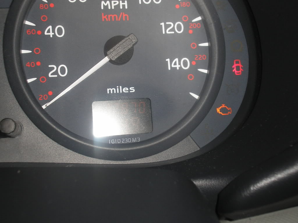

Could someone confirm that this light i have on is the engine managment light, been searching through threads and have heard that the engine management light has a line through it?

I believe it is, its the same light I had come on the other day, turned out the spark plugs were shot. Is the car running ok?

yeh running perfectly normal, is it ok to drive with the light on? Is yours turned off now its sorted, and was yours running fine?

Yeh thats the engine management fault light, probably just a lambda sensor fault. Could be shot cat or shot sensor, or it'll go away on its own after a few starts.

started it up many times since it came on, took it out for 2 drives and its still on. Going to give garage a ring tomorrow see when they can fit me in. The thing is when driving im worried its going to die on me.

In the Clio 3 its called the toxic fume filter warning light which means theres something dicky with the emissions. Could be either the coil pack starting to give out or the lambda sensor. Either way shes throwing a code so get her plugged in asap. You will probably notice an increase in fuel consumed too :dapprove:

Went into the garage today for a dynostic check. Came back with the faults "Cat effiency below requirements" and "02 sensor bank 1 sensor 2", so it means a possible missfire or air leak or mass airflow meter. Light is off a the mo.

Means the cats shot most likely. Sensor 2 is the post cat sensor that checks the cats operation and its showing that its fecked, get the emissions checked i'd guess they'll be off.

its not an engine management light, its to do with emissions and possibly issues with the cat or cat sensor.Had my 182 in for an mot and had the same light come up on the dash - there was a major air leak where my cat pipe meets with my exhaust.removed the exhaust clamp refitted new bolts and sealed the joint up with exhaust paste.
originally it was an mot fail due to the exhaust leak which threw the lambda reading out - after having the exhaust resealed the light does not come on anymore.

Hi mate, well when mine went in the garage last time it came up with some kind of air leak and emmisions, anyway they managed to get the light off. after this i took it to the same place for an MOT and it passed first time. its just came on again today, runs perfectly fine etc just like it did last time it was on.

My Lambda reading was very high (1.08 i think) originally worried it maybe the cat but my dads friend is a mobile mechanic and spotted the leak straight away from the joint at the exhaust / cat and everything was tightened up and sealed which sorted the issue.hopefully your fault can be rectified without replacing the cat.

The light appeared a couple of months before my mot and yes the car did run fine.I noticed the emissions light came on intermittently when crawling in traffic but went off when driving at higher speeds - i originally put this down to having a yozzasport system fitted, but later found out that the air leak was causing a high emissions reading which was why the light was coming on.

It IS an engine management fault light I assure you whatever the manual says, its the standard obd2 fault warning light its just renault want to throw their own in there too. It'll come on for things other than cat faults, its come on now as theres a fault with the engine management.
Either the cat or the post cat lambda probe is rodgered, perfectly safe to drive and if its the sensor thats gone it'd still pass an mot etc. Just needs testing to see if its the sensor or the cat.

It comes on when it detects high or abdnormal emissions. I had a Megane in the other day with a broken cam sensor, as it was missing and over-fueling, it threw the emissions light on. You have a llambda code but as said its the downbank llambda so I'd be inclined to get another cat and have the fault cleared.
It IS a management light though as everything that goes through the exhaust is burned by the engine so if there is a fault in fueling or ignition, it'll generally cause poor running and mixture issues which brings the light on.

It comes on for other faults as well usually conbined with the efwl, as a general rule if thats on as well any cheapy generic obd reader can read the fault as well as the more complex stuff.

been into the garage today, came back with the oxygen sensors need replacing, told them i would call them if i wanted the work done. Got back into my car and the light has gone out again.

Jordi the light in your pic is basically the "something, somwhere is wrong" light. It can be anything from brake sensors, emissions you name it.
When the garage took the readouts of the codes they would have no doubt cleared it but as its already come back twice now its obviously faulty. Id get it sorted otherwise if something else goes wrong you wont notice it due to the light already being on! :p
