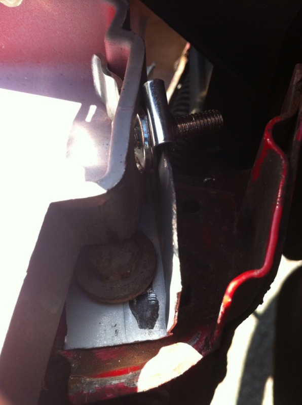

The front brackets which hold the bumper on (ph1 172): Does anyone know if you can buy these?. Also are they common place on all ph1 Clio's or just exclusive to 172's ?

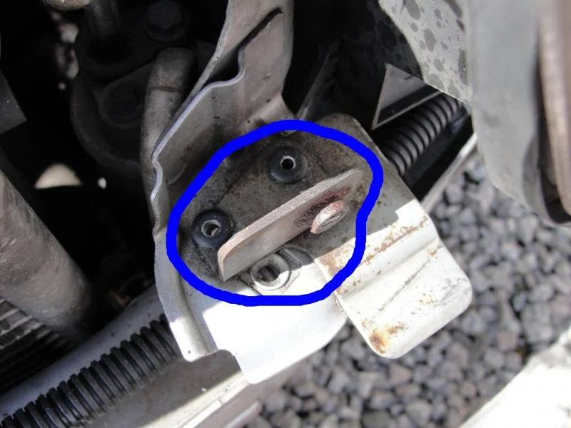

Haven't got a clue if you can buy one to be honest , but my guess would be no . Imagine if they sold every little bracket , nut , bolt etc ..... they'd need a big storage facility . The bracket you've circled looks like it's just popped riveted on to me .You could probably knock one up out of a bit of aluminium .

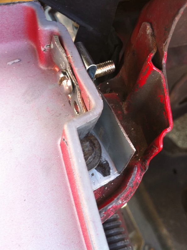

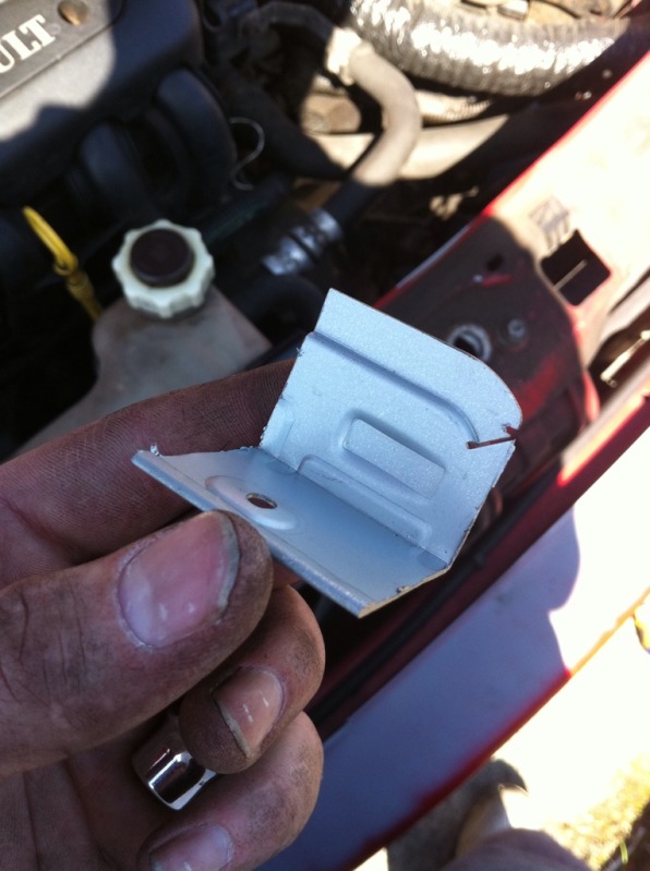

Yeah its just riveted on. The bracket is fine its just the bolt has snapped inside it on the passenger side and the drivers side someone has drilled it out totally and fastened it by a nut at the rear (a bit pikey).
New bracket would be the easiest option.
Don't suppose anyone knows if this bracket is the same set up for all Clio's? I know there are a few non sports down the local breakers
I would imagine that they all have the same brackets , thats my guess anyway . I can't really see Renault making different brackets for different models , to keep the cost down . You could have a look at the nonsports i suppose , but maybe they were drilled out on yours because they'd rusted in ? It's possible the nonsports you'd look at , they'll be rusted in those too . Failing that , make your own , they're not exactly complicated in design looking at that pic .
I thought the same but Haynes says the bumper is held on by screws at the front. Searched on here and it appears the base models don't have the bracket riveted on as per below pic. Maybe just depends on the bumper configuration.

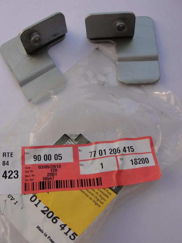

Went to Renault and luckily they do sell these brackets so ordered them. 14 odd quid a pop for the pair but at least its hassle free and factory

Andy if you wouldnt mind posting the part number when you get them, I need 2X as both mine are broke from some previous mechanic thats over tightened them.
Apologies for the late response.
Fitted these today with a Halfords rivet gun kit. One issue i had was the rivets in the Halfords kit were not clamping down one side of the brackets, rivets were too short. Not sure if this is down to me being a newbie with a pop rivet gun lol or if Renault used slightly longer rivets. Ended up riveting one hole per bracket and just bolted down the other.
