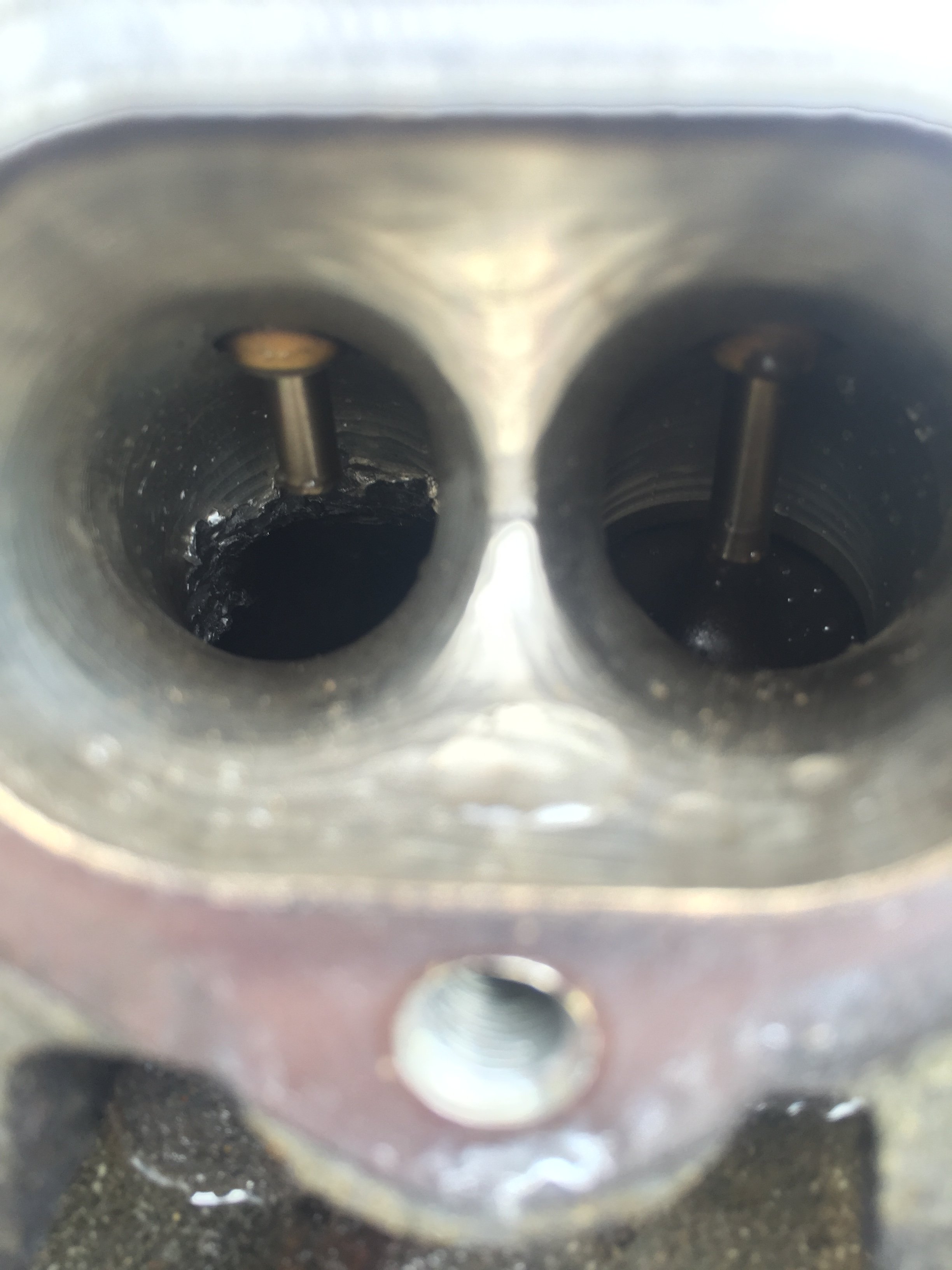

Was considering ripping the head of but haven't got round to it yet, but yeah, like you said, probably down to who ever done the work. Here's a photo of one of the valves
Ah, it's dropped a valve.
On that basis, my assumption would be the dephaser isn't the culprit, and would be alright to re-use.
