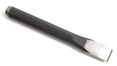

Need a chisel like this
  2014 Clio 200t edc
Are they known as cold chisels? I'll pick one up tomorrow and see what mess I can make of it with that! Lol
Fingers crossed I'll get the bolt out once the discs out of the way.
Knuckles
ClioSport Admin
Yup, cold chisel.

Well got myself a cold chisel, small one, had a go and all it was doing was eating the bolt. No movement at all no matter how I hit it, or how many times I moved the chisel and tried different angles. Gutted!!
Is my only option now to drill it? Carbide drill bit?
  2014 Clio 200t edc
Just ordered a blow torch too so I'll give some heat a try when that arrives. There's little left, I wondered whether to keep going and remove the head that way but thought better of it. Lol
