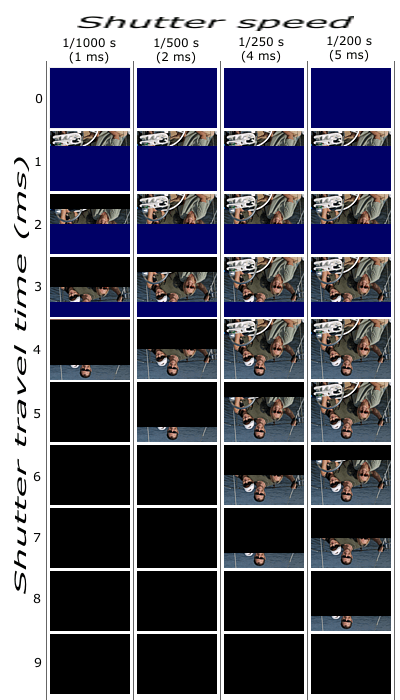

I would say you're using a shutter speed higher than your maximum sync speed, but looking at the exif data the last photo was taken at 1/60th so that's not the case. It would appear that there's some sort of mis-timing with the flash perhaps?
What external flash are you using and are you using wireless triggers or anything like that?

Whatever it is you're definitely getting two exposures, ambient and flash. I'd say the flash is firing at the wrong time. Also, if you can't figure it out try resetting to factory defaults.
